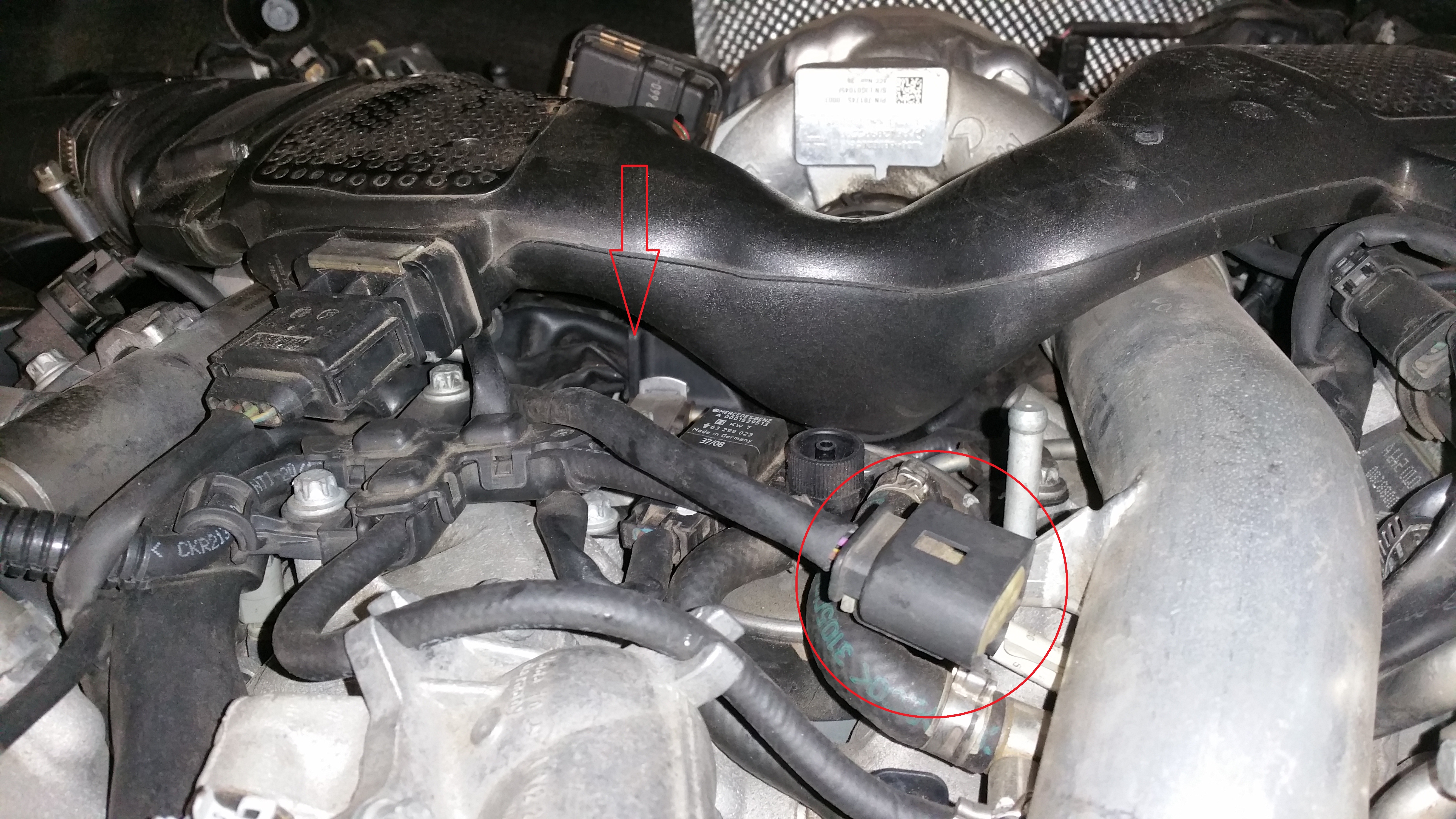

I had my GL320 in a local shop to replace the driver door lock actuator. A day after we got it back, it threw a code. I'm going now to grab a code reader so that I can see what the code is.
However, in the meantime, I just completed an oil change and noticed this connector which is located in the "V" right by the fuel filter and is not connected to anything. I do not see a matching male connector near by without a mate. Could this have inadvertently gotten disconnected during the service and be causing my code?
Please let me know if you know what the connector is below, where it is supposed to go, or if for some unknown reason it is not supposed to be connected to anything. The connector is circled in red and the wiring is coming from a bundle pointed out with a red arrow beneath the air supply ducts and in front of the turbo.
Thanks in advance!
Nick

i have the same one on my 09 not connected and was going to ask that question but you beat me to it
guess its normal
Steve

Steve, I think you are right. I found out my code is glow plugs. So now iit looks like when I do my fuel filter next week, I will be doing glow plugs as well.
