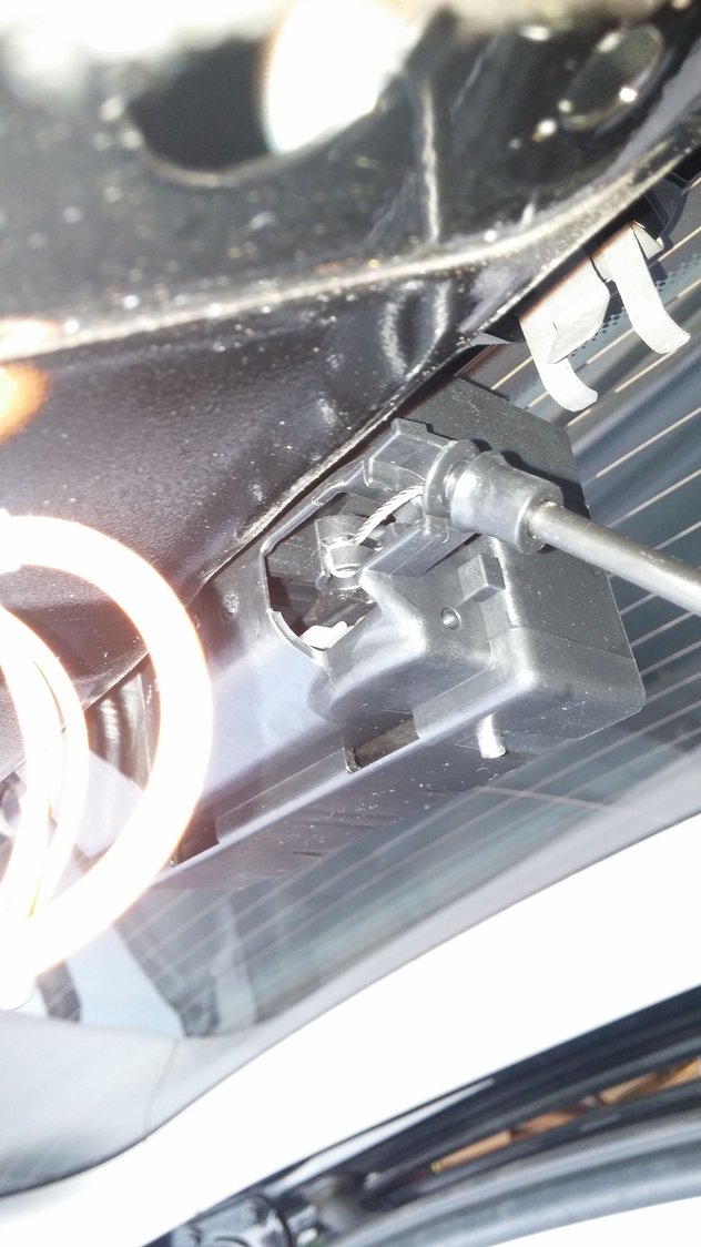

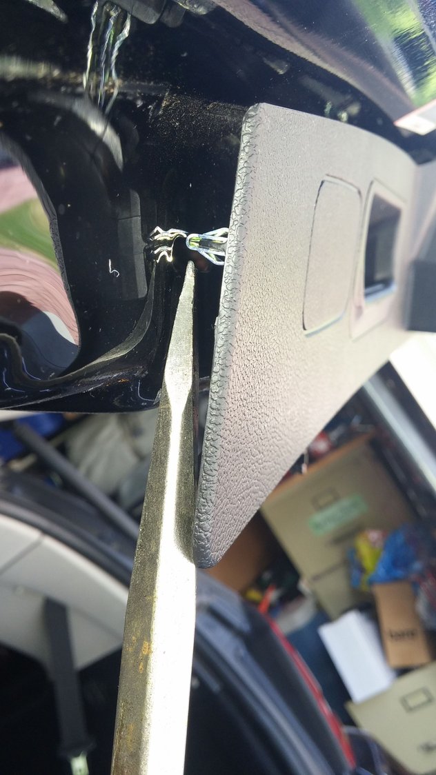

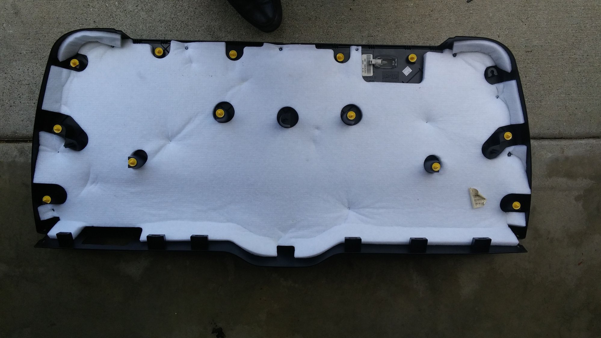

2010 X164 had some grinding noises for about a month when I opened the rear hatch. Dread came over knowing I had to replace it soon. Well, it came at an inopportune moment when I was going home after loading stuff from Home Depot. It wouldn't lock, so I bungee corded the door shut. Taking apart the panels was simple popping off friction tabs and the back panel took a large flat head popping the yellow tabs carefully.

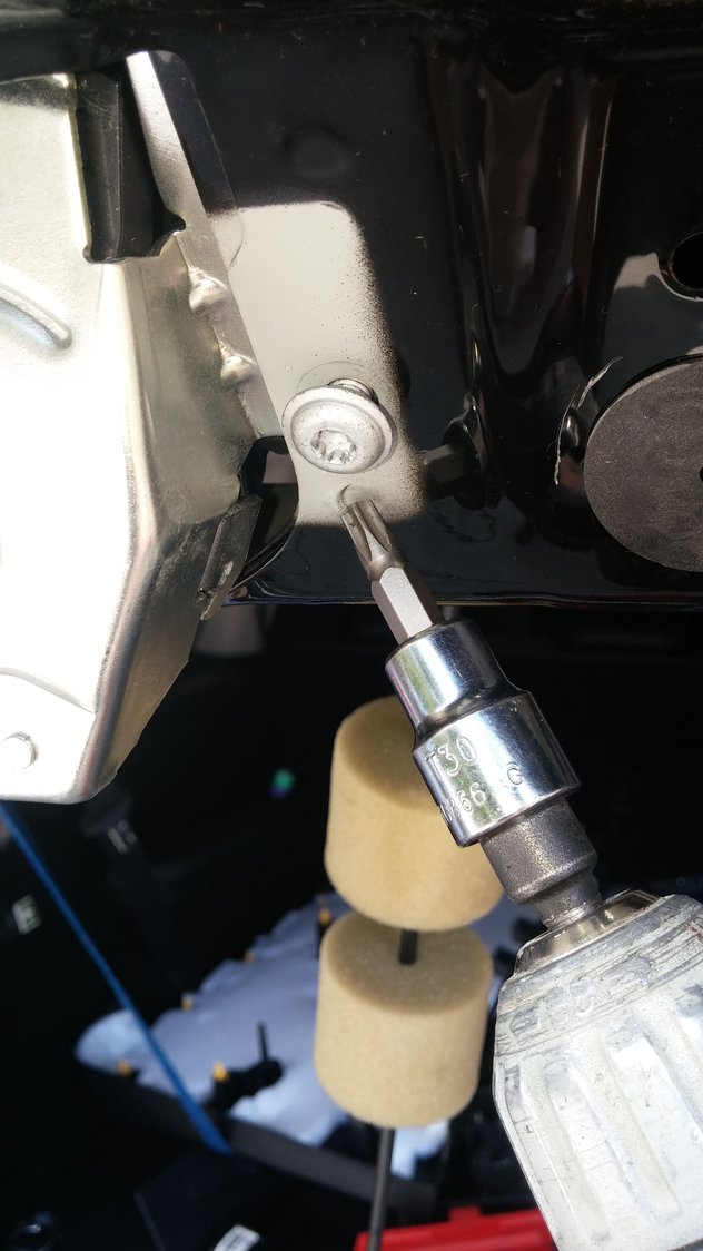

The lock was removed after removing 3 T-30 torx socket screws
Disconnect the emergency release cable.
Then push the lock mechanism backwards through the rectangular opening.
Install is the reverse.

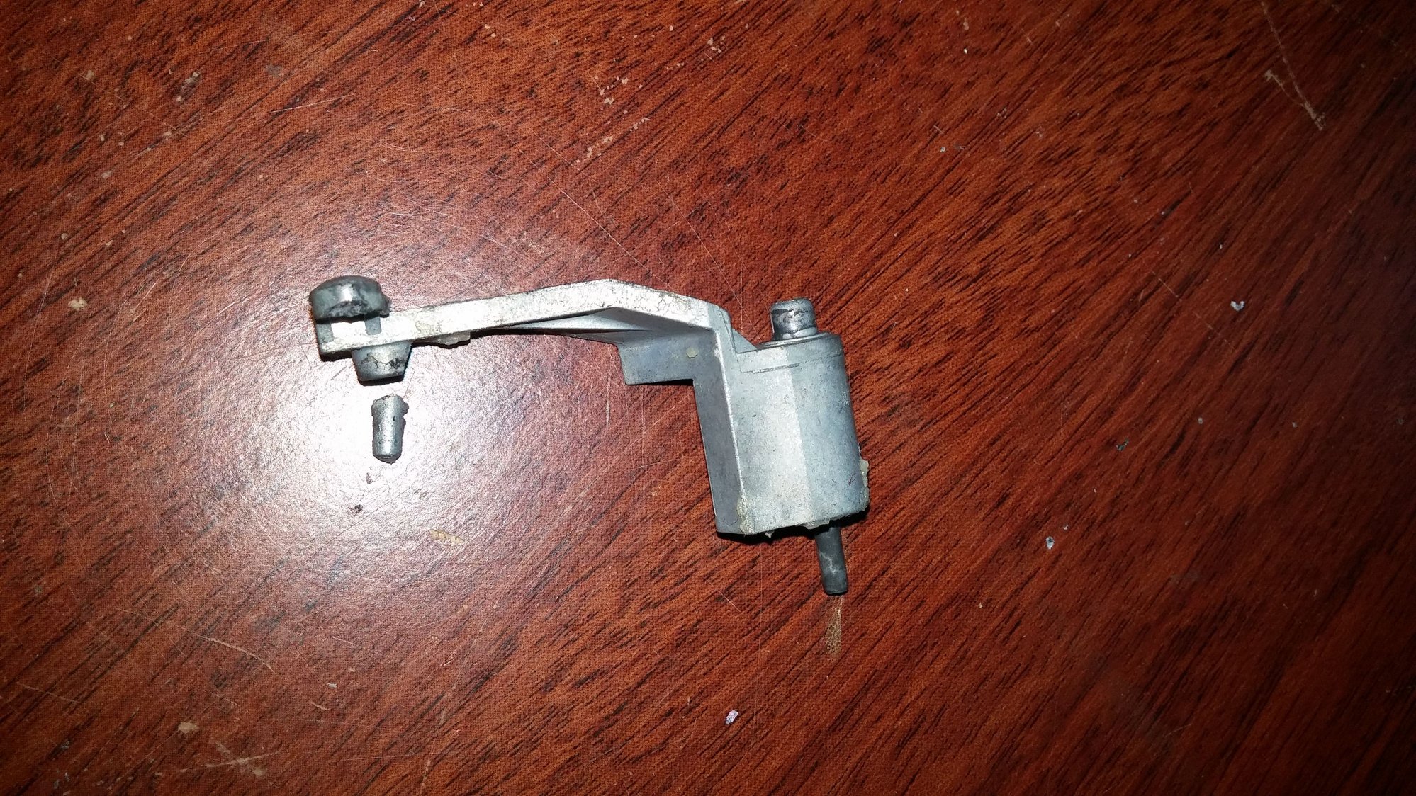

Popped of the cover and found a broken pin.
$248 for a new mechanism MB p/n A 164 740 07 35
