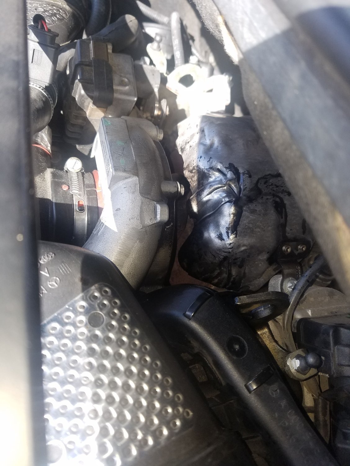

Gl320, oil showing on top of turbo shield??
Yes, oil on top of turbo shield, I wipe
it and in 2 days it reappears. Black plastic harness has some too, not sure where it is coming for., see picture. Thx!!

I think it may be coming from the turbo charge pipe, where it connects to the turbo. I ordered a new 13$ oring, will change tonight and we will see. lets hope that was it!

Ok, mystery solved, o ring was missing from where the charge pipe connects to turbo
I must have dropped it last time when I took off the pipe

yes, when one of the two seals (orange) fail or are mis-positioned a misting will occur and puddle at the strangest places. if you have unexplained oil puddling anywhere on top of motor - first thing to check are those seals.
