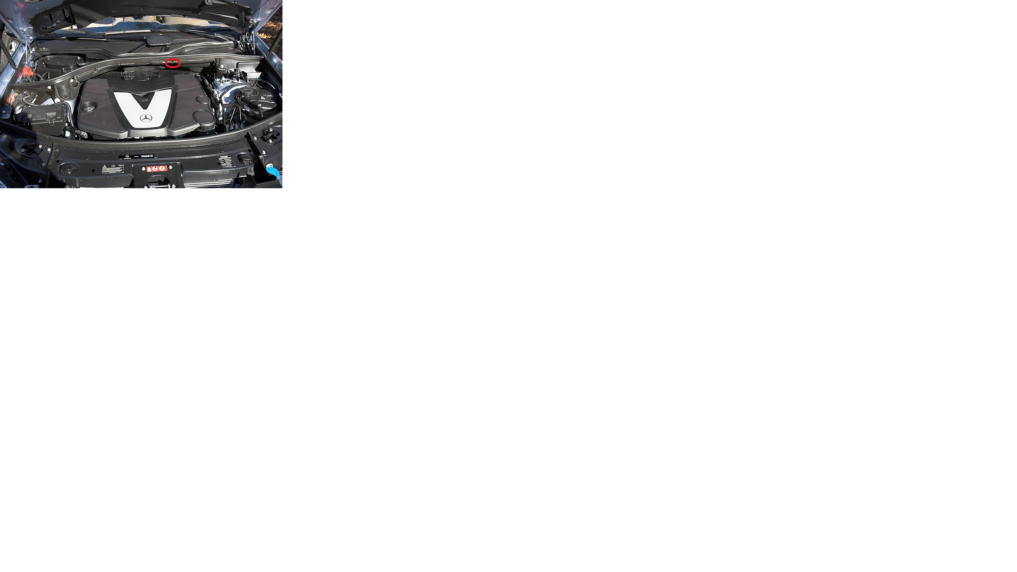

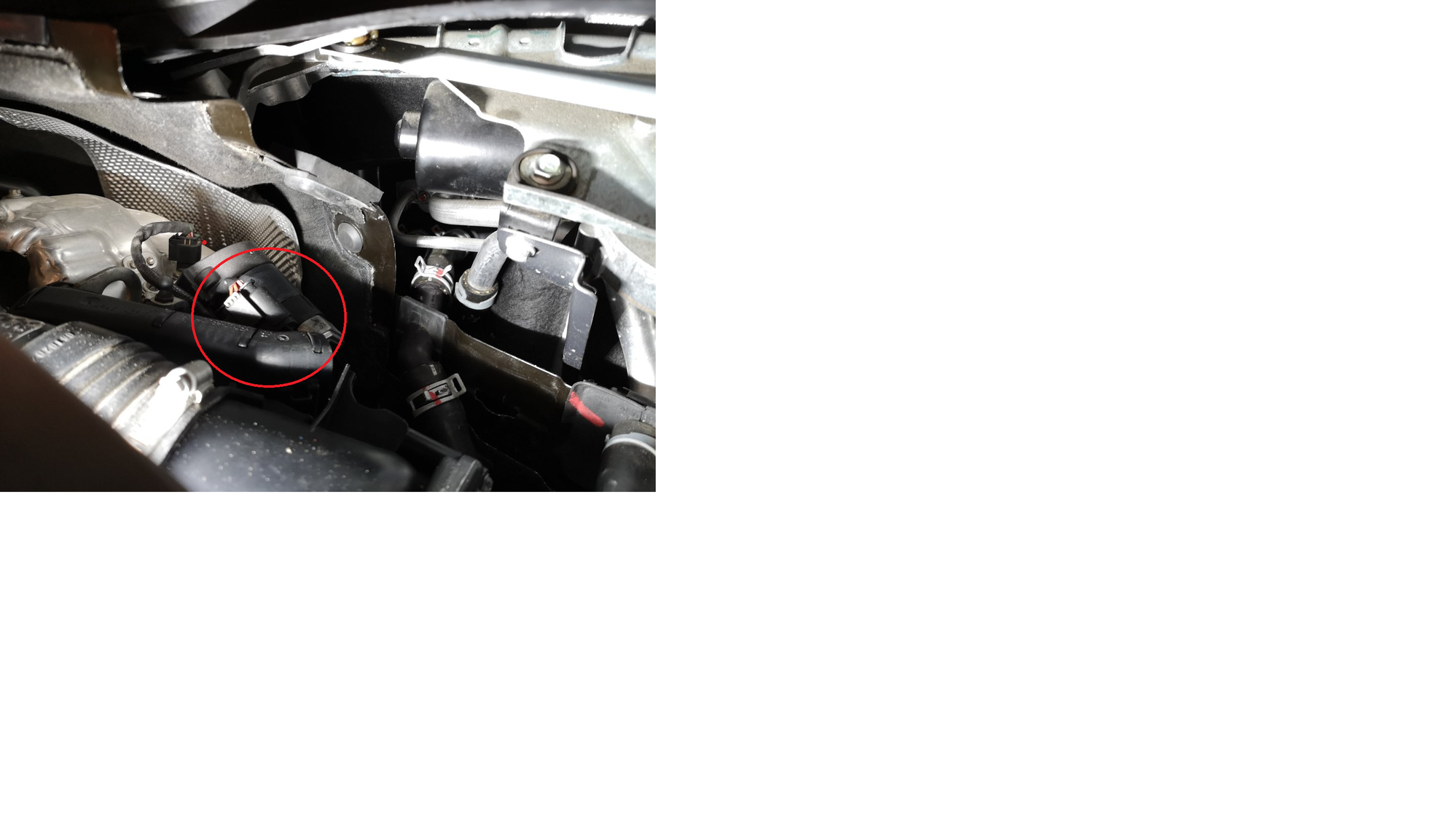

Sending picture here to double check we are talking same piece as there was one more insulator that I installed.
Got that one installee
This is the one I'm trying to find home for
The one on the paper is the one I'm trying to install back on

Ok there is another one mounted vertically in this area at the bottom of this panel behind the EGR, possibly behind the silver heat shield.

awesome - found it exactly there
thanks a lot for help - saved me a lot of time from taking the middle panel off - I was able to loosen the driver side and mount it in place
