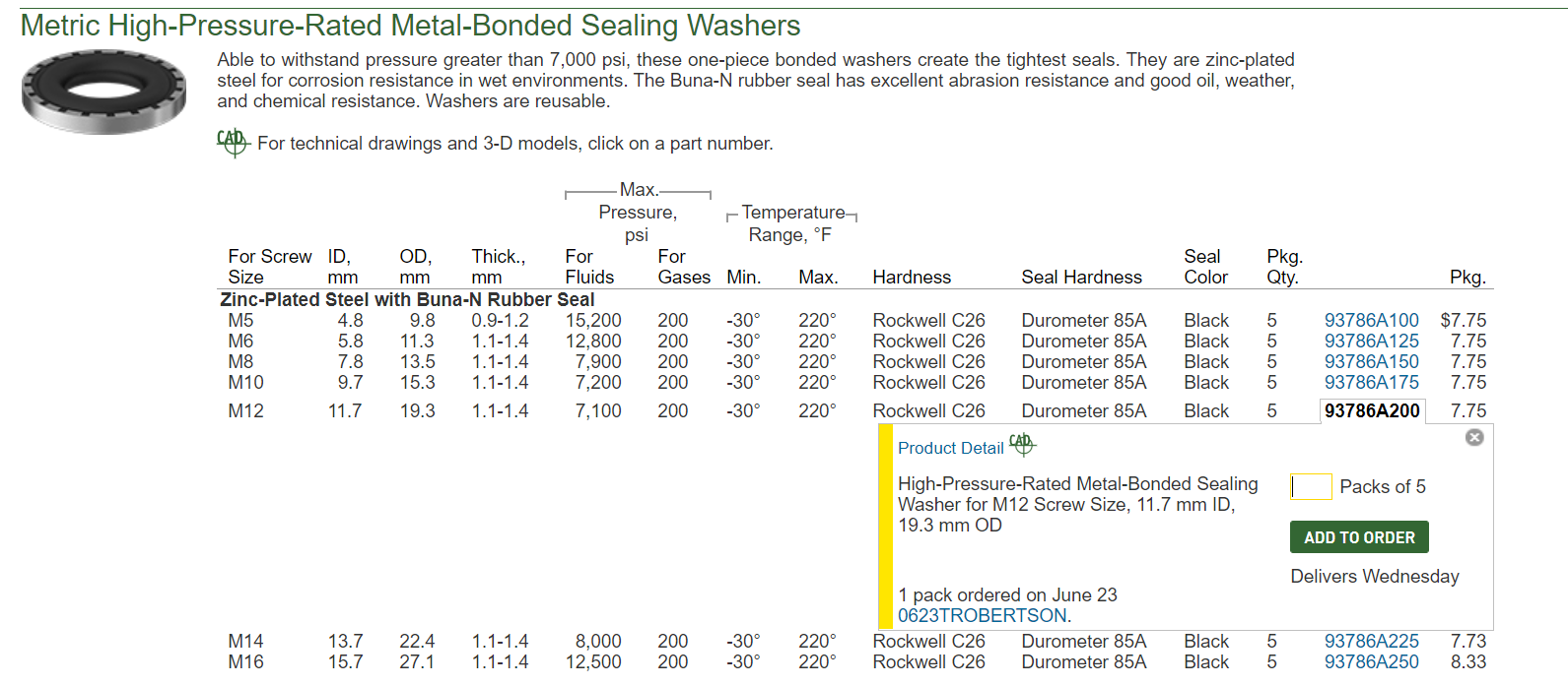

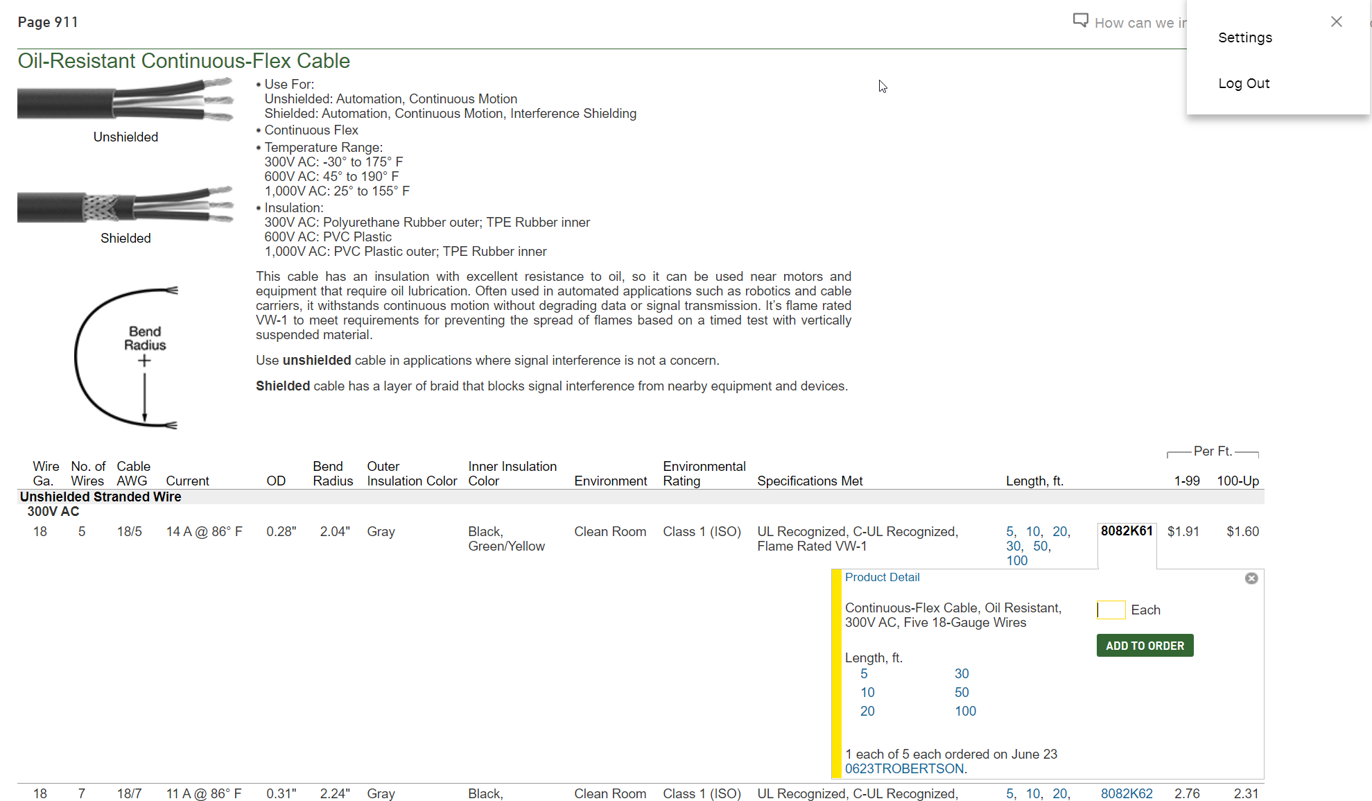

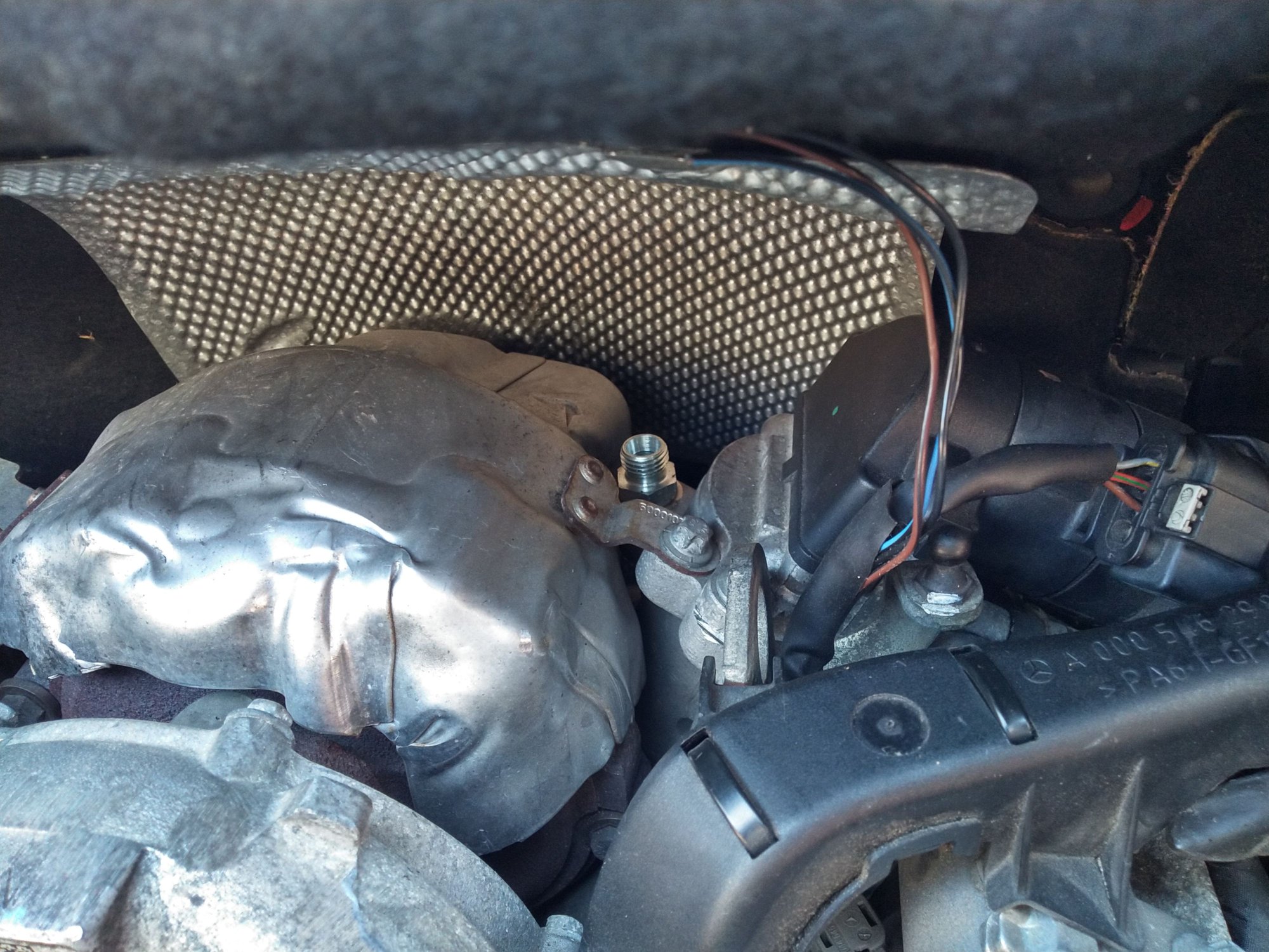

My 2008 320 CDI eats exhaust pressure sensors like candy. (2 per year) they get full of black soot and start to read erratically. I cut one open and saw the o-ring and diaphragm inside. The soot and heat just tear them up. I ordered some parts from McMaster Carr and made a piece of tubing that relocates the sensor behind the air filter box. As a barrier I added a small amount of engine oil so the sensor never sees direct exhaust. I only added up to half way so the oil would not migrate to the exhaust system. the parts ordered are in the pictures.
