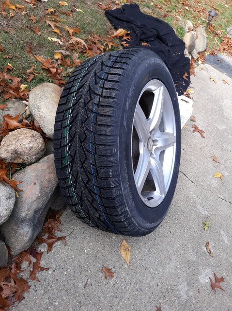

Ordered a Toyo Observe G3 Ice in 275/55/20. Will mount it up on the front and test lock to lock in the driveway this friday. If its good, order the others.

The 275/55/20 JUST fits at full lock with this 9.5+43mm offset. Im goign to space the rears out 15 mm to be +9mm proud of the stock 10+37mm 21" wheels. Front I wont touch as I like being able to go lock to lock with no rub.
Waiting for the other tires to come in so I can road test them. Ordered some of the plain black adn chrome with no laurel leaf center cap logos for the winter wheels.
