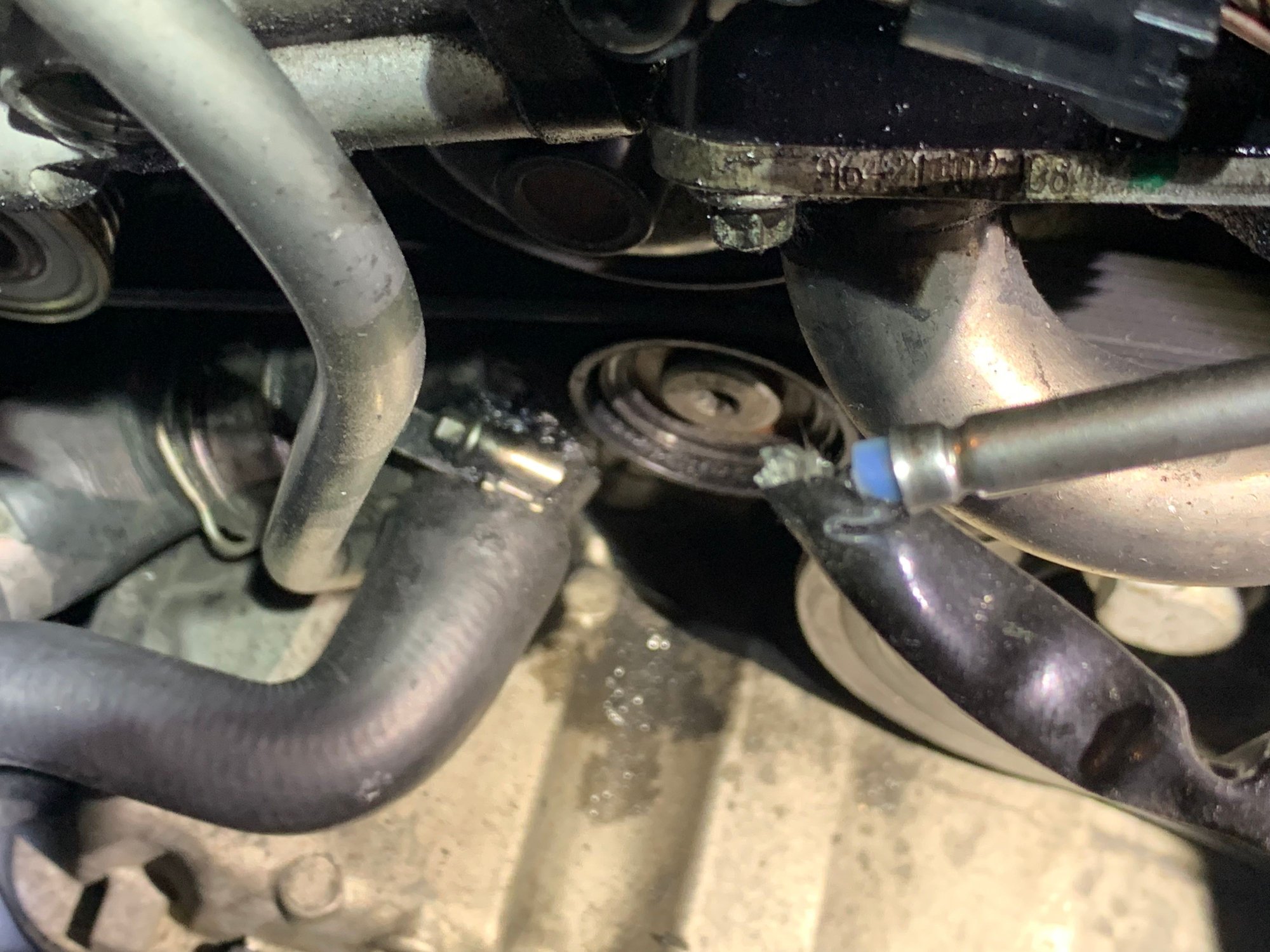

First, there is an area in the front of the engine where a large hose is attached to the front of the engine, down low, near the crank with a clearly damaged end and worm gear clamp. I see it as black and I believe it drips down onto the oil pan.
You can see the damaged hose end, worm gear clamp and wet spot on the oil pan metal here. I don't think this is the source of my leak that gets to the floor, though. What is the name / part number of this hose? How urgently would you treat this issue? It doesn't seem like a high pressure hose.

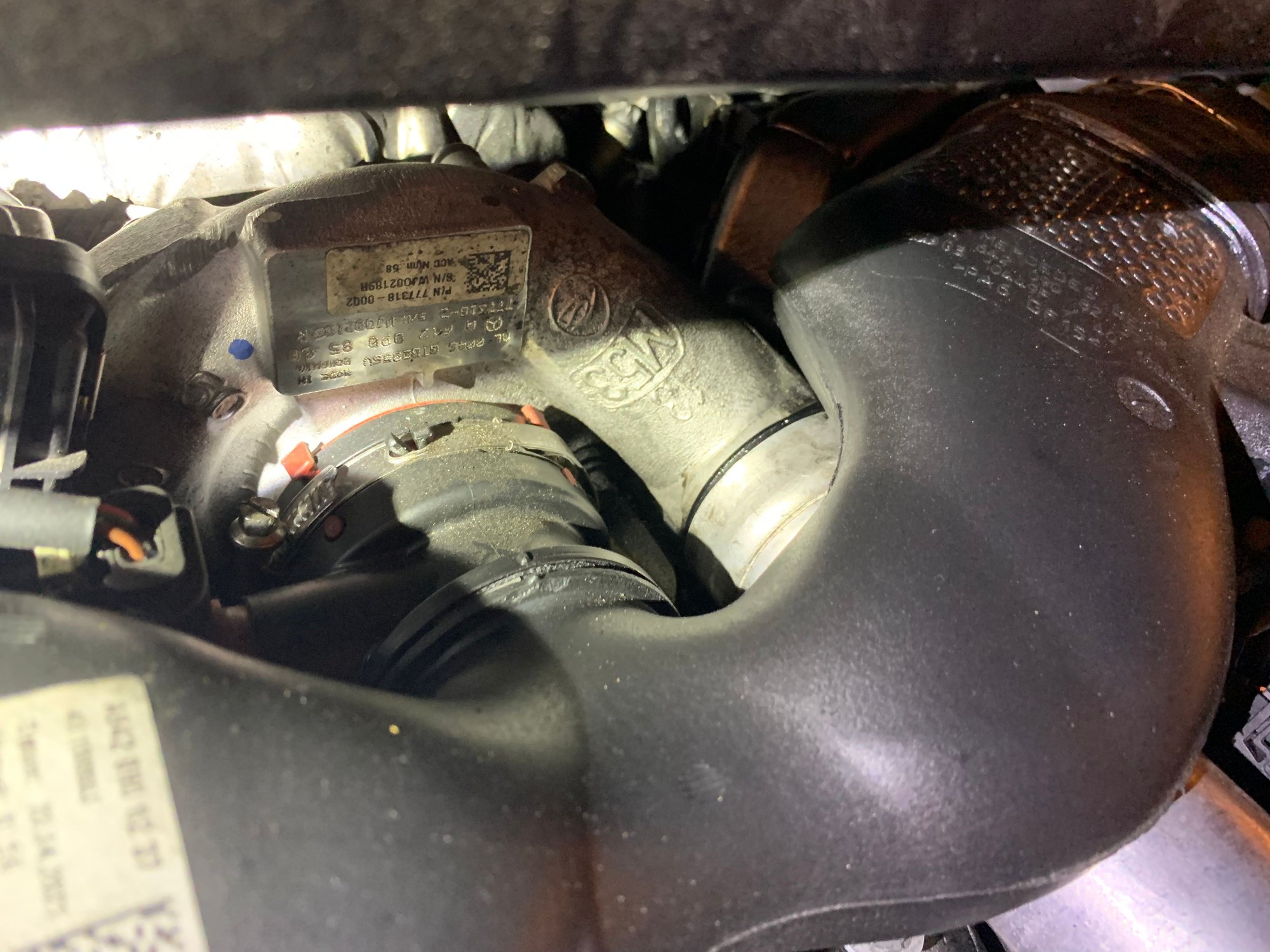

Next, if you move up on the front of the engine, you get to the area where there is what I believe is the diesel injector / pump area.
There is a seam connecting metal to plastic near the green dot that will become slightly wet. It doesn't drip oil, but just gets greasy / misty looking. The area around the green dot on the black plastic tube also appears covered in an oily residue. What is this part of the engine called? I suspect there may be a leak at this gasket or a crack in the pipe leading to oily mist getting all over.

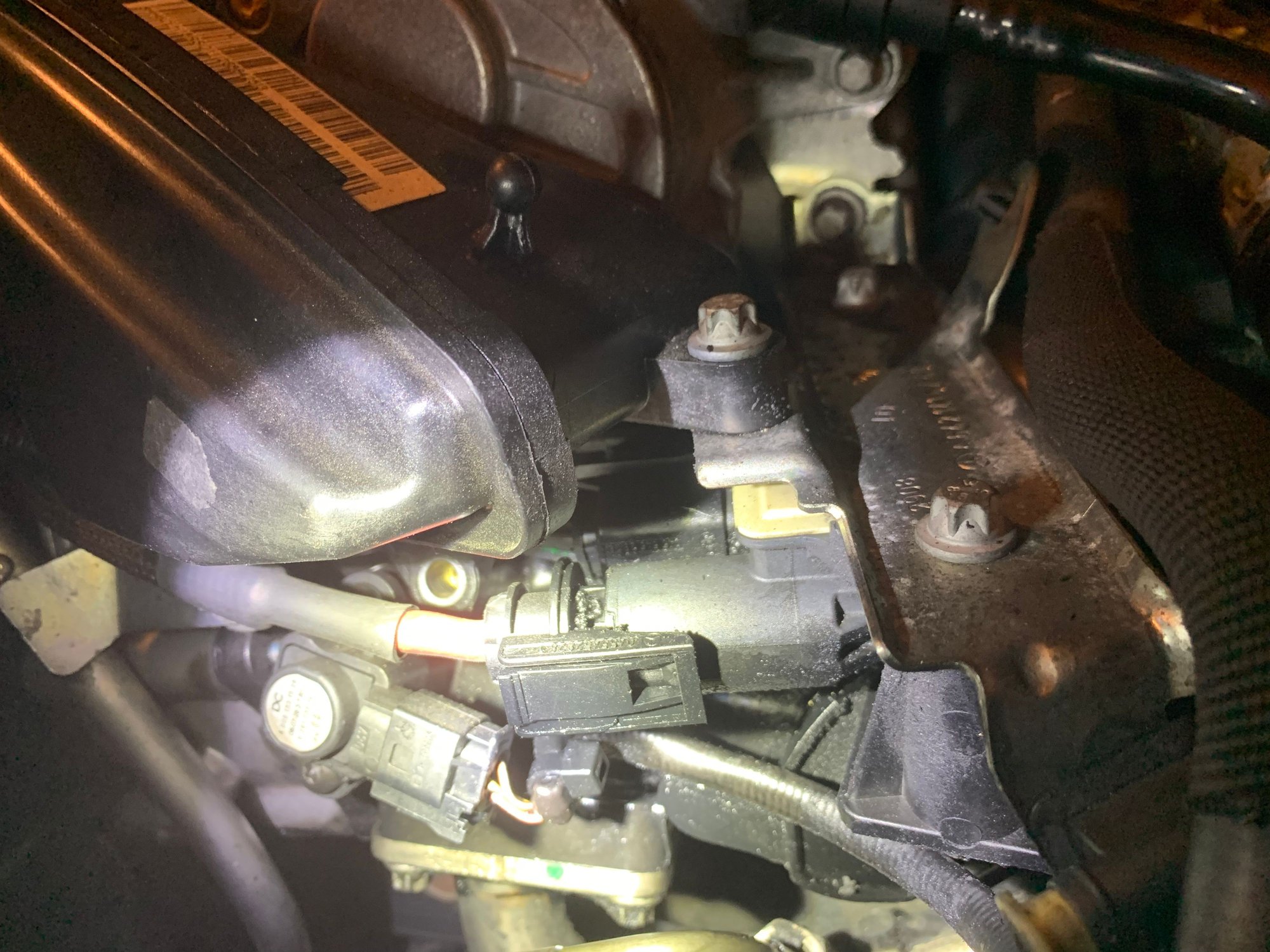

So then we move to the back and top of the engine. There is the large metal tube leading to the turbo. There is a black seal of some kind that connects to the tube to the turbo. There is oil coming from that joint. If I look down from that, it falls down on to some wires below the "batwing". I suspect it continues to drip down from here onto the floor, but I don't really know.
You can see the joint I'm talking about to the rear of the batwing on the right side. It is the black seal just to the front of where the M53 is cast. There's not much oil to see in this picture because I already wiped it. Not enough wet oil to soak a shop towel but enough to easily make a mark. Perhaps this o-ring or seal should be replaced.
Note that I have already replaced the CCV inlet seal and the main batwing - turbo seal and that may have helped but it didn't eliminate the problem.
Based on the depth of the leak relative to the front of the car, this is the best candidate for the source of the oil on the ground. It doesn't seem like enough oil to make a spot every day, though.
