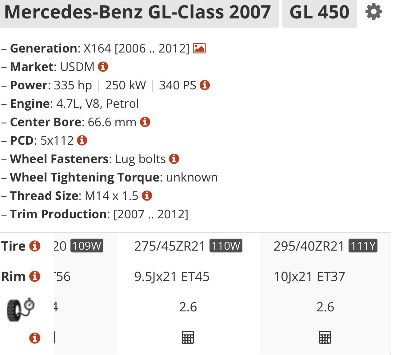

Here are the specs from the car but I honestly don’t know how to read this

Originally Posted by expl0rer
The offset is specified in the listing. it is ET +38. it is also stamped inside the wheels and has the format ET +xx where xx are two digits. The 21 inch wheels which came standard on the 550 are ET +37, so these wheels will look flush to the car as the original wheels. My concern is the width of this wheel. it is 11 inch vs the original wheel's 10 inch width. I don't know if the GL has enough space to accommodate 11 inch wide wheels. It might, just not sure. You'd have to measure how much space you have between the inside of the wheel and your suspension.
So these are 550 wheels? I have seen them on a lot of GLEs lately…to measure the space would I just do that with a tape measure or would I have to lift it? Could I slide under and eyeball it or take a picture?
what would happen if there is not enough room?
Old Apr 28, 2022 | 09:20 PM
expl0rer's Avatar
Joined: Nov 2019
Posts: 648
Likes: 144
From: Yeast Coast, Canada
GL550 X164
Is your car a 2007?
I don't know which models had the wheels from the ebay link. I gave a reference to 21 inch wheels which were standard on the x164 550s for comparison.
When measuring for wheel fitnent, you must be sure you have space. Otherwise your new wheels will rub into a component when turned in or out or worse, you won't be able to mount it at all because it comes in contact with another part. You don't have to lift the car and you can use tape. Be sure you're measuring the distance between the wheel and the closest part to it which does not touch it. If you have more than 1 inch, you should be alright. I woild hope for at least 2 inches of space.
Look at willtheyfit.com for reference and run the numbers for both wheels.
I did it too. The new wheels might be a bit too close to the suspension.

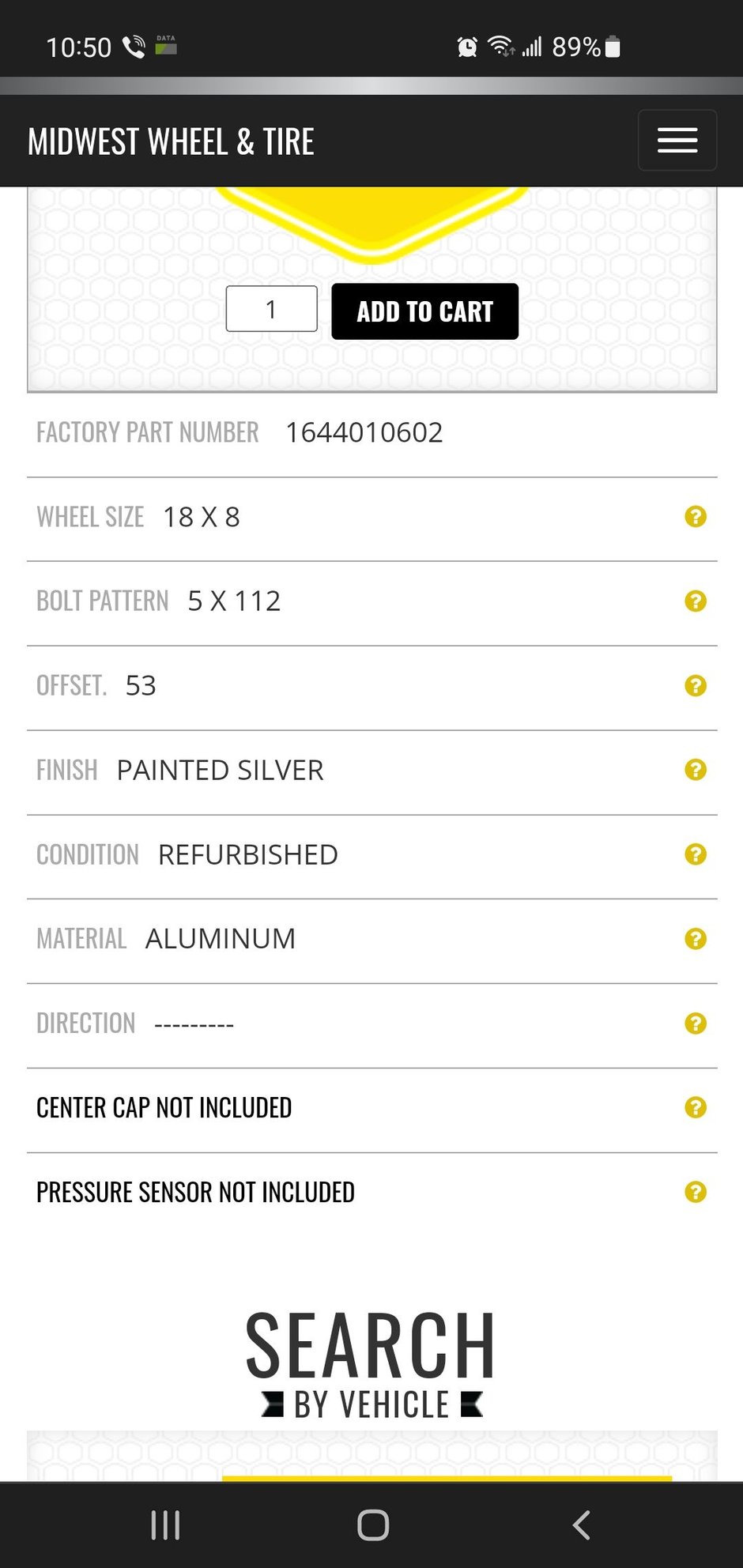

If your current wheels are 18 inch, they're not 10 inch wide or have offset ET 37. I would say they are 8 inch wide and probably offset in the 50s.
Find your wheel here
https://www.originalwheels.com/mercedes-wheels/
The 21 inch wheels which would have been standard equipment on the 550 will fit your car. I guess it became available in 2008, not in 2007, but that's not an issue. The 21 inch wheels are 10 inch wide. The challenge is to determine if a 21 inch wheel which is 11 inches wide will fit. You must measure to be sure, or call a tire shop locally. The latter might be best.

Your 18 inch wheel specs, if I sleuthed them correctly
The 11 inch wide wheels will look really funny on your car unless you add fender flares like the 550 had. I would look at other wheels, with offset similar to yours, ET +53, and maybe 9.5 inch wide at most
