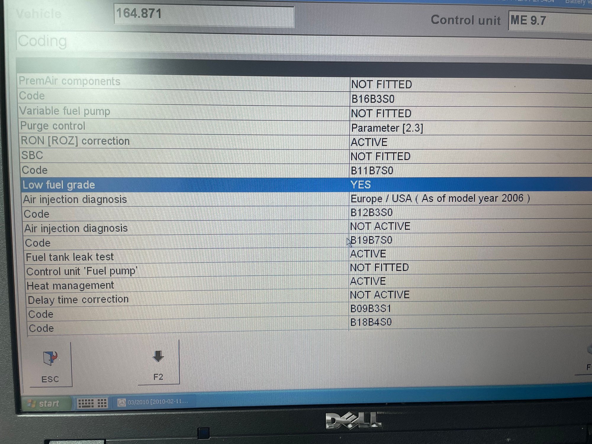

Many of us have experimented with using regular gas despite the manual's warnings that OMG THE WORLD GONNA END, and found that it works just fine. I ran a 1,000 mile test and found the fuel economy was slightly higher with regular.
The motor should use the knock sensors to adapt on the fly to regular, retarding the timing whenever a knock is sensed. This should result in lower fuel economy, along with reduced power. So the results of my prolonged test were counter intuitive.
I think I figured out why I got the results I did. In the Variant Coding tool on my Autel MP808, I found that the ECU can be set to adapt to fuel quality. This would explain my results; the ECU had already adapted to regular, so running premium offered no benefit.
I found elsewhere a reading for the octane that the ECU had adapted to. But here are the switches available. One enables the adaptation:
And I guess this is the stored result of the adaptation:
The motor would probably be happier, and burn cleaner, with premium, but I question whether it is worth the 10% difference in fuel cost.
It would be interesting to run premium for a while to see if the adaptation resets Low Fuel Grade to "No" by itself.
Note this seems to imply that the system does not adjust timing on the fly, but rather over an extended interval.
I recall when I first switched to regular, I heard knocking in certain situations, like very light throttle and moderate rpm, in which one would not expect a knock in the first place - and certainly not the sort of situation in which a knock would be cause for alarm. Obviously not healthy, but not indicating panic either.

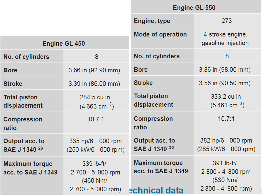

Do you have the 450 or 550? Wondering if the compression ratio difference between the two (if any) will make regular gasoline better digestible by one vs the other..
450
Same compression ratio.
Curiously: I assumed the bore was simply wider, but it turns out the stroke is longer also. That means the cylinder head's combustion chamber must be not only wider but taller, or the compression ratio would be higher.
​​​​​​​10.7:1 is a high compression ratio. I am surprised the motor burns regular as well as it does.
That's what I'm thinking too. Good to know that and you also have the empirical data.

Interesting - I have also come across this in DAS.
i wonder if it’s selectable so it doesn’t have to adapt.
Old Jul 15, 2022 | 06:52 AM
eric_in_sd's Avatar
Joined: Jun 2010
Posts: 2,786
Likes: 644
From: Emmett, ID, USA
2007 GL450
Yes, the adaptation (#80, first picture) is a switch. I think it was Active / Disable.

I think this is pretty much automatic… And that it senses knock against a given fuel map for a known octane rating and then trips the yes flag here. I have always ran premium in this but today I ran it dry and put in a quarter tank of regular and it had learned it.
It might be possible to do some damage were you to manually trip this in developer mode to NO and then run regular, in that it might ping and detonate in the time it would take to readapt itself to the low octane fuel flag.
Great info, and glad to see the confirmation from DAS - I am going to switch to premium and see how quickly it re-learns it. Thanks for sharing the info.

I put in a full tank of 91 octane. I was surprised that after a 50 mile road trip the adaptation had not gone back. It might need several drive cycles, or it might not reset on its own, out of conservatism.
I set the flag to "NO" and also there is an adaptation for Ignition that seems to be the same thing; I set it to 93 (we are at some altitude here in Idaho; it was at 87, and has 91 and Base as options) and will see what happens. I didn't hear any knocks in the customary part throttle / low speed / up hill setting. My motor has enough problem with carbon buildup, I figure I should be as kind to it as possible.
Curiously, the one time I thought I heard pinging was right after starting up. Maybe the engine is still in open loop mode at that point.
One observation: The exhaust smells better. Recall I have gutted cats, and at first the stink was enough to make me want to replace the cats. Now it is more mild; I think the combustion is better. It will be interesting to see whether the spark plugs are less carboned.

I switched back to 87 octane several tanks ago. The ECU still has not set the flag to "low quality fuel". I had run the adaptation for 93 octane a while back, so presumably that is the map it is still using.
It is curious that the motor still has not adapted down. Winter driving? Boise is at 2800 feet, so that helps, but still ... Mileage is not great but I have generally observed that cold weather = worse mileage.

Odd that the GM ECU does not adapt to the gas better.
I wonder if my motor's adaptation to "bad gas" was due to the carboned intake valves. When carbon deposits cause a problem, it is through preignition - which I assume the motor responds to by mapping ignition to retarded settings. "Oh no. It's retarded."
I did not check the adaptation before the carbon became a problem.
If your motor quickly adapted to "bad gas", you might want to try resetting the value to No after a few tanks with a top end cleaner like Regane Complete in there. It could be you have carbon bothering the motor. A few bottles of Regane is a cheap experiment.

Update: The self adaptation is still set to "low quality fuel / no". I have been burning 87 octane the entire time. What's more, the manual adaptation I performed a while back was for 93 octane.
There is no audible knocking under any circumstances.
I have run several bottles of Gumout Regane Complete, which is chock full o' PEA, through the motor. Perhaps I now have nice clean intake valves.
Perhaps someone else, @Max Blast perhaps, who has a bidirectional tool and wants to experiment, can try running some cleaner and seeing if the adaptations still go to "low quality fuel / yes" afterward. I can't think of any other reason my motor should be this happy with 87 octane.

Yeah, maybe I can hook up the tool and see what mine still set at at… I’ve been driving regular for well over a year, about 12 K and I have never heard a ping out of the motor. Just a re-cage everybody’s brains, the day I switched to 87 octane on an almost empty tank; from the drive home from the station the ECU had sensed and automatically set the low octane flag so I didn’t have to do anything in star to make this happen.
So I would be very shocked, appalled and surprised if that flag were now set to no.
And no way in heck am I going to set it to yes with 87 in the system.
I am still a little fuzzy on how the actual adaptation occurs, whether it’s a set number of pings over a certain amount of time that automatically retards everything and sets the low octane flag. And then, conversely, in order for the ECU to set the low octane flag to no?
