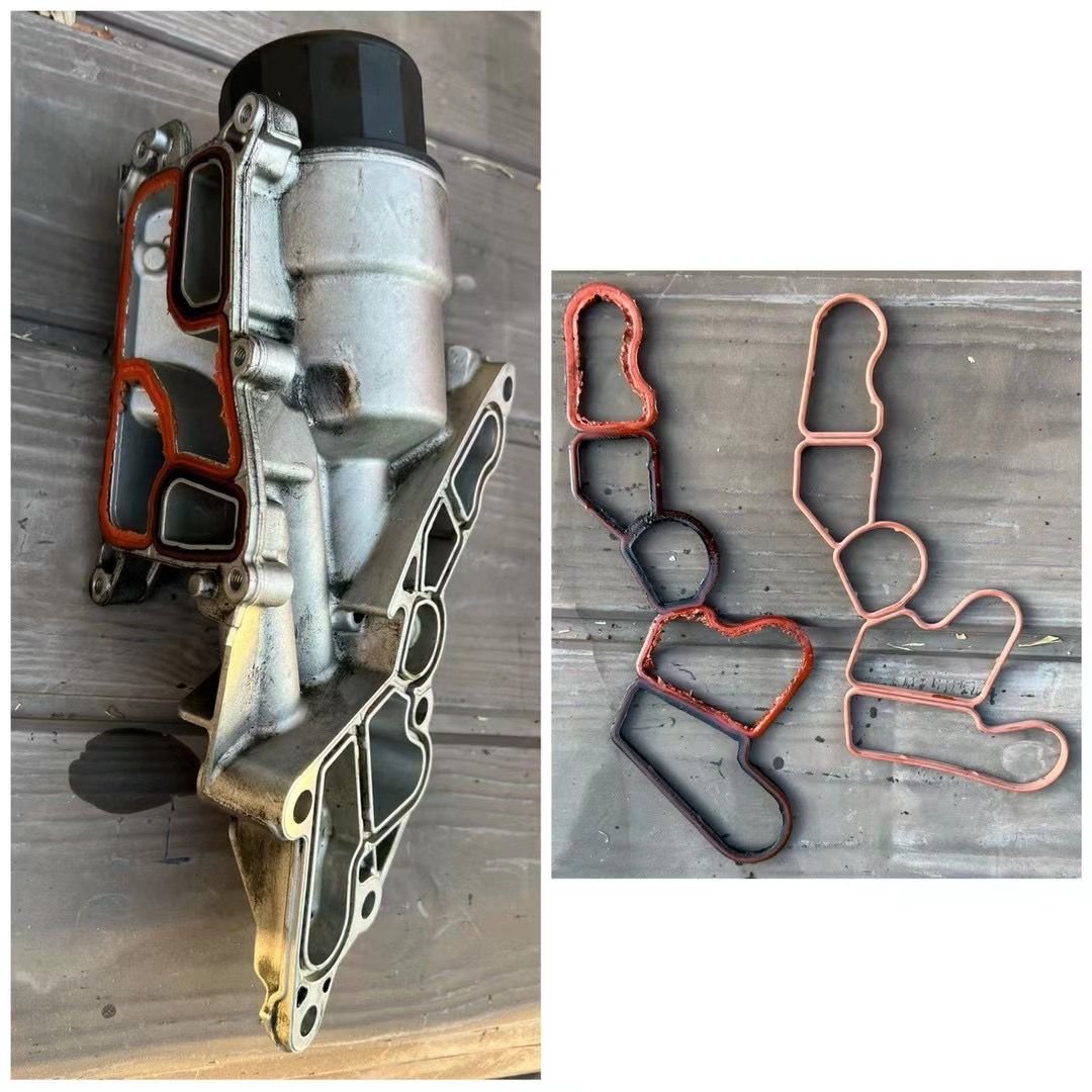

oil cooler seal (left), housing seal (right)

On the V8s at least, you have to remove the thermostat to get the oil cooler assembly off. Ive done the oil cooler and you can't get to the bolts to renove it whilst the thermostat is in place and you also need to remove at least one tensioner.
