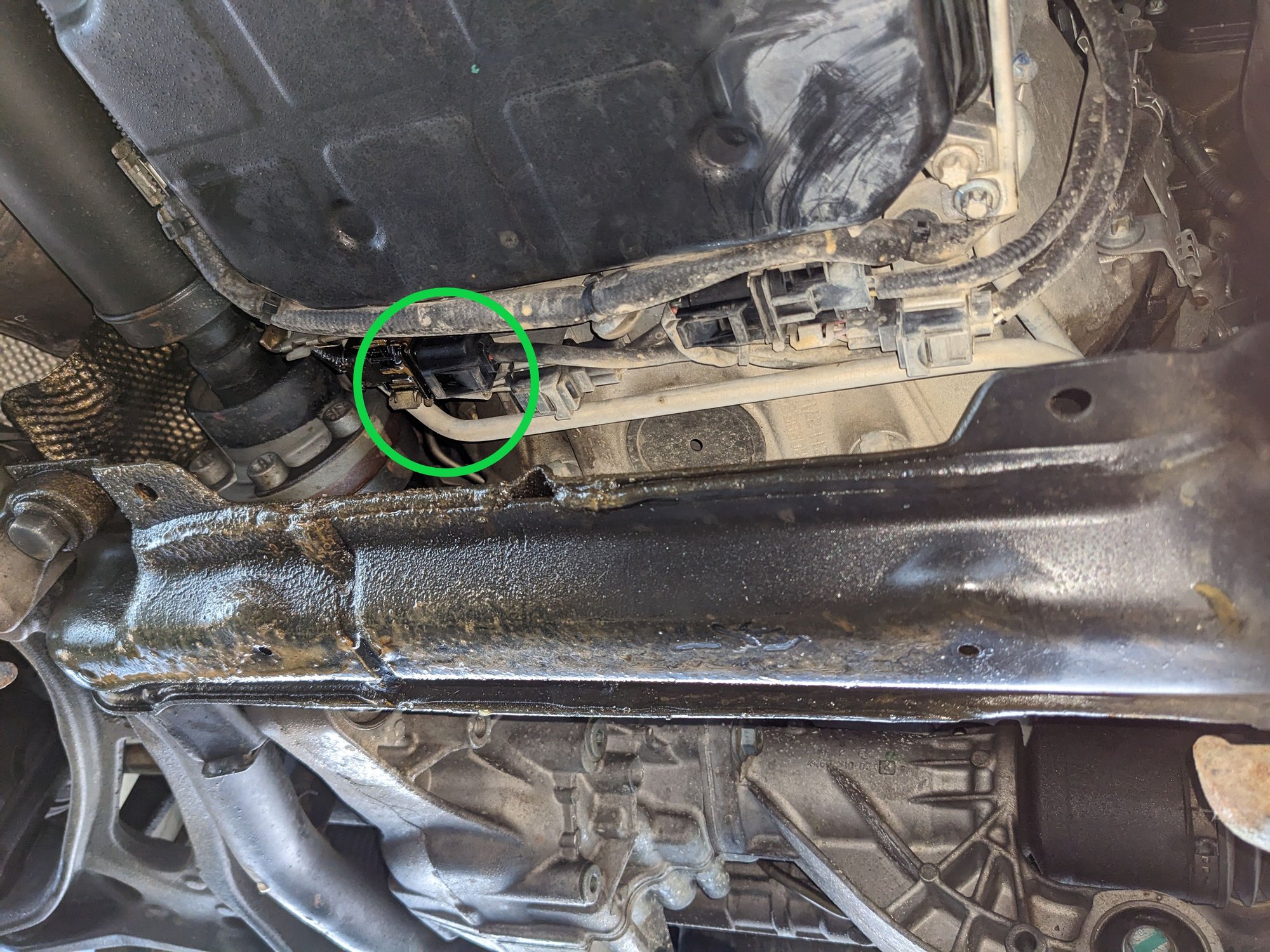

Connector ID
(Note - answered, it's for the front O2 sensor).
2007 GL450, 200K miles. Engine's cut out and gone into limp mode a couple of times, and suspect the cause might be oil leaking into the connector shown in the photo.

That plug is for the downstream oxy sensor, bank 2 if I have my bearings right.
You could unplug it entirely and all that would happen is you'd get a check engine light. That sensor is only for monitoring the catalyst health.
Next time it goes limp, pull the DTCs.
