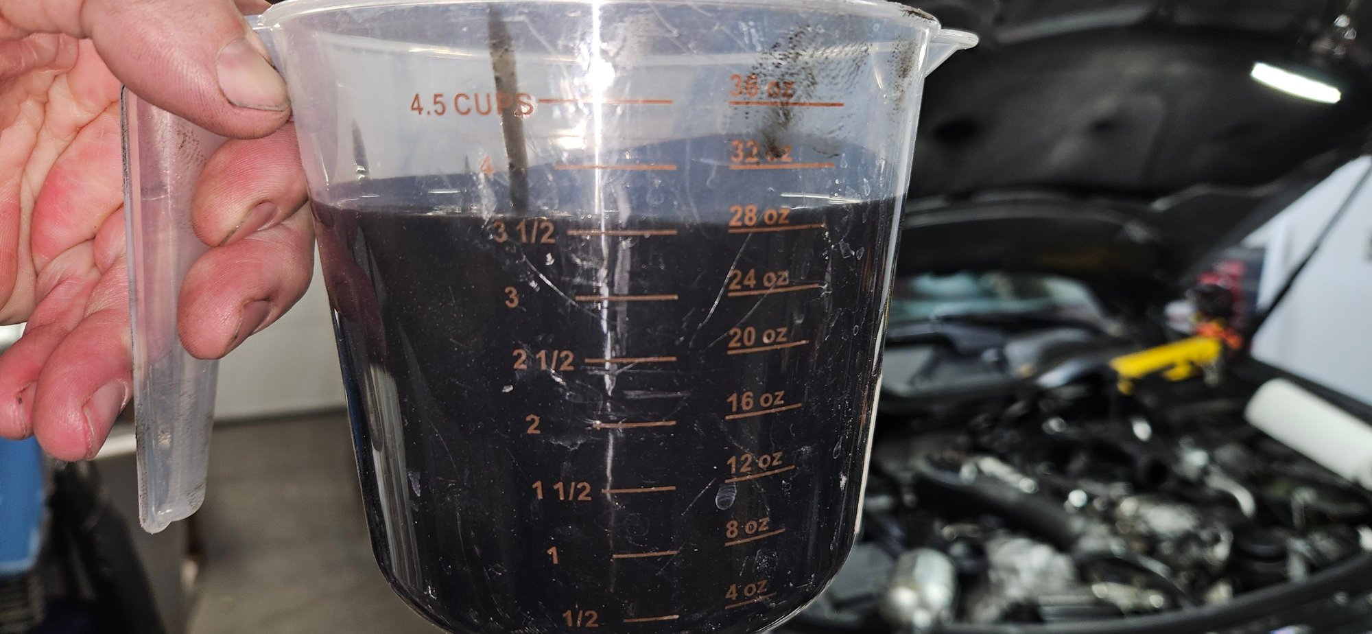

@pjhiggins I think a little amount of oil is collecting somewhere in your intake. When you start the vehicle, it's burning it off.
I decided to take off the intercooler and found about a quart of oil. Does that sound normal? I'm thinking this may be causing the smoke problem once the vehicle gets warm. Probably oil from the PCV valve or possibly the turbo seal. Guess I'll need to put it all back together and test to see if the smoke has gone away.
