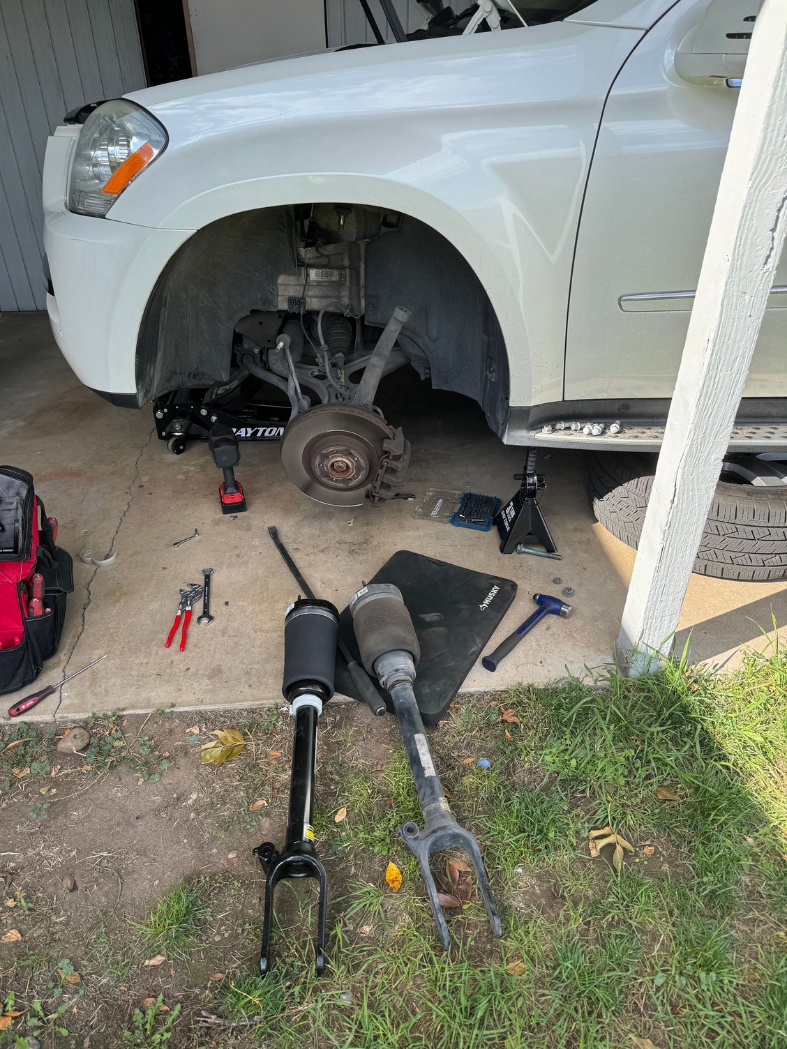

Got them done.
I actually bought Bilstein struts because I have heard better reviews about them. I got them from Rockauto as they were quite a bit cheaper than any other website. It was a pretty easy job. Took about 3 hours total for both sides taking my sweet *** time. Could probably get it done a lot faster.
I’m hoping they will last a while as this car only gets driven roughly 5,000 miles a year
