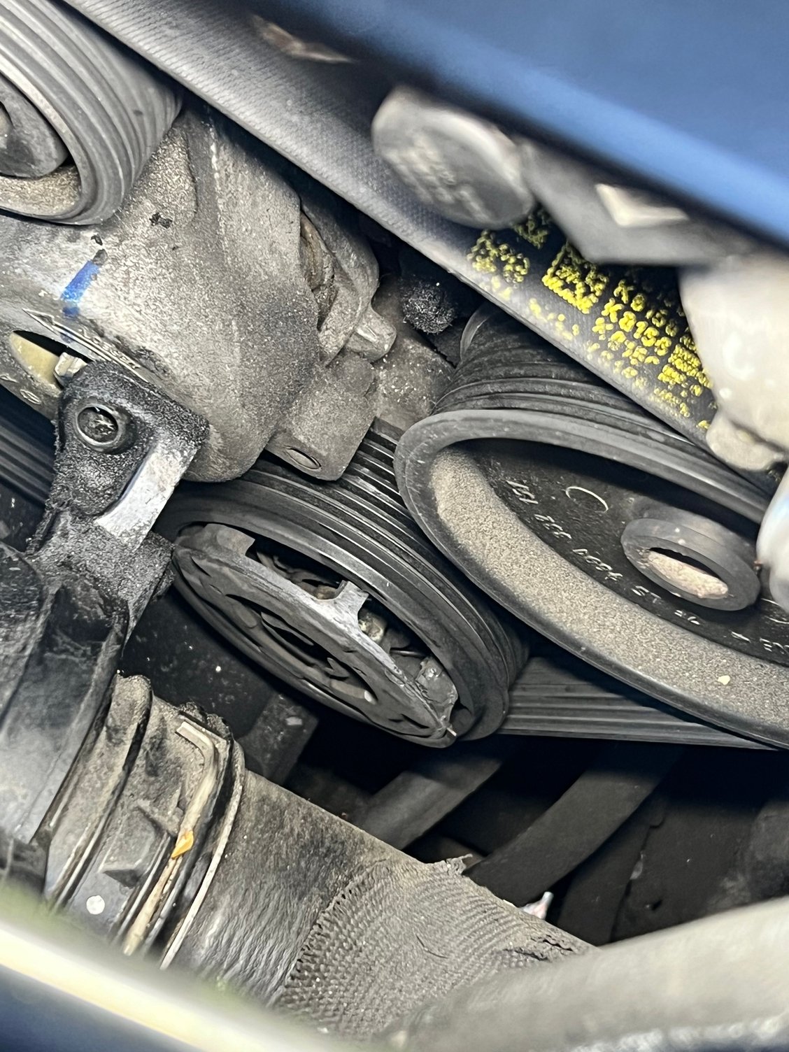

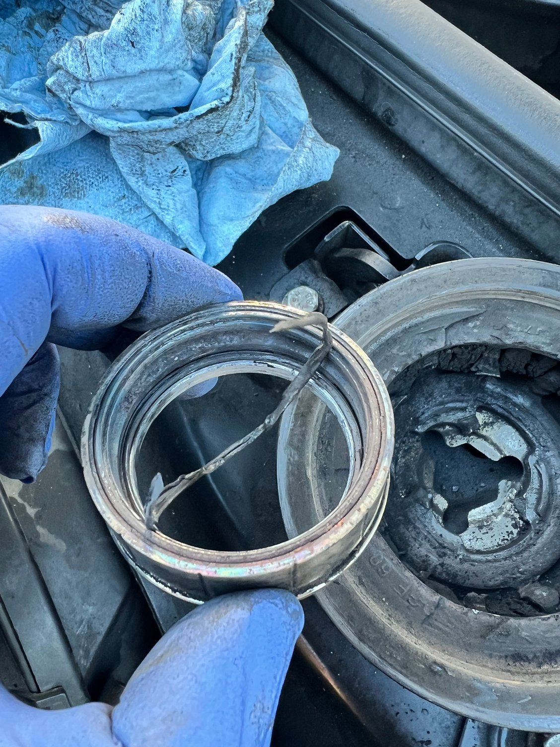

Upon investigating, I traced it to the AC pulley. The AC pulley had sheared off from the AC unit and disintegrated!
You can see that something looks off in the bottom there
The pulley in pieces

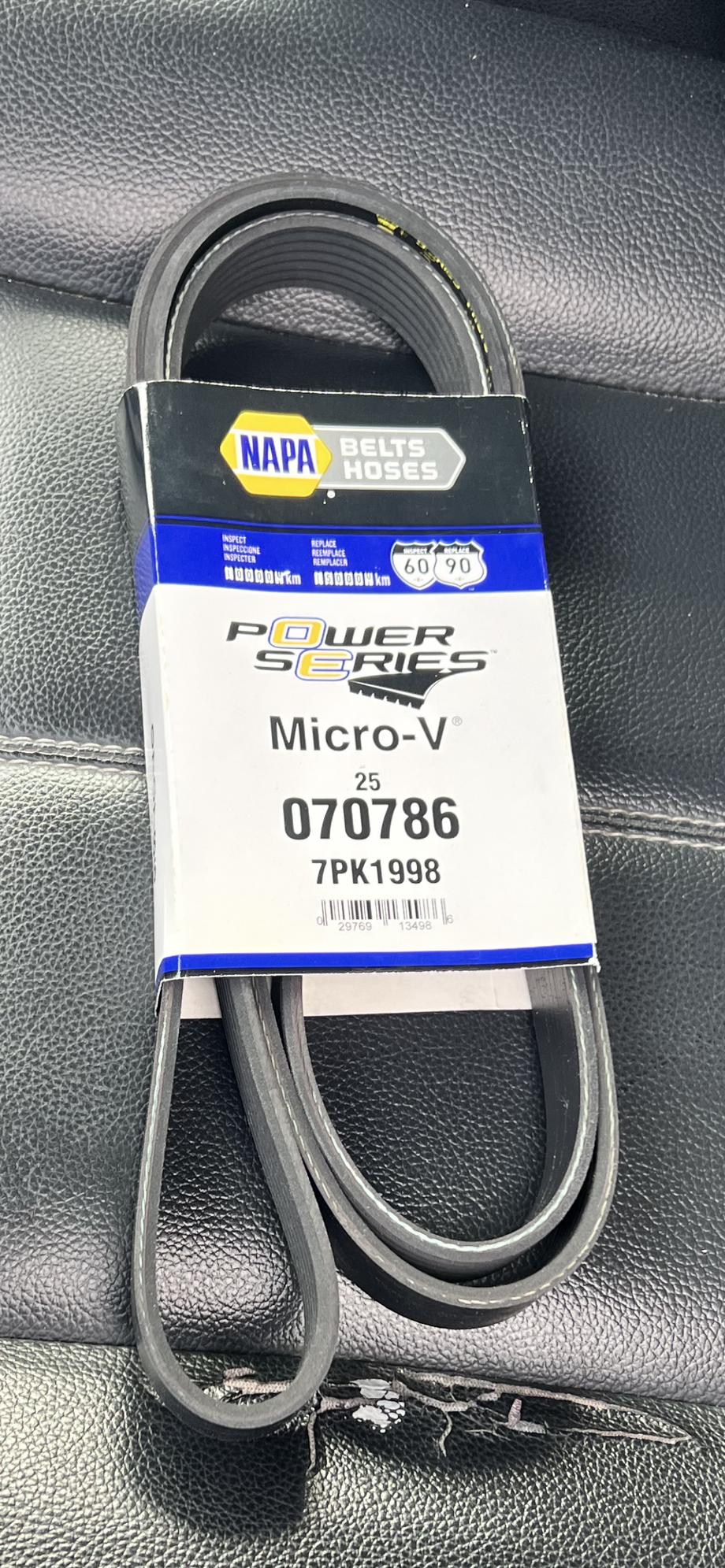

The corresponding part number for me was Gates 7PK2000 (7 ribs, 2000millimetres, etc.)
Now my local Lordco Automotive supplier didn’t have anything close.
I called NAPA and they cross-referenced the Gates 7PK2000 and offered me…
NAPA Power Series
Micro-V
25
070786
7PK1998
Napa belt part # 7PK1998

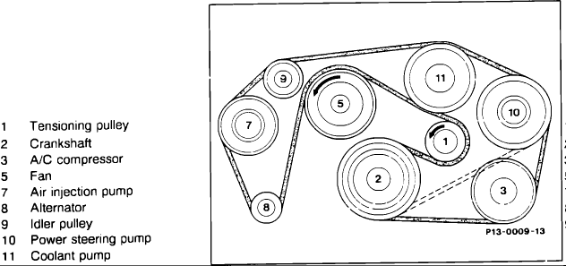

Oh,and you can see in the diagram below where the dotted line is, that’s the new route bypassing the AC Compressor pulley.
GL320 CDI serpentine belt diagram

Just an observation; I measured the length of the belt track with and without the AC pulley and the difference was about 5cm, so that the replacement belt should be less than 2000mm, but it seems that the tensioner has enough working range that it will work....

The Napa belt is actually shorter than 2000 mm and fit perfectly with some muscle to get it on.
