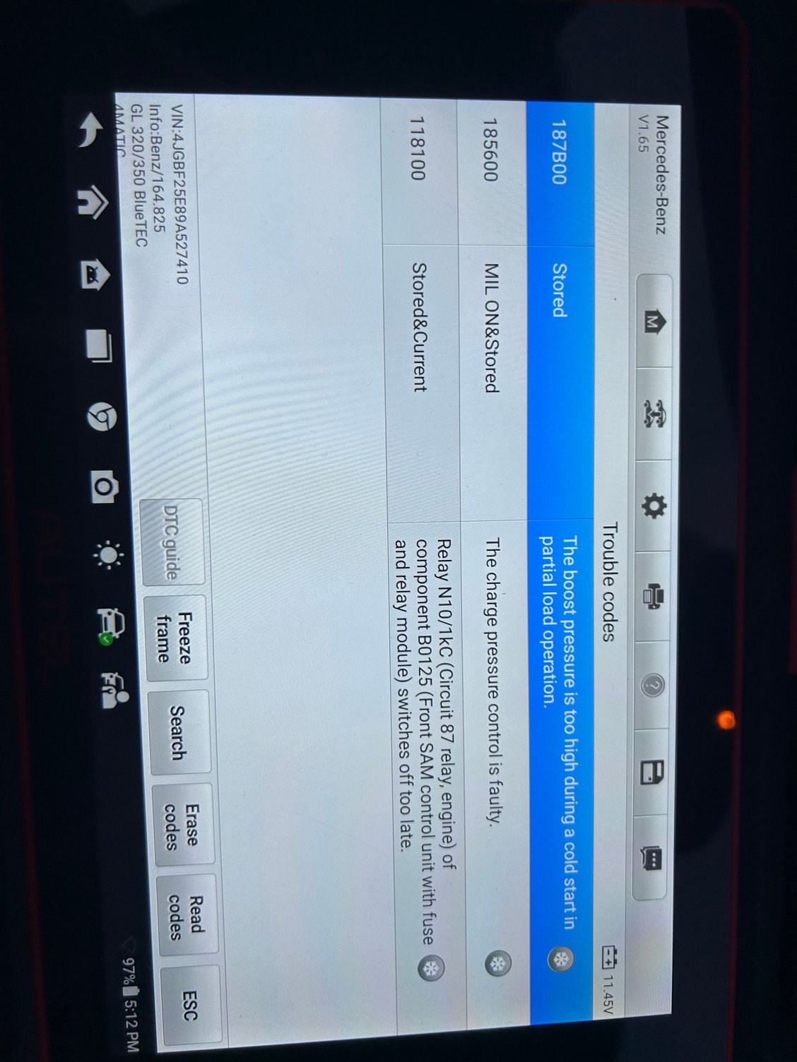

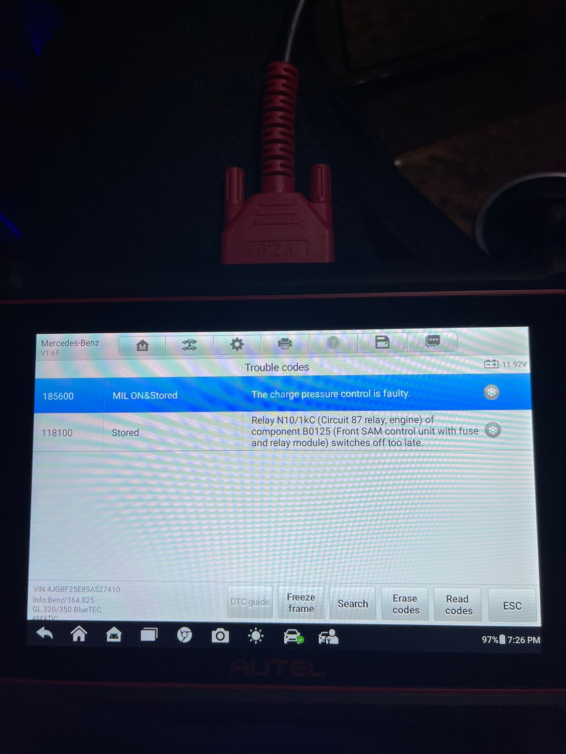

charge pressure control is faulty code and relay n10 code
I have a 2009 mercedes GL320 and it has the fault code (185600)The charge pressure control is faulty. I have replaced the turbocharger and its actuator, i also replaced the sensors(back pressure sensor and charge pressure sensor), cleaned the DPF and replaced the right exhaust manifold
and the relay N10 code always comes out when the check engine appears
these are the codes
these are the codes

After one day later I got a check engine again with a new code(187B00) The boost pressure is too high during a cold start in partial load operation.
