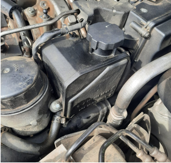

Got a leak on the power steering reservoir, can tell if its coming from the hose or underneath,
Anyone had this before and have any advice, what normally is the cause for the leak, metal clip, hose, seal underneath?

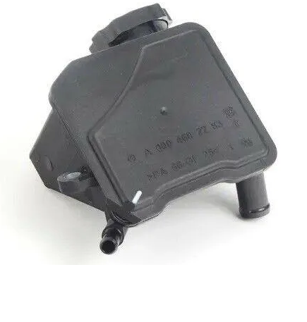

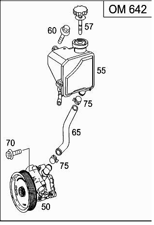

Thanks,
I did have a look at some of them, i know other models have the O-ring and c clip that needs replacing and securing in place
There does not seem to be an O-ring for the reservoir, as both connectors as to hoses with clamps, see below image of the unit and the power steering schematic

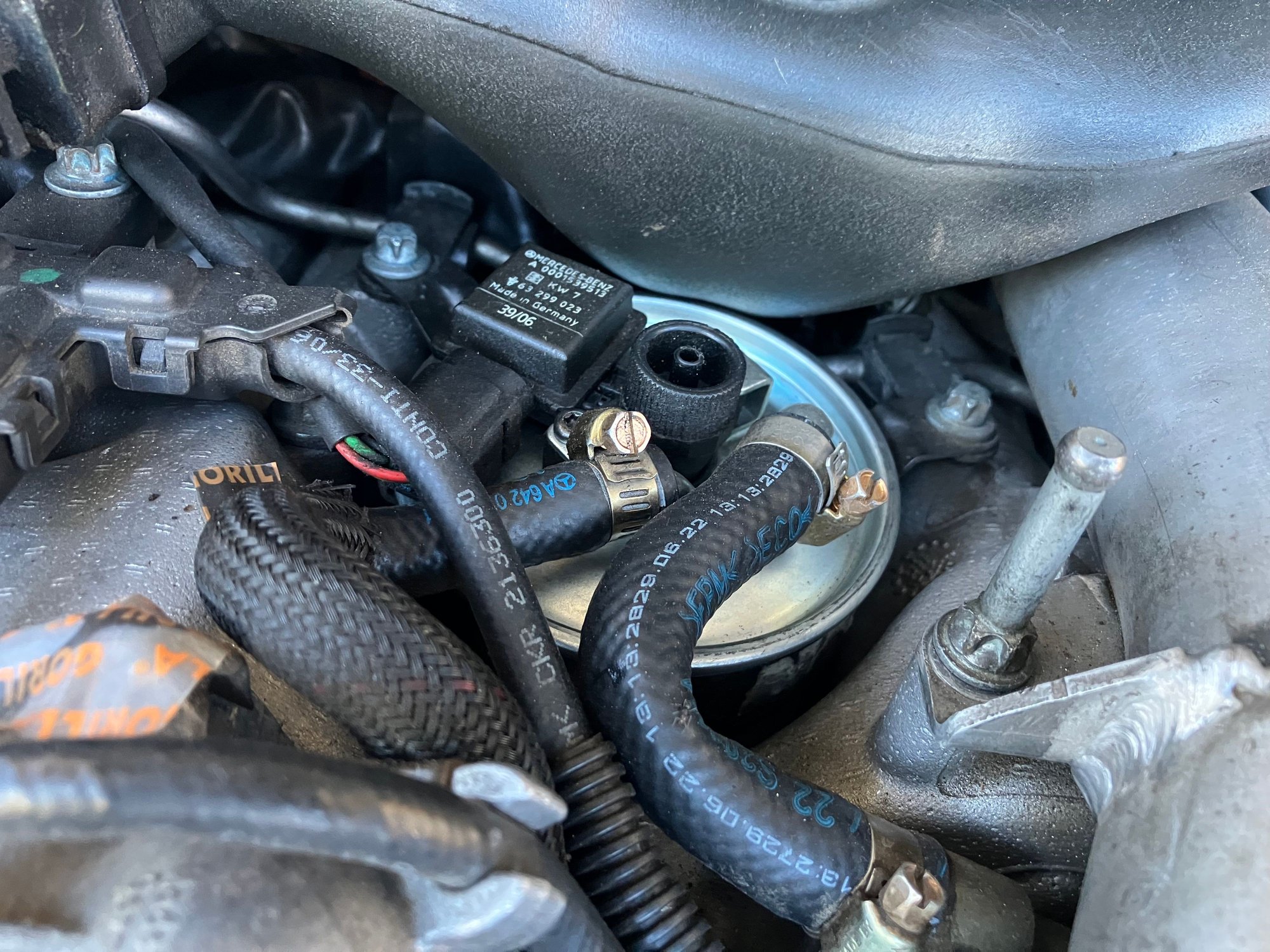

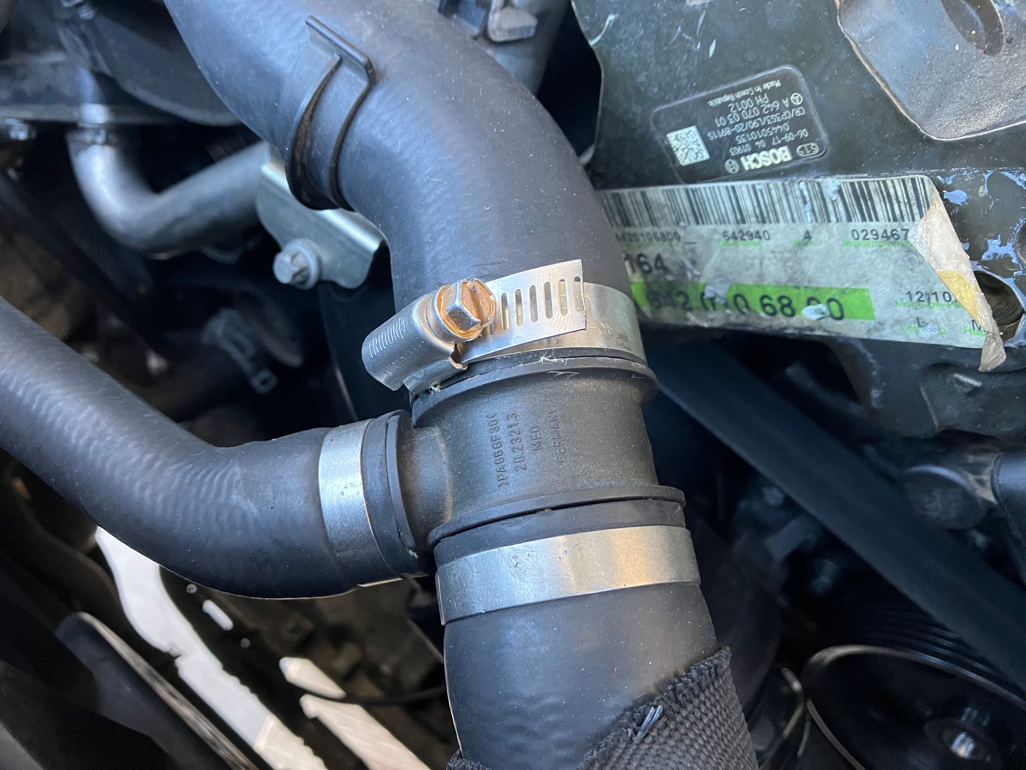

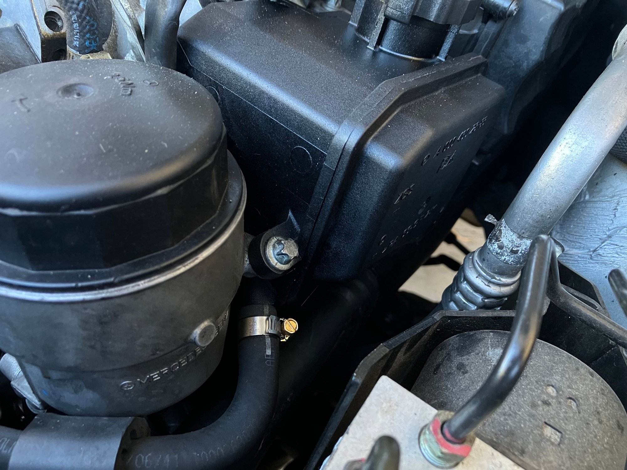

A few examples on my GL where I took off the ear clamps and replaced with adjustable hose clamps. This includes the power steering reservoir.
Fuel filter clamps
Fuel filter clamps
Steering reservoir clamps
Coolant pipe clamps
Coolant pipe clamps
