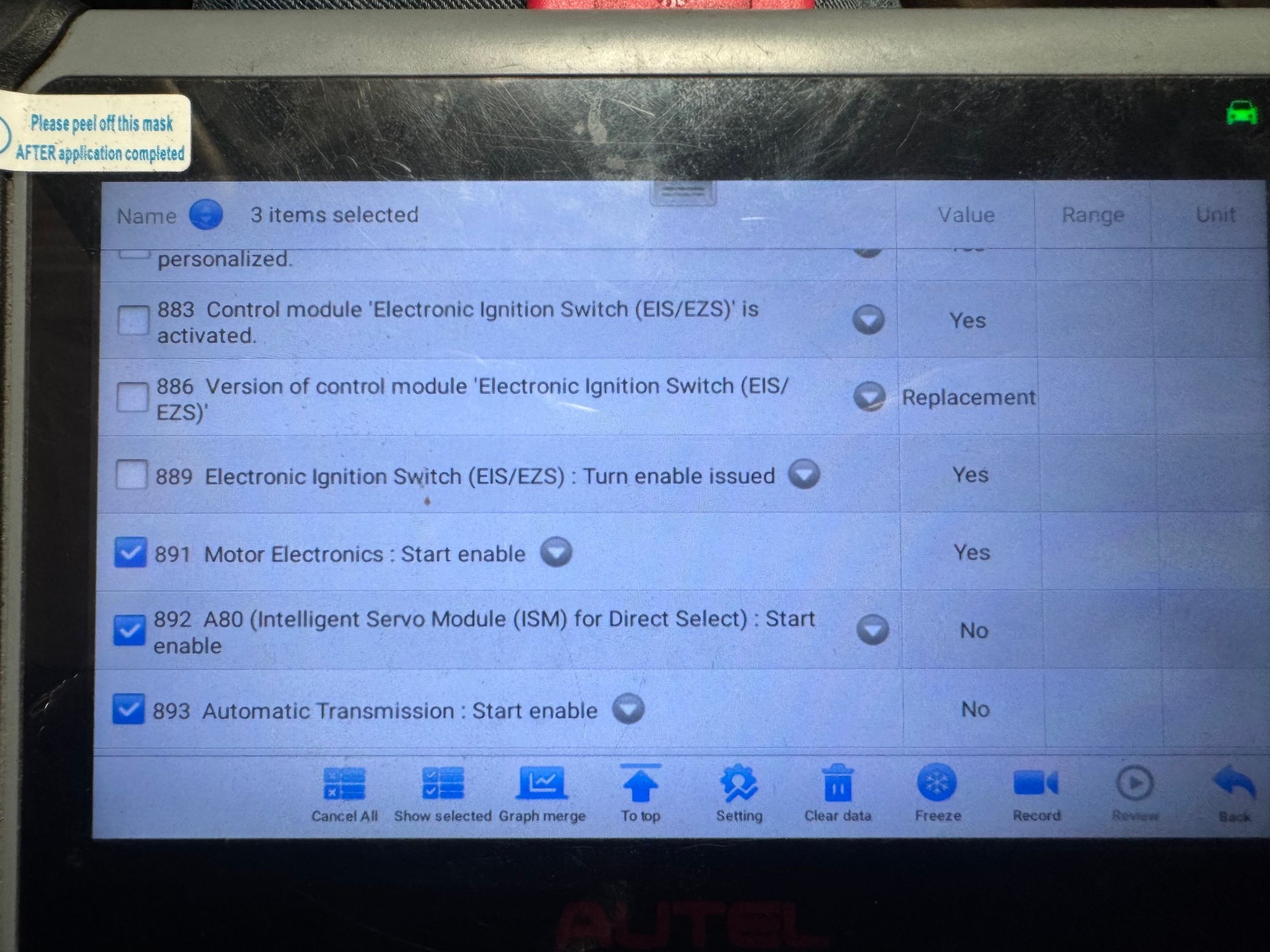

so I did something pretty crazy the other day, bought a GL350 with no key.
got a key made from a locksmith using the EIS.
now the key unlocks, turns the electronics on, cranks the car, but won’t actually start.
I bought a new Mercedes main battery, same thing.
I have an Autel 808 , ran codes had a whole mess , mostly related to no battery or dead battery. Erased everything since had no knowledge if they where old or new or what.
still won’t start.
new codes after erasing have to do with overhead light, and side sensor error, and ez in/out feature. Nothing that would prevent it from starting.
fluids look good. Oil looks good. Diesel tank smells like diesel, but haven’t checked the fuel at the fuel filter.
looked at the start enable conditions and a couple things say no seen as seen in the attached picture. Not sure if that is normal or not.
any ideas ?

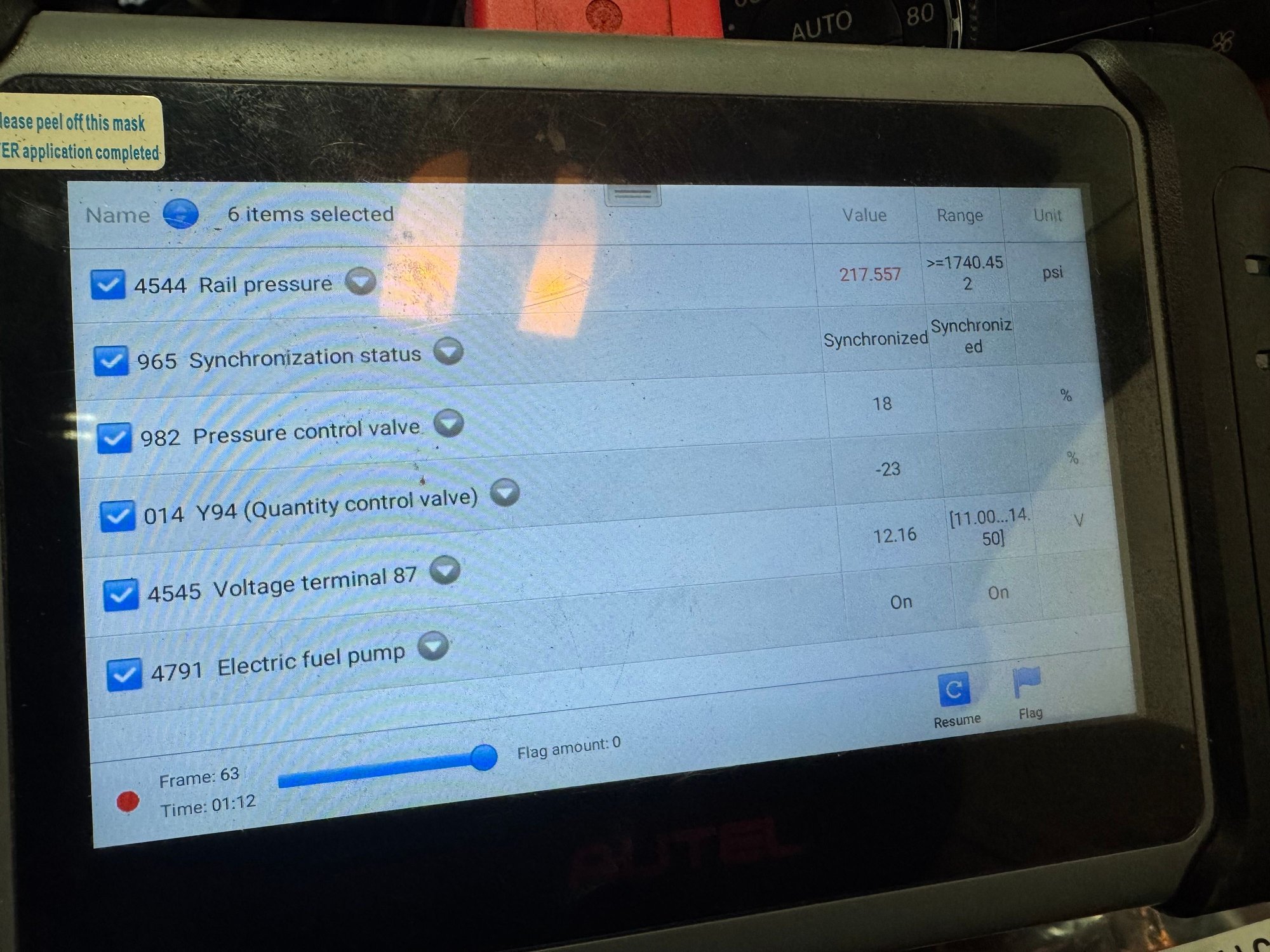

Seems to be low pressure on the fuel rail?
any ideas?
