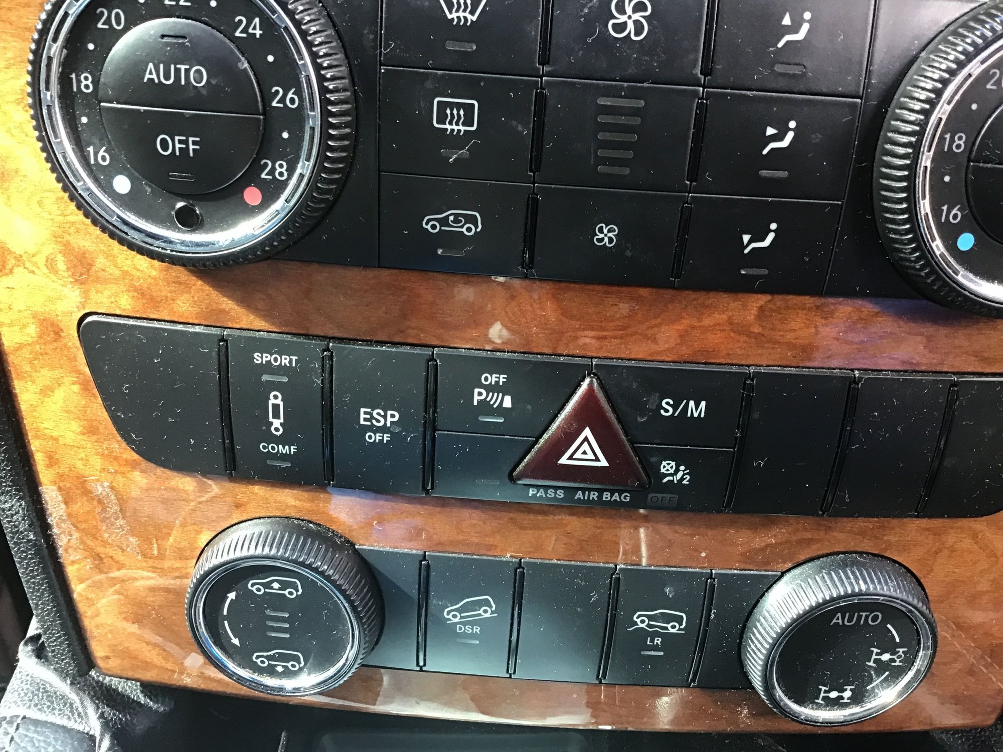

How, do you get the transmission to sit in Comfort (C) mode? There's an S/M button on the center consoles which switches between Sport & Manual, however I can't get the gearbox into Comfort (C) mode.
The manual says that on each restart the vehicle will go to C comfort mode, however it doesn't do so - it goes directly to S.

That Comfort mode on the gearbox must be a “USA” thing. My gearbox modes here in Australia is just Sports/Manual.
My suspensions modes though are Normal, Comfort, Sports modes.

Comfort/sport/nothing mode only changes the shock damping rates - that’s what Advanced Dampening System does.
it does not alter the shift points of the transmission in any way.

As Max notes ... while transmission modes are available for selection on your S-class, they are NOT available on your GL450. You will start in 1st every time. Vehicle too heavy, I assume.

Chris, I believe it is second gear start.
I have to left paddle to get to D1 granny gear if I ever need it.

and four of my cars including the GL putting the selector in s means that I will start in first gear not a second. That said, many people myself included have used services and programming tools to make the car always start in s mode with Eco turned off. Could be your car had that modification prior
