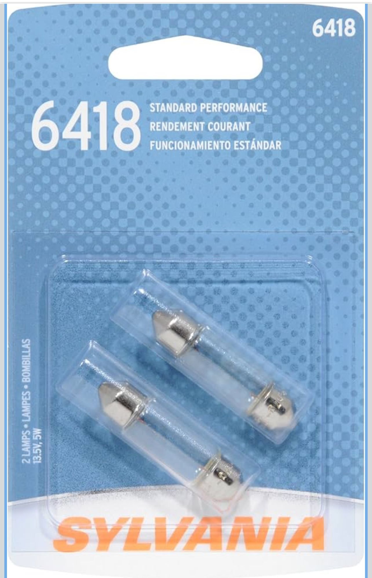

Hey guys, Im getting an error in the cluster about my license plate lights being out. I originally had an error for the left one being out, I replaced both with Sylvania 6418 bulbs from amazon. Now Im getting errors in the cluster saying both are out. When I checked, the right one was only out. Has anyone had an issue similar to this? Did i get the wrong bulbs?

Sylvania 6418 are LED Bulbs. That's why you are getting the error. LED's have a lower resistance value than the standard bulb. You'll need to either install a 5 to 8 ohm resistor inline, revert to standard halogen bulbs (which aren't nearly as bright as the LED's you just purchased), or just learn to ignore the error message. The wiring to the license plate bulbs is a PITA to access to install a resistor, so personally I've just learned to deal with the error message. As you've likely already noticed, those LED bulbs SIGNIFICANTLY aid the reversing camera at night.

these are regular non-LED
