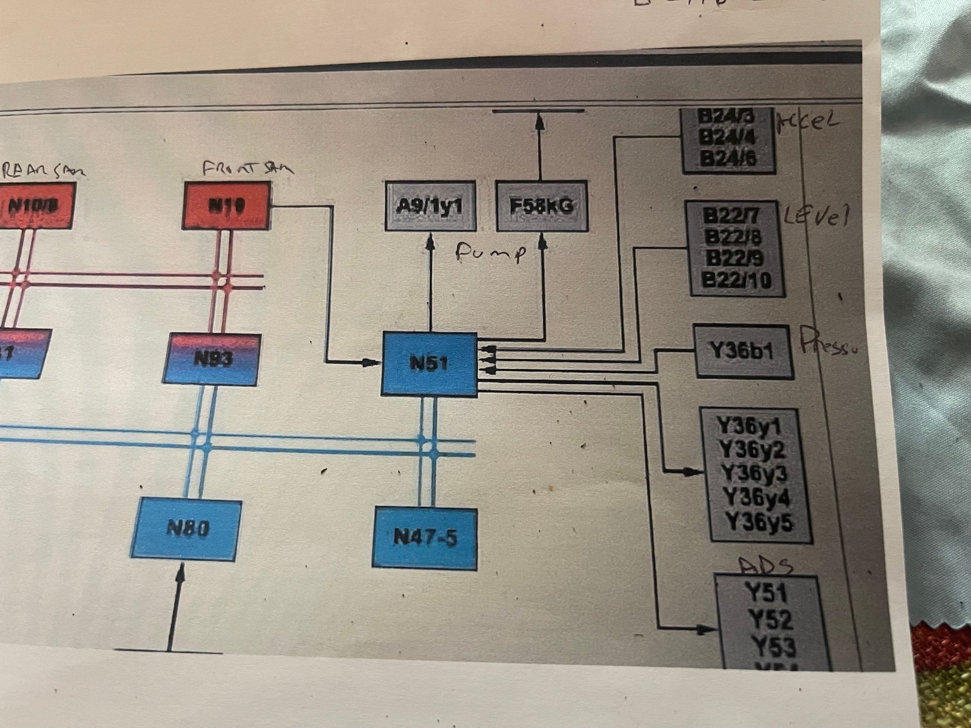

flow chart
The flow chart will show where ADS is in the system . it is very complex. thanks for info . ADS was a curveball thrown at me by a Launch 431 OBDII reader with bad readings .
The problem was solved with a level calibration set back to factory specs . Changing and variety of parts EVEN A COMPRESSOR can throw off the level calibration. Many will say NO i changed a compressor and nothing bad happened… me too. I changed a comp.. in two other vehicles with no issues. But the third one was trouble .
