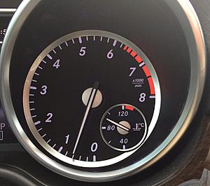

Quick question, since I got the car the coolant temperature on the car seemed abnormally high, but I ignored it as I thought it was normal. However, since then I've driven many many cars, and all don't go higher than half of the gauge.
On my GL, I'm always at close to 100 degrees, although other cars' gauge don't tell you temperature, but is this normal? I wanted to ask you guys before taking it to the dealership.
Old Apr 11, 2014 | 11:40 PM
Kenn1926's Avatar
Joined: Dec 2013
Posts: 121
2013 ML550
That's exactly where my ML550 runs...
Old Apr 12, 2014 | 12:24 AM
Dalema's Avatar
Joined: Dec 2012
Posts: 379
GL550
Looks good. My Pcar sits at 194oF
Old Apr 12, 2014 | 07:07 AM
mist68's Avatar
Joined: Dec 2013
Posts: 105
Carrera S;
2014 GL550; Same
Old Apr 12, 2014 | 08:15 AM
Steve Maislin's Avatar
Joined: Dec 2012
Posts: 262
From: Concord, MA
2013 GL450
Normal

Old Apr 16, 2014 | 08:31 AM
blittle's Avatar
Joined: Mar 2007
Posts: 1,653
From: Central Pa.
2013 GL450 (traded for 2015 Escalade), 2012 Corvette, 2014 Ford Fusion, Previous: 2007 GL450, 2011
Yup …. normal AND all should note , the temp gauge is NOT in farhenheit!
