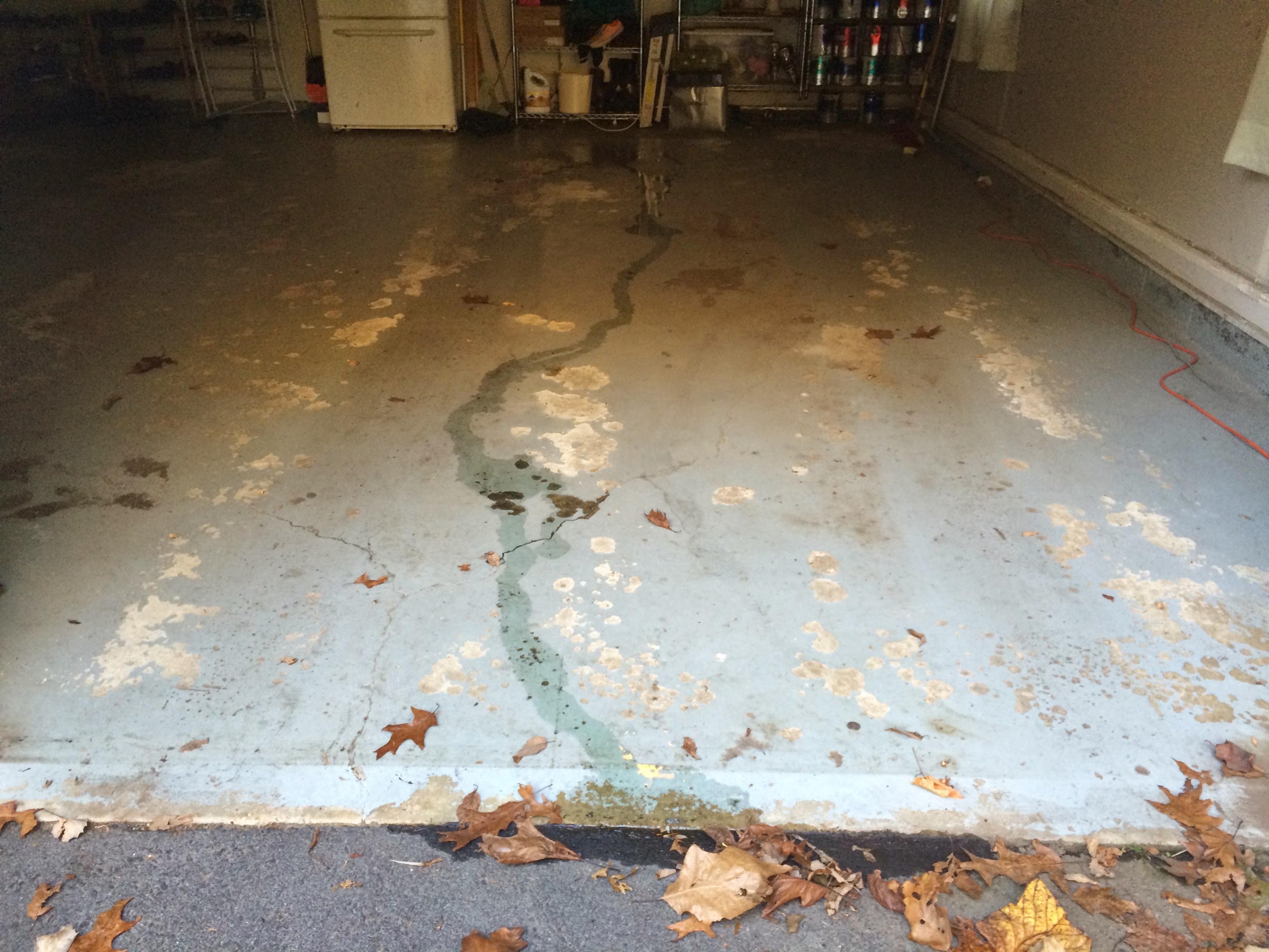

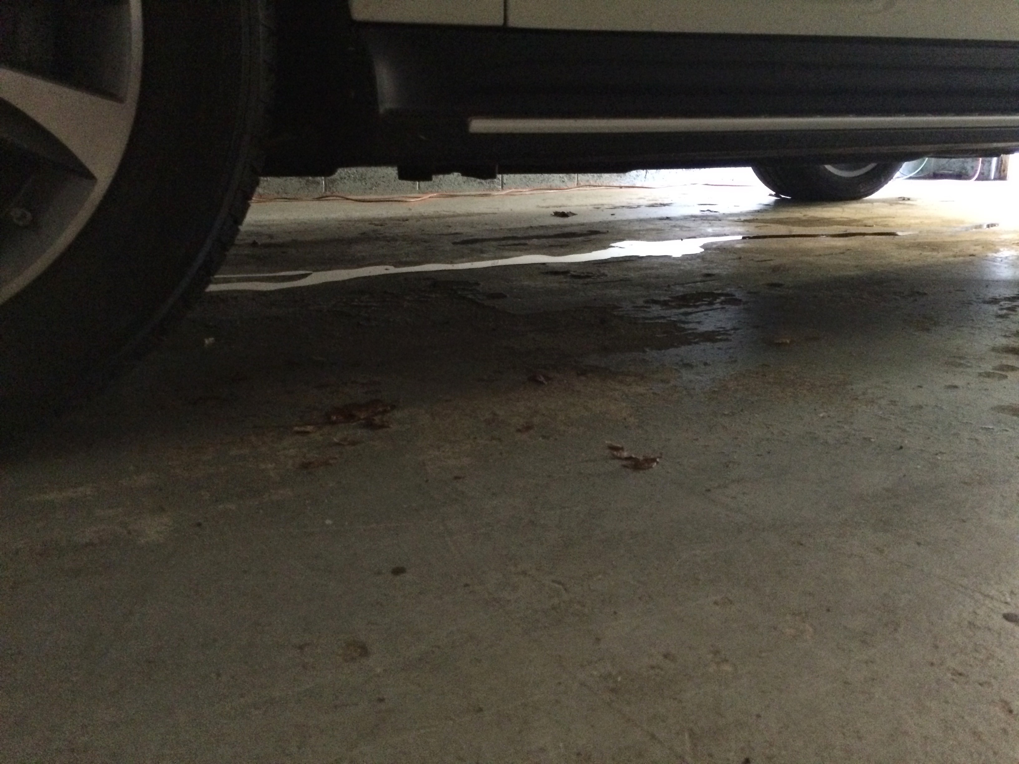

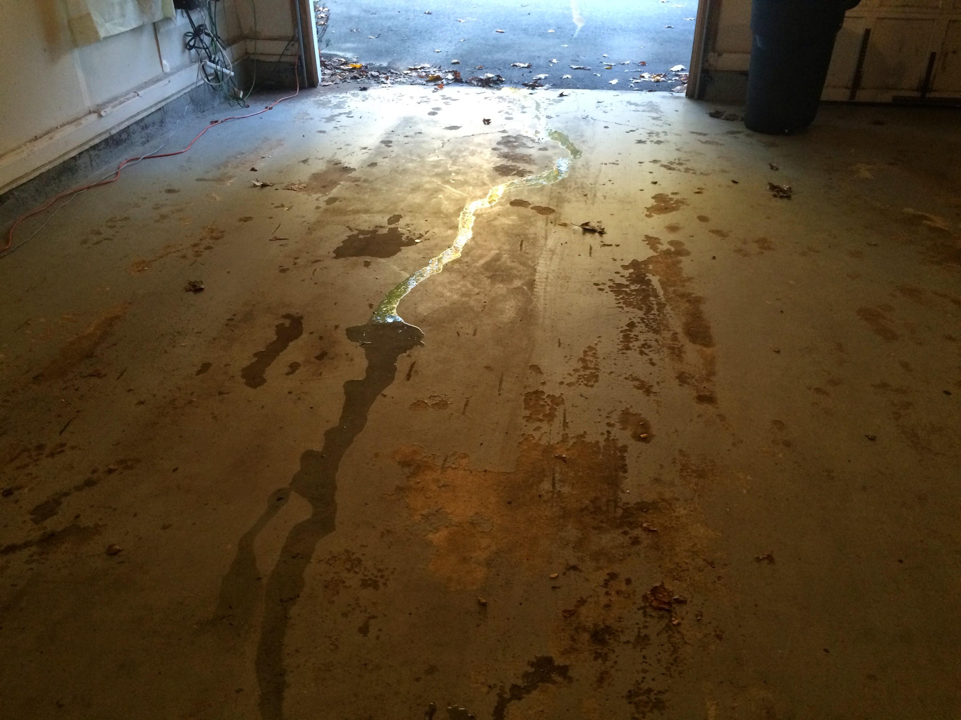

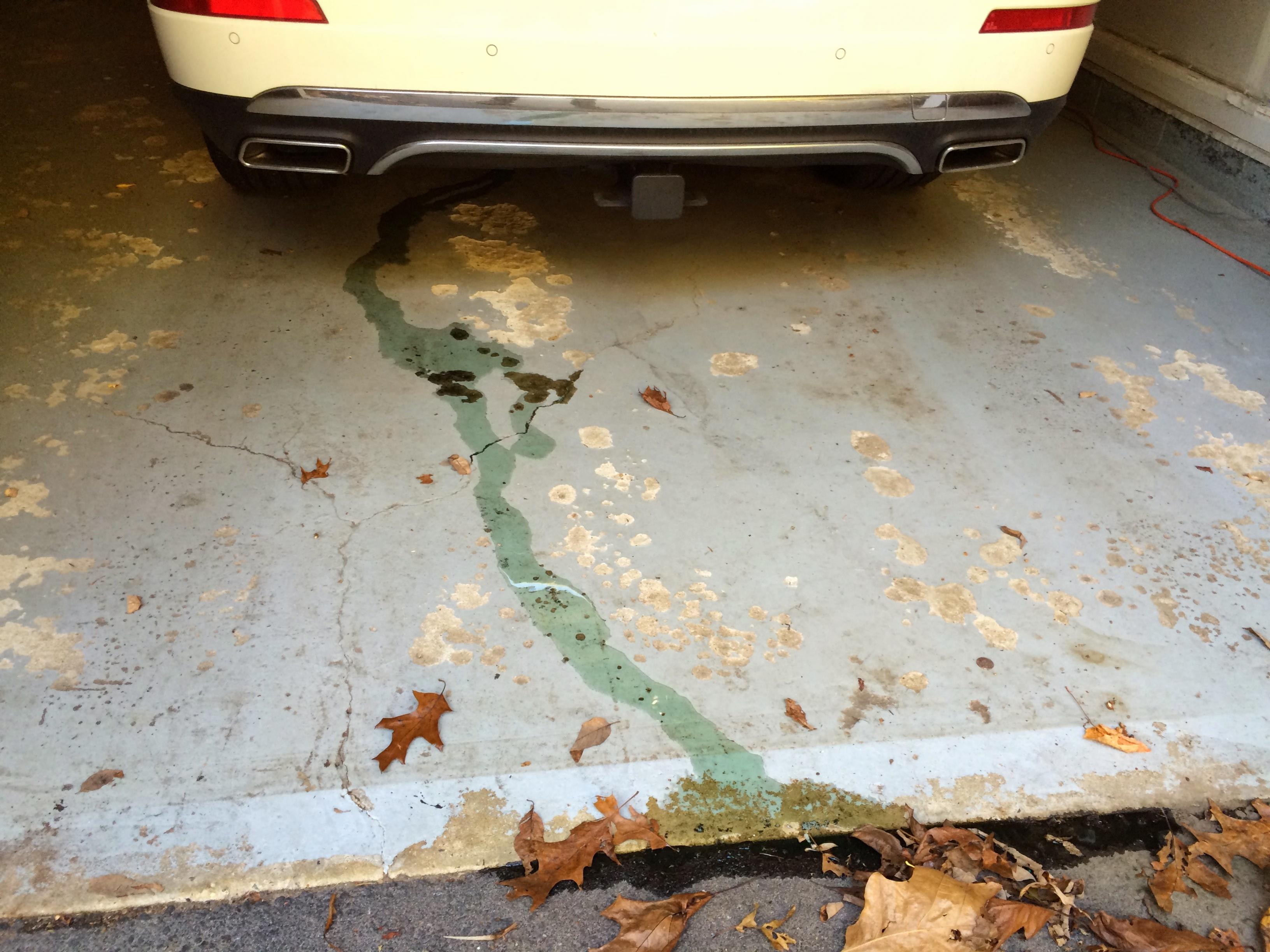

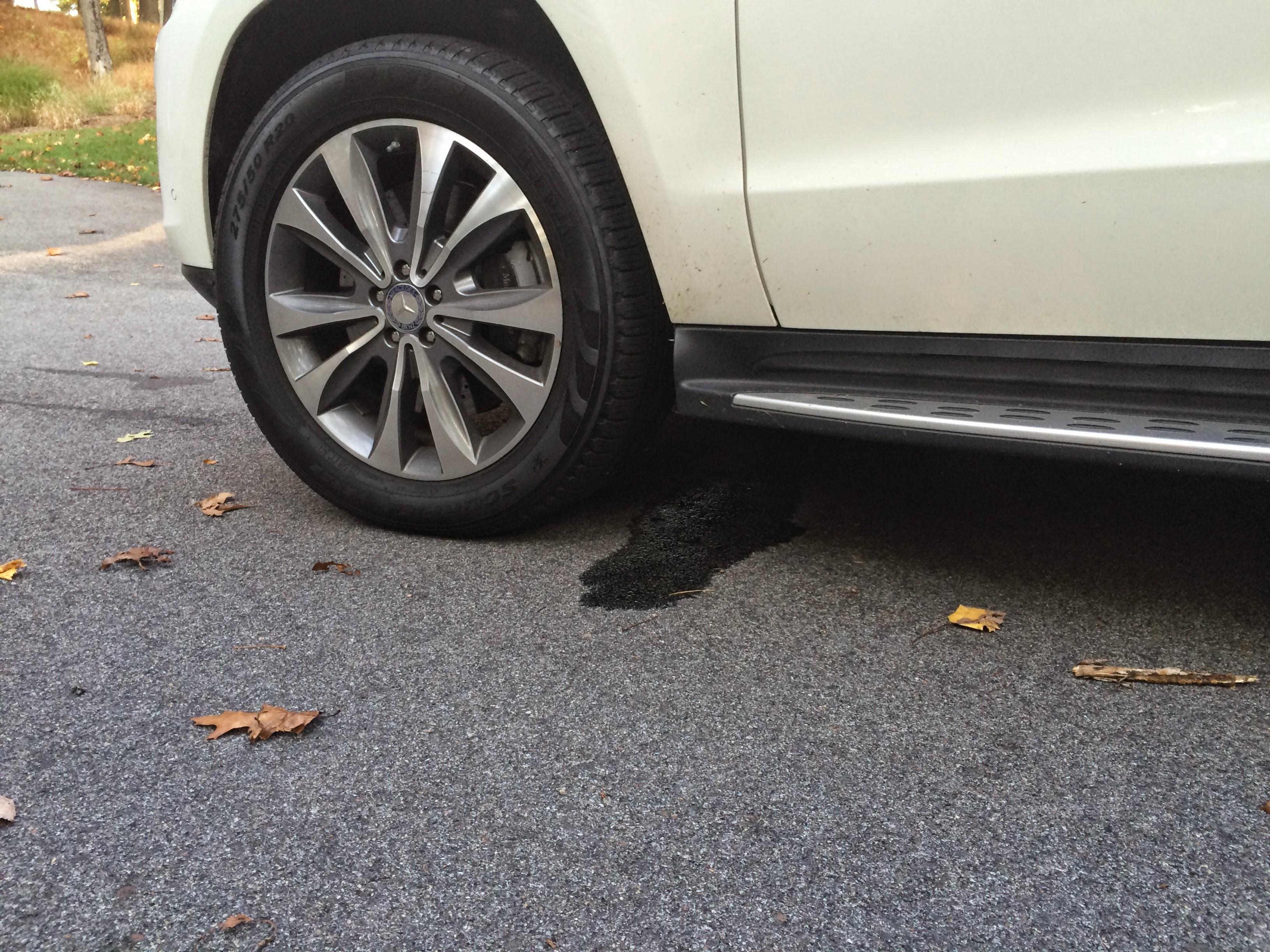

The dealer called and said that they spent a good amount of time today trying to figure out just what happened and that their tests were completely inconclusive. In the mean time, I'm stuck with two loaners: a '15 GL450 for my '13 GL450, and a '15 ML350 for my '12 GL450 (which was due for service, and we left there as that's the car we drove to the dealer while the other one was being towed). On a kind of irrelevant note that is also still relevant, I am really not a fan of the new V6 in the GL450 -- at least compared to the M278 4.6 liter V8. Interestingly, the dealer said today that they want to let us out of the '13 lease and allow us to get a new '15...it will probably end up being a GL550 now.
Will keep everyone posted. Ideas, comments, questions, etc are always welcome!
Also, check out the pictures I attached. It's not really clear, but there's a really big puddle of coolant (or whatever it is) right under where the reservoir supposedly is. Then we moved it outside, and same thing (more clear here).

Sure it's coolant - email the tech you're photos? Let us know what they find out.
Had you recently filled it - wondering if it was overflow after a hot run as it doesn't look like too much fluid.

Looks like water to me, completely normal.

No, I'm just assuming it's coolant -- it certainly could be something else. Emailing the tech's the pictures today. I haven't filled it recently. There's actually more that you can't really see from the pictures in a puddle (it looks like less than there actually was). It's kind of odd.

That's what I thought, but it's blue and smells like coolant. And when we turned the car's electronics on, it said something to the extent of "no coolant" and the engine wouldn't start. (I think I forgot to mention that before -- my bad)

Now we're cooking, yeah that would be a problem.
