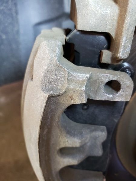

Great idea!! I just did it...unfortunately, the pads were incorrect, lol. Were upgraded brakes an option on these? The pads I got are too small but verified they're the right ones for a GL450. Looking at the computer at the parts store and starting to think maybe I need GL550 ones. At least, the little pic looks more like mine. Just a guess, though. (in the pic, the bottom hits just like the top...can't just push the caliper down):

After weeks of struggle finally closing the loop on my personal issues with this. Anyone else doing this job - if you have big gorgeous cross drilled rotors you may have AMG brakes. Different rotors, pads, mounting hardware that no other threads will mention, etc. And don't forget this little beauty...you'll also need the GL550 wear sensor for the rear, not the GL450 one.
