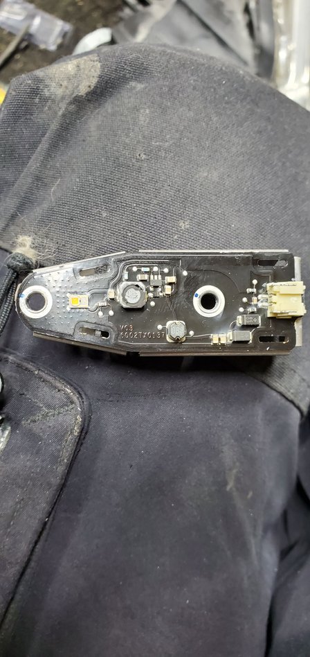

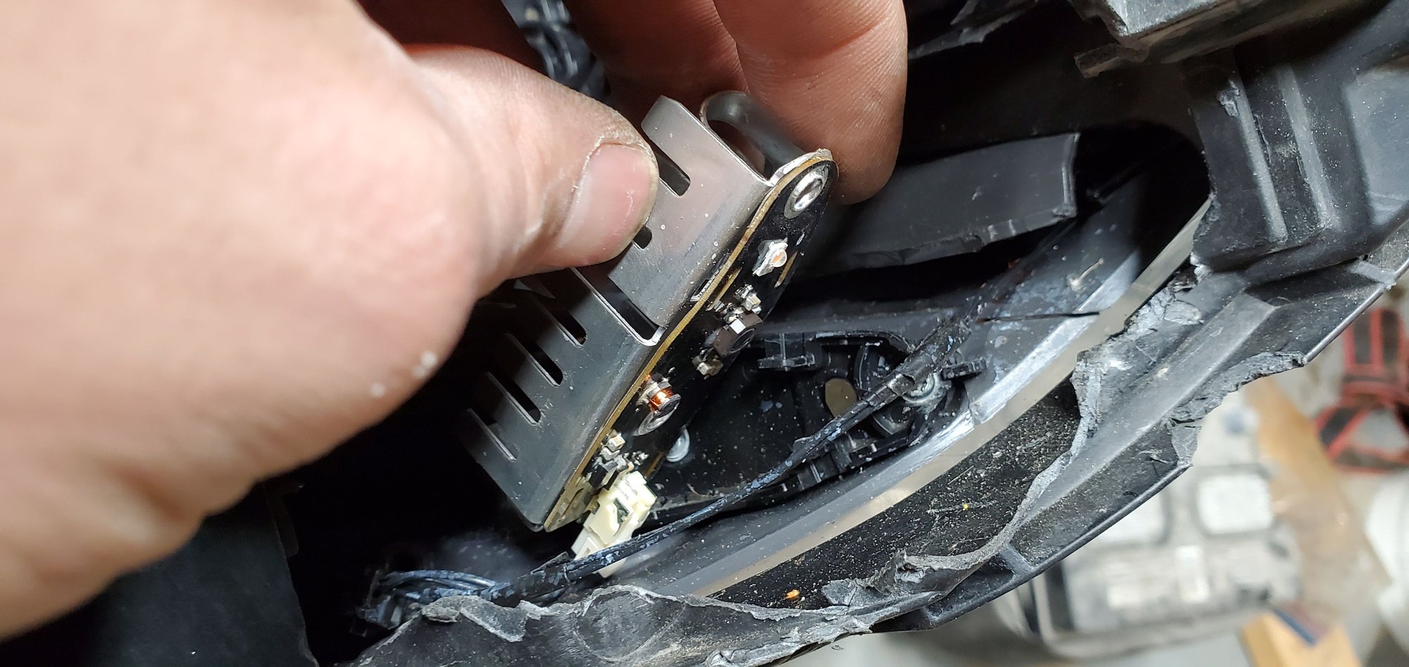

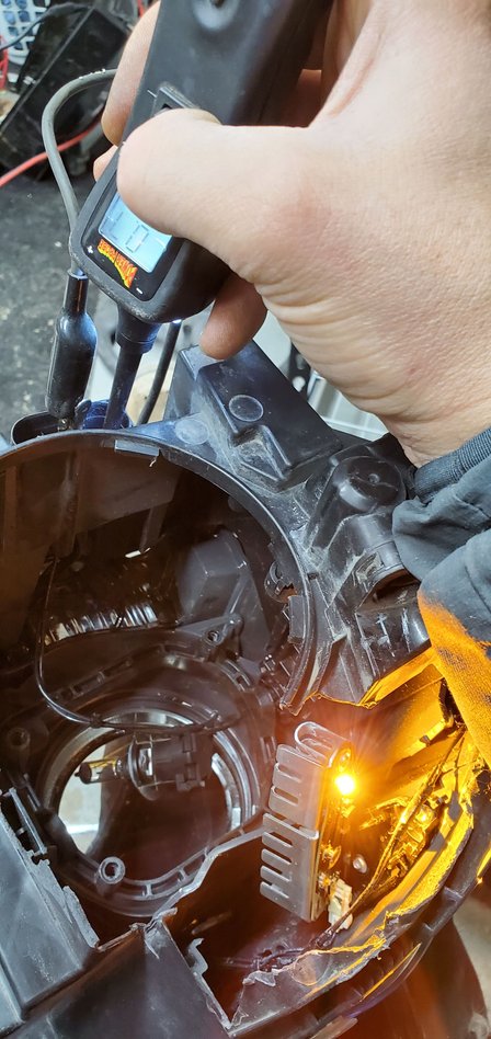

Hey. So I end up taking my old headlight apart to see how it works. There's a little yellow led light that turns on and shoots yellow light to that lens tube that goes across the headlight. I don't believe that you can change it to white by programming! Looks like this part needs to be replaced or that little buld needs to be replaced (resoldered) with different type. I'm still thinking if it worth it to take lens apart to do it. Will keep you posted! Thanks
Good detective work! If you ever figure out a way to change it white let us know!
