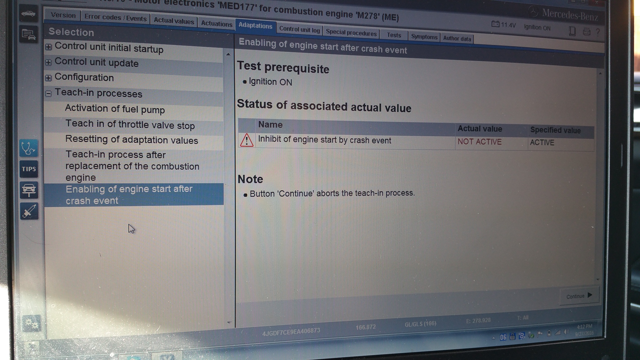

Today I have a W166 GL450 2014
This vehicle was involved in a frontal accident, but no airbags deployed except ETR,s.
Engine will not turn due to a inhibit of engine starter.
I found the "start enable", but no arrows or options. Just indicates that pressing"continue" will abort the process. No process is started..
Any clue why?
How is the process to re enable starter? any alternative way to do it?
Software version 9/2016
Also try before with 5/2016
Thanks

My guess would be a pyrofuse blown, Not uncommon today.
You can try jumping power to the starter solenoid directly ... carefully... but not recommended.
