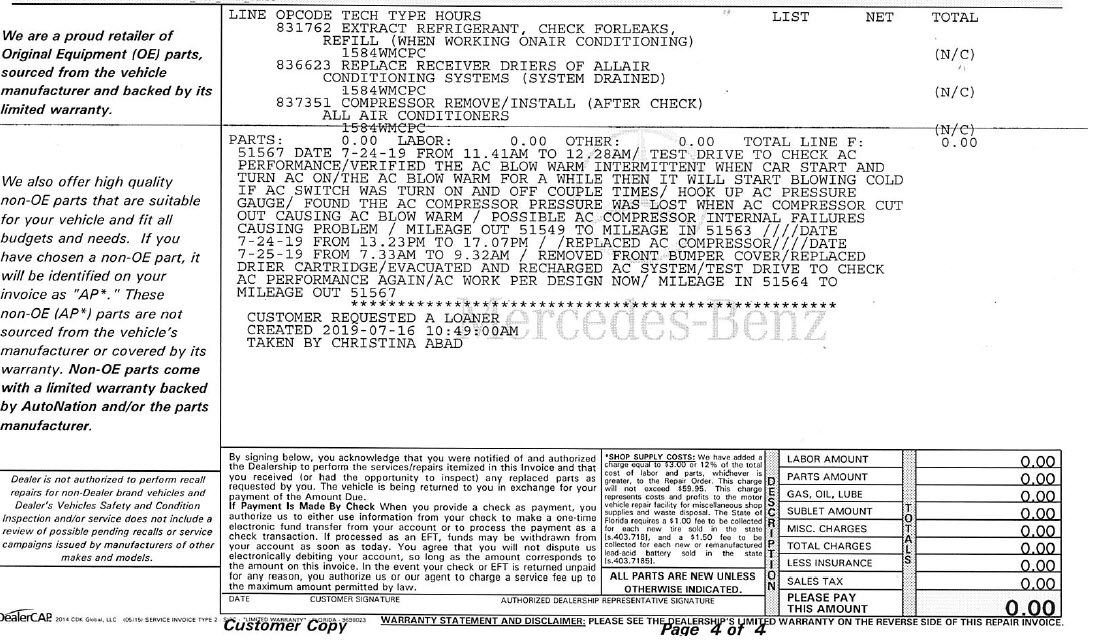

Well, the family started to complain about the AC situation in the back seats too so we took it over to MB. Service tech said the AC compressor is malfunctioning. He indicated that it goes off and on, it starts to cool and then normal air. As any MB part goes, they have to be ordered. He also stated that it's a common part to go out in the GL in the hot warmer climates in the summertime, he's done a lot of compressors recently. There were 3 other GL's in the line with A/C issues.

Absolutely, the beast is waiting at MB for the compressor to arrive. Once it's done and installed, I'll post the service record. Funny, I'm in SE FL.

I picked her up the other day and man does it blow cold air, what a difference. I guess it stopped working a long time ago, never paid any attention but, it does cool off much quicker for such a big cabin. I would say in less than 5 minutes the entire GL is cold (depending on pre-set temp).

Got a Voicemail from my dealer ... "we found out what the problem is ... we've got an evaporator coil on order and it should come in on Thursday" .... hmmmm will be interesting to see the details of the service ticket ... will post some details ....

Hmmmm ... wasn't what I was expecting ... 2 days and man she's cold, consistent, 2nd and 3rd rows cold too ... keeping my fingers crossed that she lasts as long as "Austin" (my ride's name) ...
AC NOT BLOWING COLD EVAPORATOR IS LEAKING RAN LEAK TEST AND HYDRO SNIFF TEST AND WOULD NOT HOLD VACUUM SNIFF TEST ALERTED AT THE EVAPORATOR PULLED DASHBOARD COVER LOWER LEFT DASH BOARD COVER GLOVE BOX COMMAND CLIMATE CONTROLS CENTER CONSOLE PASSENGER SEAT PASSENGER CARPET REMOVED DASH SUPPORT BAR DROPPED THE STEERING COLUMN A PILLAR TRIM REMOVED AIR CONDITIONER HOUSING TOOK EVAPORATOR OUT OF HOUSING LEAKED TESTED NEW EVAPORATOR INSTALLED IN AIR CONDITIONER HOUSING AND INSTALLED IN REVERSE ORDER RAN LEAK TEST AND VACUUM TEST HELD VACUUM AND PASSED LEAK TEST FILLED WITH REFRIGERANT AC FUNCTIONS AS IT SHOULD WITH NO ISSUES INSTALLED WIPER ASSEMBLY AND COWL RAN SDS QUICK TEST NO FAULTS
