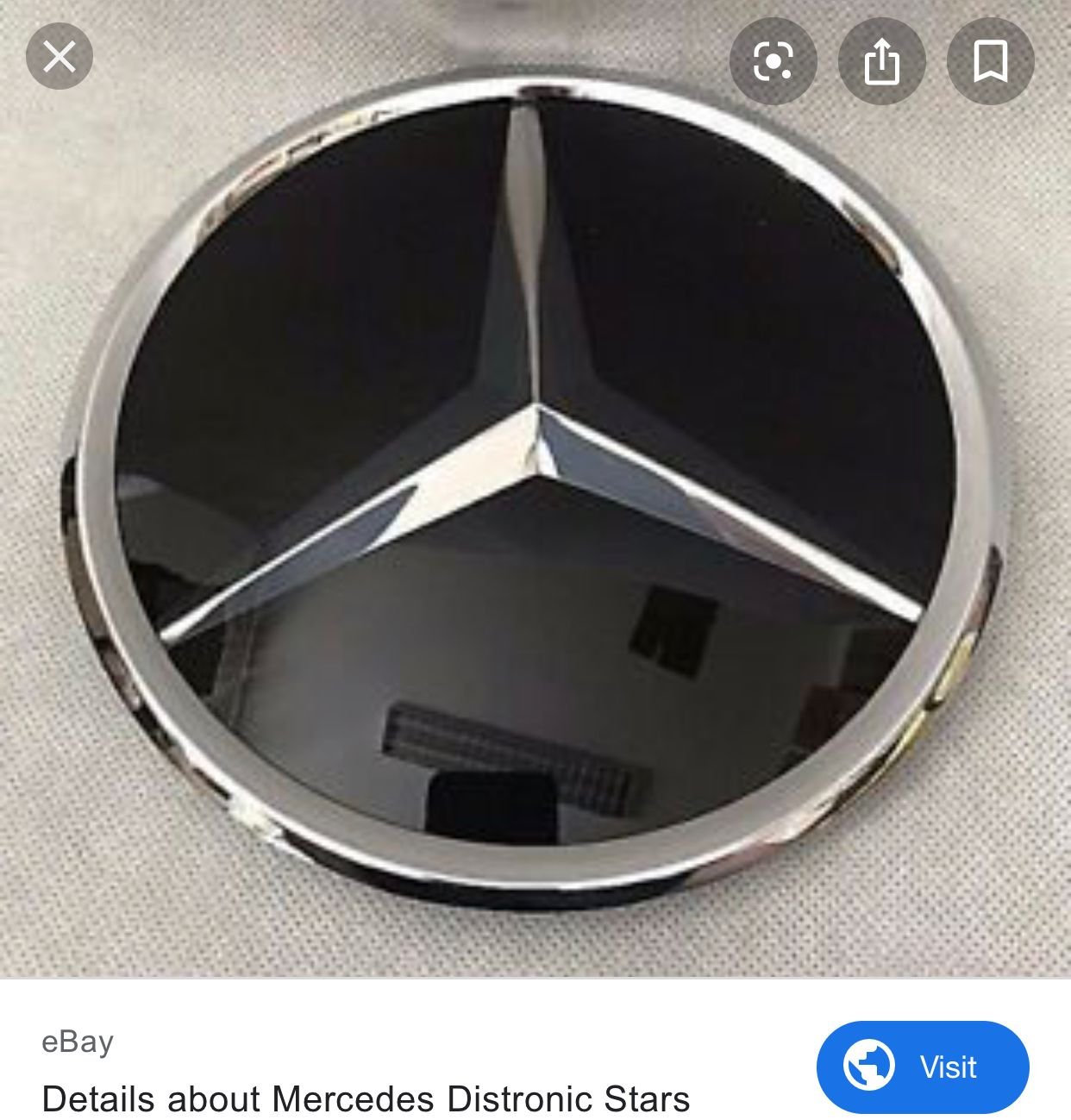

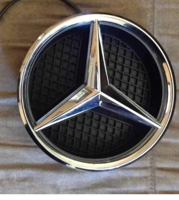

Two ways to tell if car has it from pics or VIN
star on grill is solid gloss plastic and not mesh between the star
Distronic
No Distronic
use datamb .com and input the VIN of the car you are looking the at and find option code 266.

Thank you so much! You are very knowledge and that was just the answer I was looking for!!
