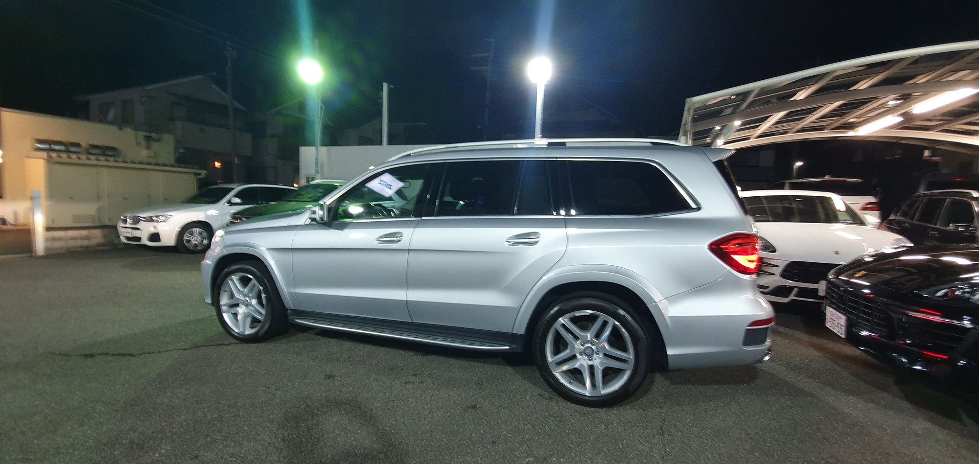

Hello,
I would like to purchase a set of 4 wheels with winter tires for my GLx166 (2013)
Currently i have 295/50/R21 summer tires all year round. But this winter I am planning to go to mountains where it snows.
My question is - what rims can i use so that i do not need to add spacers and buy another set of bolts.
1) Can I use wheels/rims from M class?
2) Can I use wheels/rims from S class?
3) is this a good option? 235/55R19
https://page.auctions.yahoo.co.jp/jp/auction/d384833110
4) is this a good option? 295/40R21
https://page.auctions.yahoo.co.jp/jp/auction/g380227201
