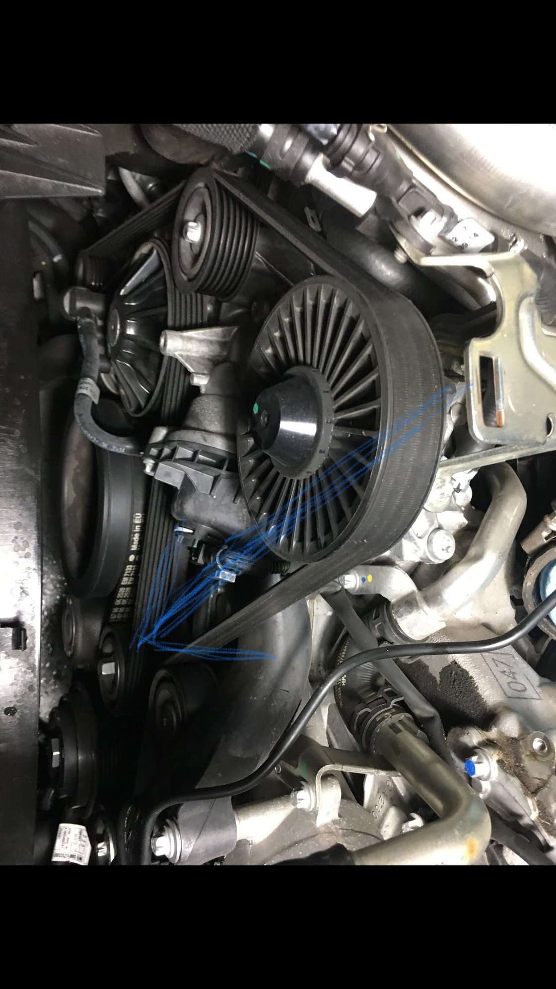

Where is the tensioner release? I can’t locate it at all. Everything online shows the x164 where it is very obvious.
this is the 4.7l v8. 2015 gl550

It's at the 4 o'clock position, immediately adjacent to the crankshaft pulley, when looking at the engine from the front of the vehicle. It's the lighter colored roller in your photo.

Is the blue arrow the correct pulley you are referring to?
Where is the bolt to adjust the tension? In the x164 videos I’ve seen the bolt to adjust tension is between the crank shaft and the tensioner but there is nothing there on my car.

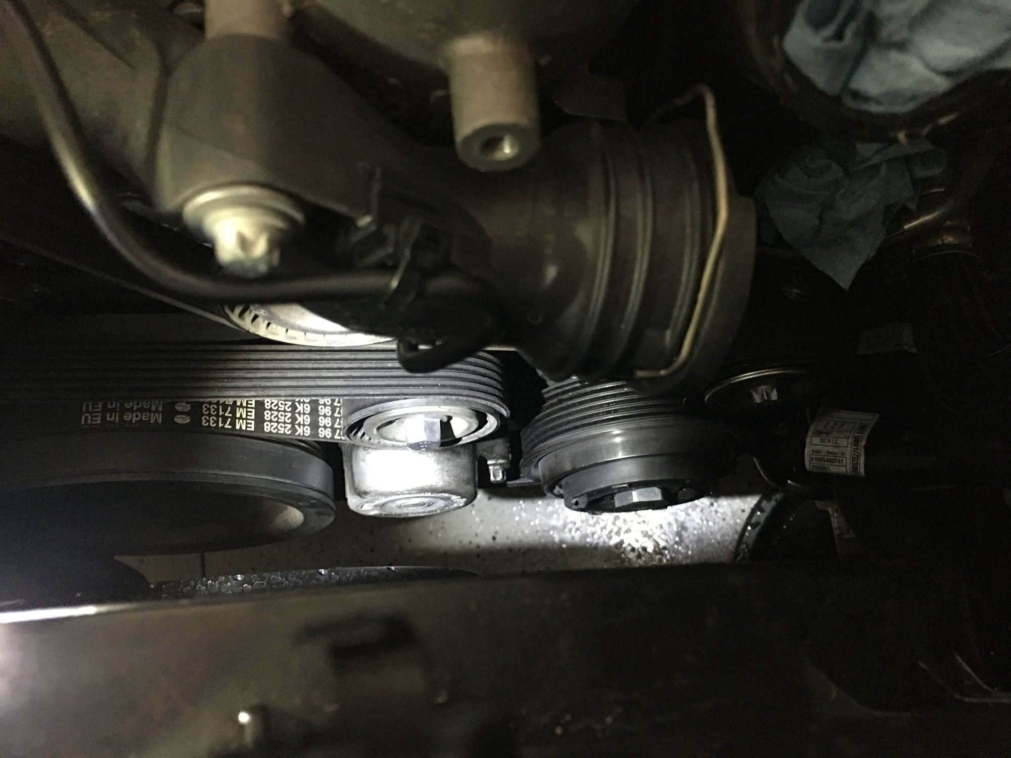

Here is zoomed in picture of that pulley which I think is the tensioner. How do I release tension?
thanks in advance.

The picture with the blue arrow is the tensioner bolt. It’s dead center on the tension pulley unlike the previous x164 models.
