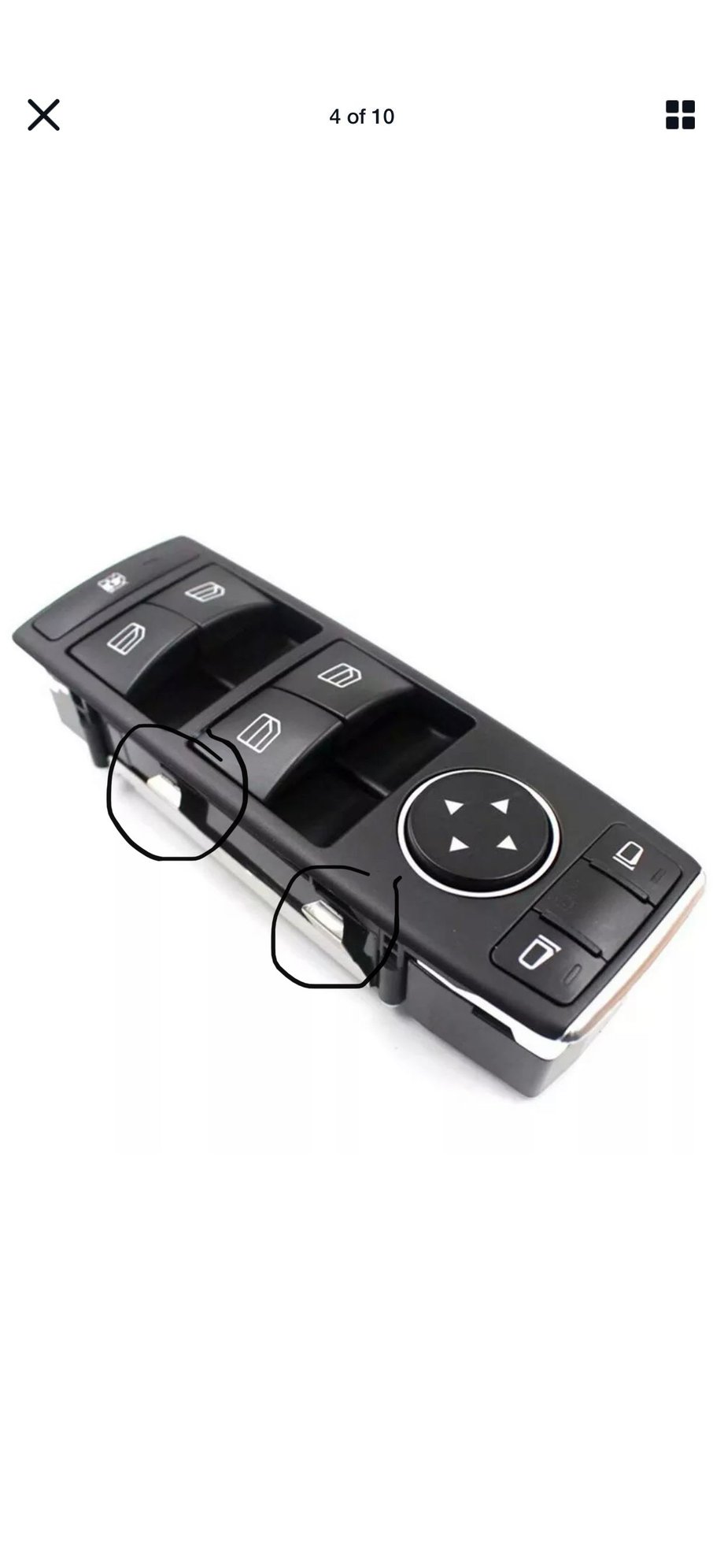

It held in by metal clip on side but not sure you can remove them without taking out the panel.

Old Jun 15, 2020 | 03:04 PM
iisnoopyii's Avatar
