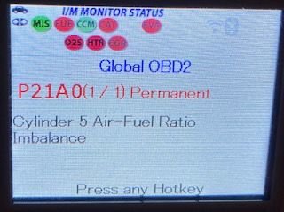

GL450 OBD Code P21A0 - Cylinder 5 Air-Fuel Ratio Imbalance Reply Subscribed
I have about $3000 in two different mechanics trying to solve this code. I am not sure they are even looking in the right direction. Any help would be appreciated for ideas. I have researched the internet and found very little and explanations are all over the place. I live about 2 hours from the nearest MB Dealership so hoping to find just a good import mechanic that might have some luck. This is a 2013 GL450 with 79,000 miles. It has a rough idle but gas mileage seems consistent. Very well taken care of, all oil changes regular and filters.

I would start throwing sensors and parts at it, in generally this order:
O2 sensors, all 4 of them
Mass air sensor
spark plugs if not done at 50k or 60k miles
coils and boots all 6 of them
cam position sensors all 4
Old Mar 22, 2021 | 09:25 PM

Check compression or leak down on that one cylinder.

Thanks for the advice. Will try these.
