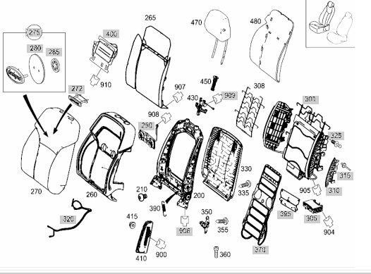

WIS doesn't seem to have a procedure for this, and EPC suggests the head restraint is a complete assembly, not available as individual components. It would be interesting to know if you took it to the dealer and they told you the solution is a new head restraint.
If the above is the case, I would look for a way to remove the bezel surrounding the button controlling the head restraint fore-aft movement. If you can get the bezel off, the button will likely come out, and maybe you can see inside or pry something free with a long thin screwdriver. Think of wide flat trim lever tools to remove the button bezel, prying gently and firmly on both sides of the bezel with two trim levers.
Item 470 in the diagram.

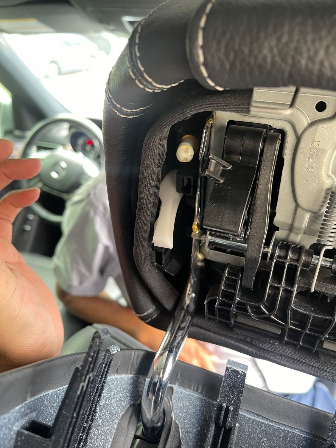

Solution to Fix the Stuck Headrest
I've had this issue with the stuck passenger headrest for 3+ years since I bought the vehicle (2nd Owner). I've searched many times on google and the forum for a solution but have read various conclusions (Cannot be adjusted, the button is for aesthetic and not functional or that it needed to be replaced).
I attempted this fix and was able to resolve.

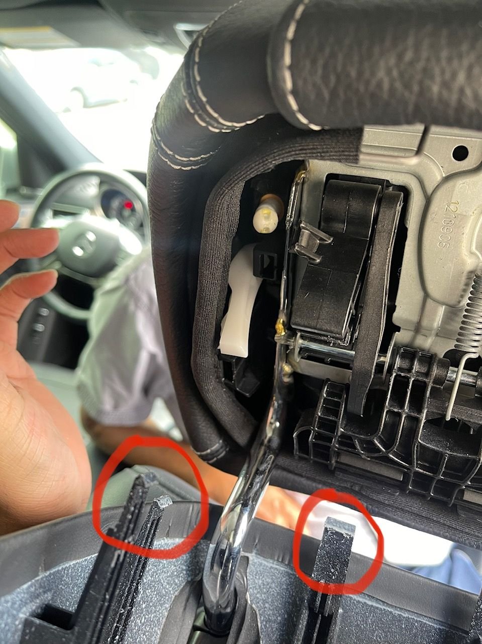

Plastic Shell Removal
- Raise the headrest up.
- Sit in the middle seat and pull the plastic shell from the bottom towards you.
- There are 7 clips holding the plastic shell: 2 on the bottom, 2 on the left, 2 on the right and 1 on the top. (See picture for reference of a few clips)
- The bottom and side clips will unclip by pulling.
- The top clip is a bit hard to get to and you will need a long screwdriver or trim tool to push up on the clip to unclip. I ended up breaking mine as the clearance is very small to work in (Note that this did not affect the plastic shell from re-attaching), see picture for reference
- With the shell off, keep it to the bottom and you can proceed to the fix.
Check Functionality of Side Button
- Press the side button and confirm the white tab moves down when pressed and returns up when you let go. (See picture for reference)
- You will see the white tab pushes down on a catch where the headrest moves forward and back.

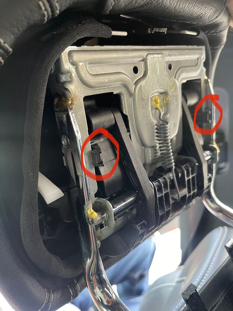

Fixing The Issue
- On the 2 sides, you will see the black plastic part with the adjustment teeth, there are tabs that should be sitting on the back side to metal frame to stop the all the way forward position. (I didn't take the picture of my situation but reference the picture to see the 2 tabs circled)
- In my case, those 2 tabs (I would refer to them as stops) were past the metal frame and this prevented the headrest from moving back.
- Using 2 screwdrivers, gently pry the 2 sides in so that the tabs can be on the back side of the metal. (See picture below with the 2 tabs circled, this is how it should look)
- Tested with the side button and the headrest moves forward and back with ease.
Clip the plastic shell back together and you are good to go.
See attached pictures for reference as well.

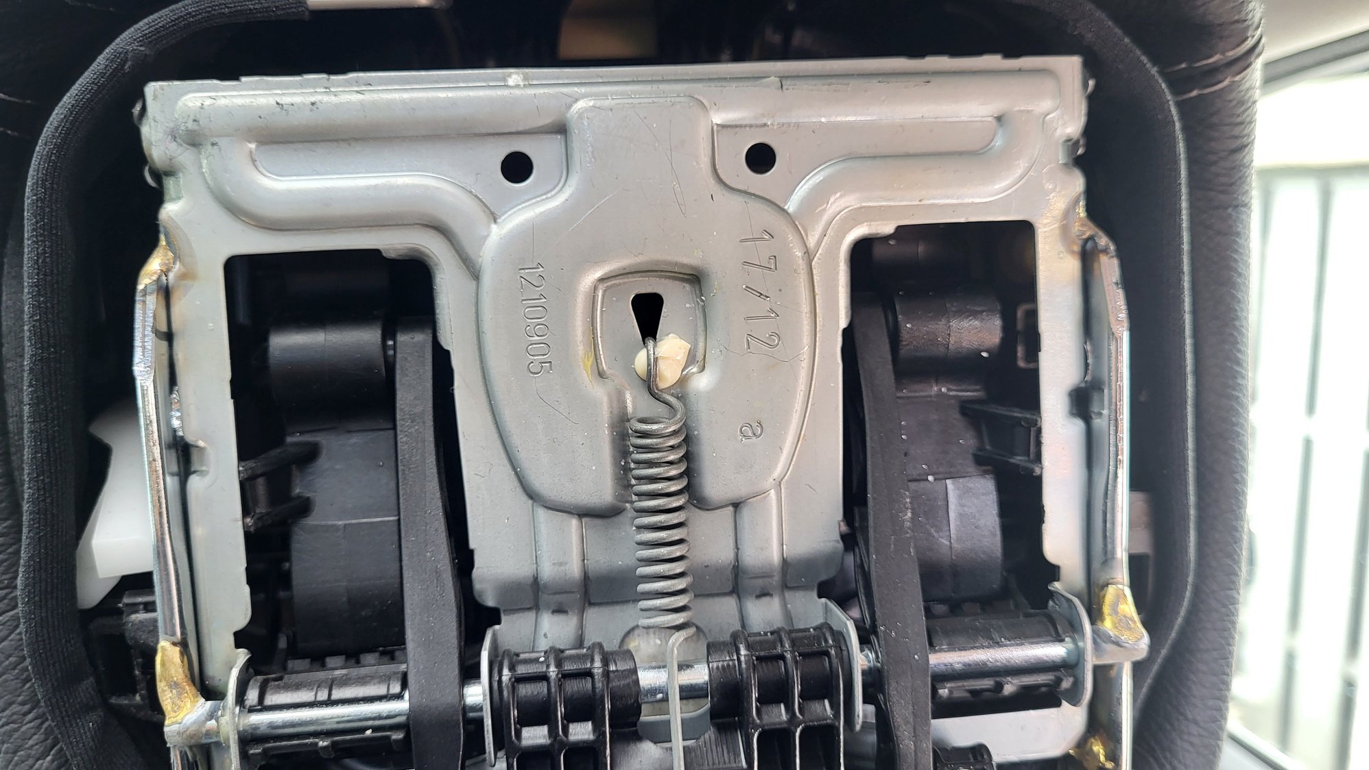

Here is what it looked like as broken:
