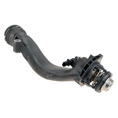

So I pulled the thermostat
When I did the guts (spring and actual thermostat) stayed inside the water pump, the only that came out other than the tube was a long pin that goes inside the thermostat.
Is this normal? I was able to stick the long pin back into the thermostat itself and tighten down the bolts without any binding or misalignment. Is it ok or should I replace it?
Chad
Old Nov 6, 2021 | 09:28 PM
arsupisemnet's Avatar
Joined: Jul 2019
Posts: 733
Likes: 298
From: New Orleans
2014 GL450, 1992 W140 300SD, 1993 W140 300SE, 1987 E30 Convertible
Start your car and wait for it to get hot. If it will start going above 90 degrees you need to replace it. Normally it is suppose to be together but with time plastic locks holding all together got broken ones you try to pull it out.
Central pin is a heating element for forced cooling (then you floor engine really bad it forces thermostat to open and circulate through radiator to keep engine cold)
