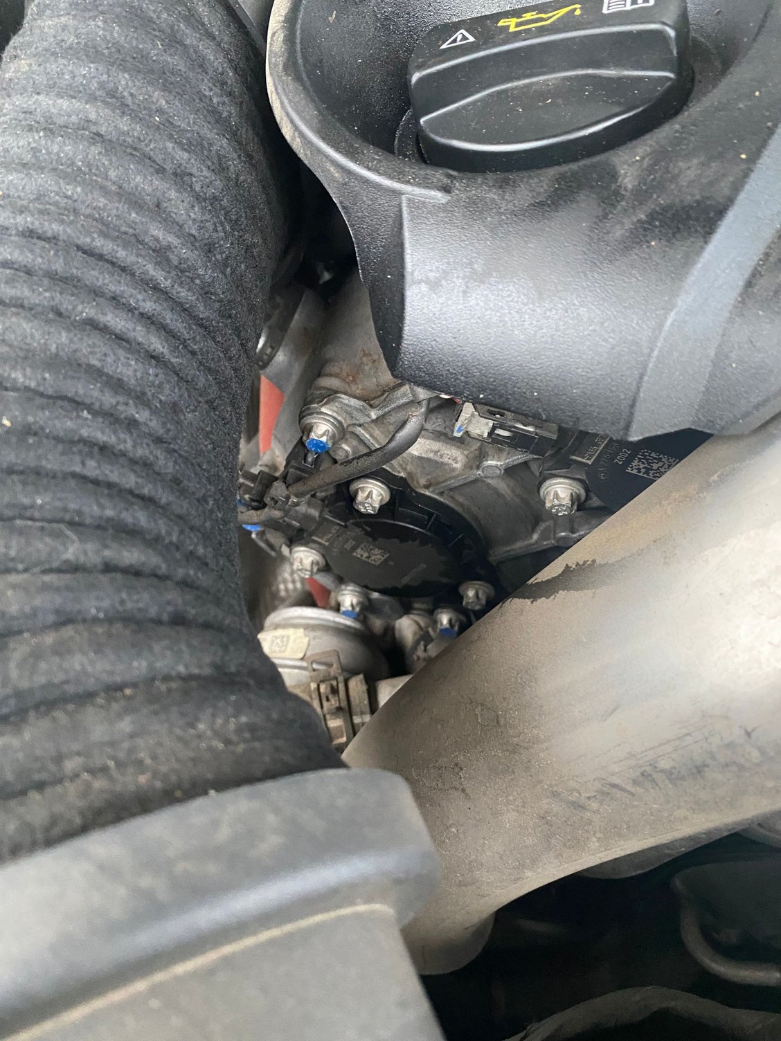

Noticed this on my passenger lower cam magnet. I thought at first it was from me adding oil sloppily a few weeks ago, but now doubt it due to magnet location and seepage appearance. Time to replace cam magnet?

Just replace 4 oil rings 0169975045

Common on M278, M276 and M274 engines.
