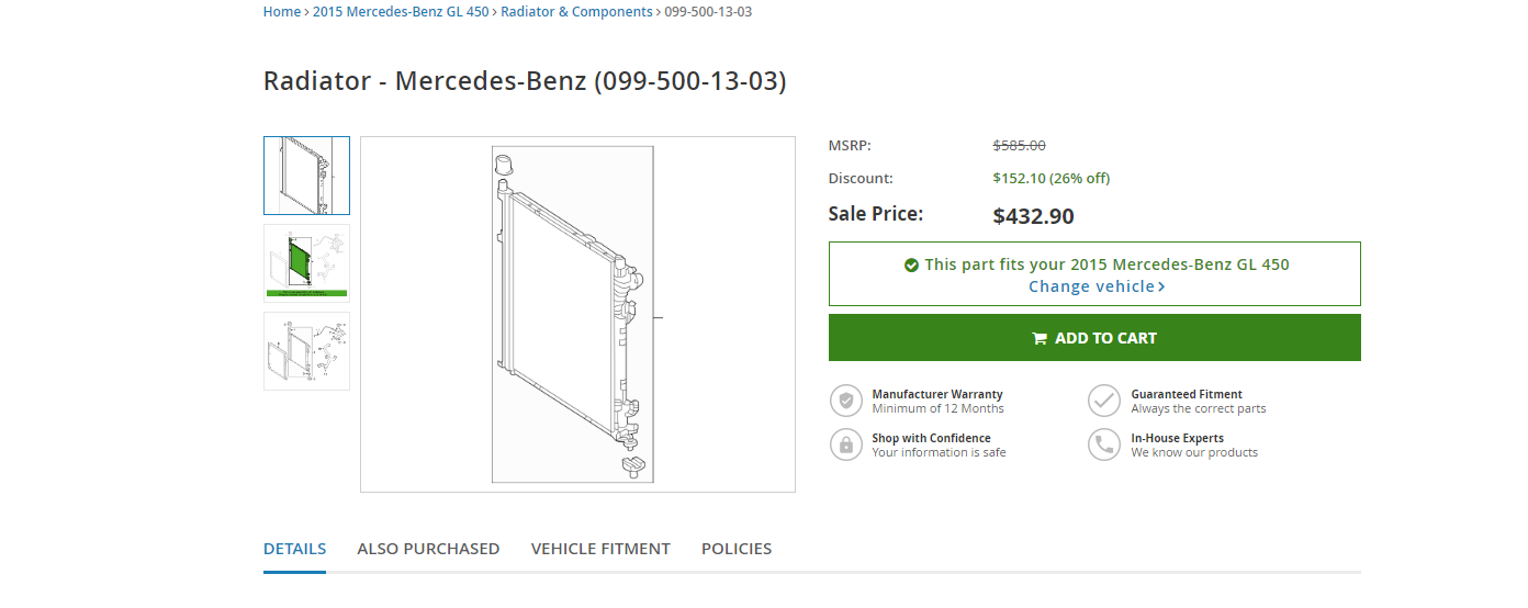

Hello,
i need part number this attached photo,
How to solve this problem?

i think need this parts only ?

You need a new radiator. You have the characteristic cracking of the plastic mounting lugs holding the radiator to the body structure. Not repairable. Not replaceable.

can you tell me what replacement part number ?

and need new radiator ?

Yes, a new radiator

what need my car , pleasee see atach photo

A 099 500 13 03
Confirm using your VIN and call a local MB dealer.
