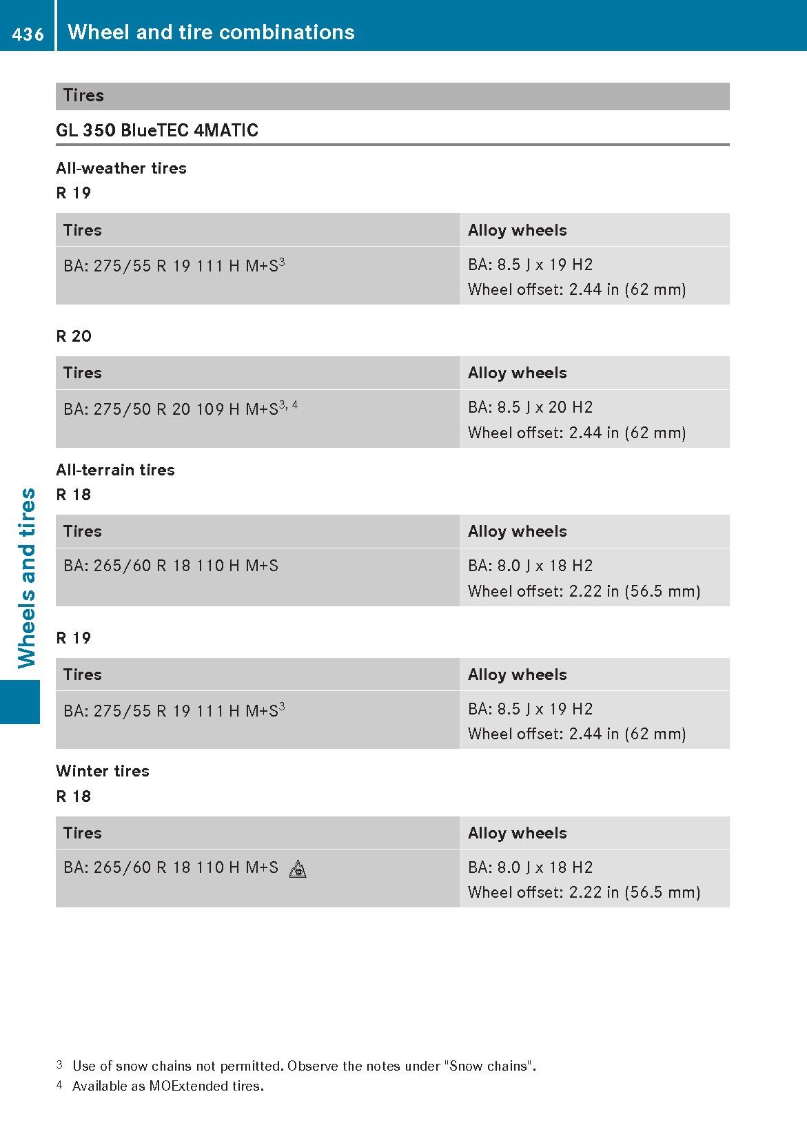

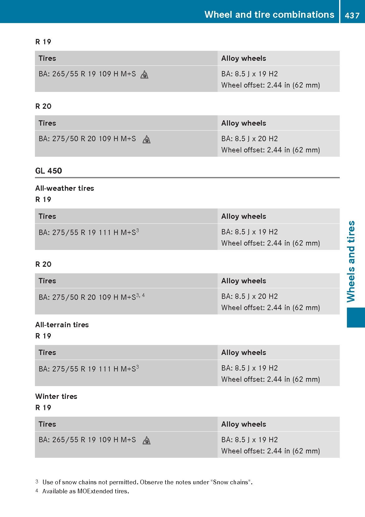

Directly from the horse's mouth (the manual):

Thank you w220430,
I just got off the phone with the service dept at my dealership and they confirmed that any of these packages are good to go on my vehicle.
His 2 cents are to go with any of these narrower profiles for better snow handling.
I had a lead on some beautiful OEM AMG 21 wheels for $500 canadian dollars that were tempting me but I will pass and keep looking.
He said yes, the aesthetics will change with the wheel backed under the wheel arch by and inch but there will be increased life for the wheel bearings and stick to the stock rim and tire combinations.
Others on the forums that were very happy with winter 295/40R21 wanted to keep the look of the vehicle and dry/wet performance.
The MB service tech also said some dry handling will be compromised in favour of snow performance with smaller wheels and the contact patch is moved inwards but it is within spec.
Before I spoke with the service dept, i spoke with parts and they had no other wheels listed and no other tires available than the stock perelli size. I started asking questions before they passed me off to the service tech who was very helpful.
