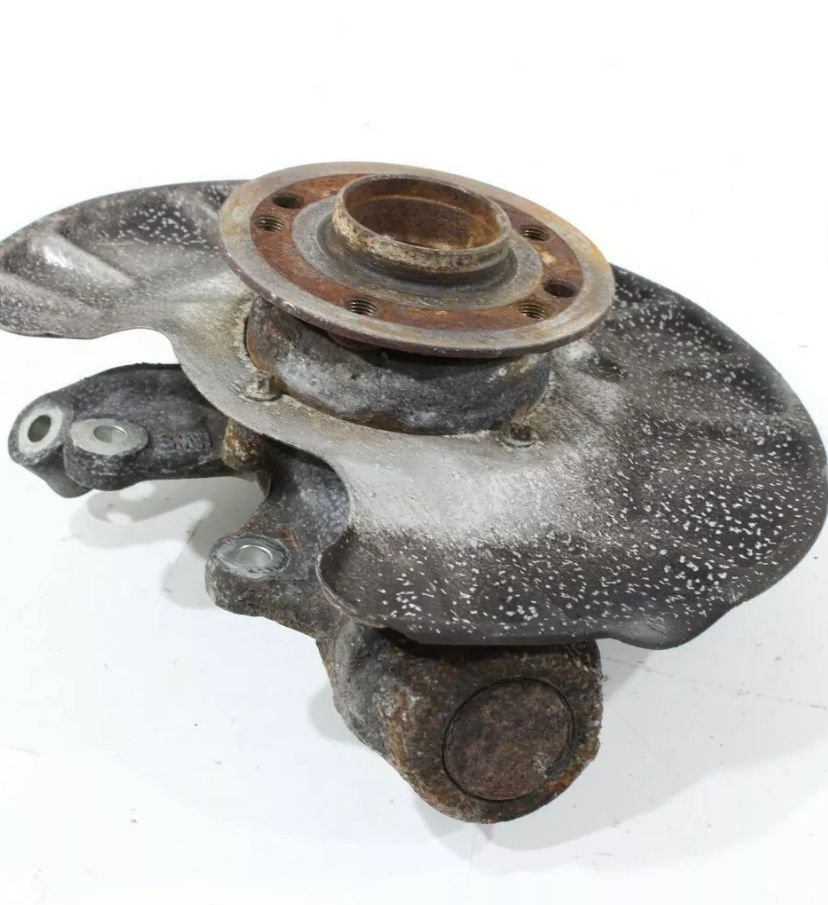

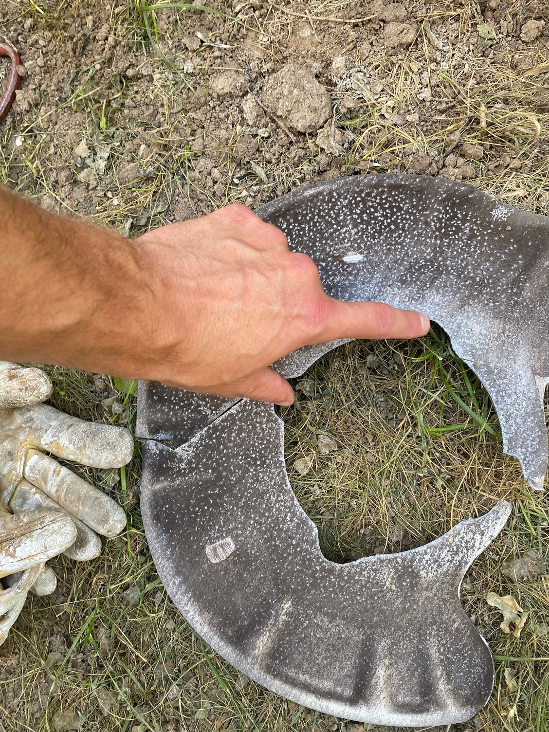

I noticed a metallic tinging sound from my left rear wheel last week. After digging around I discovered it was the brake splash guard/shield aka backing plate that seems to have worn itself away at all of the bolt locations which would retain it and hanging freely from the hub/knuckle. I ended up cutting it so that I could get it off. The only other way would have been to remove the rotor and hub.
Has anyone else had this issue?
Below are the picture of what mine looks like (after cutting it) as well as a picture of a used and assembled knuckle to give you an idea of what it should look like.
