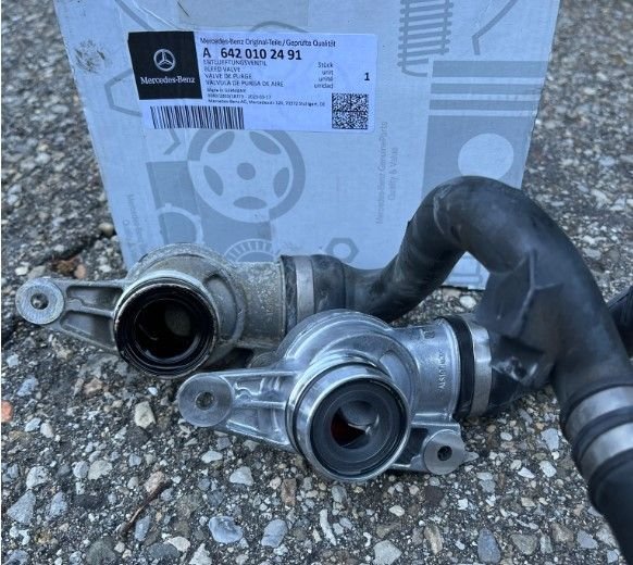

I had to add 1L of oil 8K miles after my last oil change due to low oil warning message. This is the first time I ever have to do this between oil changes.
Upon further inspection, I noticed the following:
- I had same greasiness like the picture from OP
- air intake to turbo area is very greasy due to oil leak
- CCV tubing to intake very wet
I ordered CCV from FCP Euro and just finished installing it. Below is a pick comparing old and new CCV showing the enlarged center hole of the old vs new, which allowed oil to get sucked in to the intake.
I then sprayed this to the CCV hose port in the air intake while the engine is running until the can was empty.
