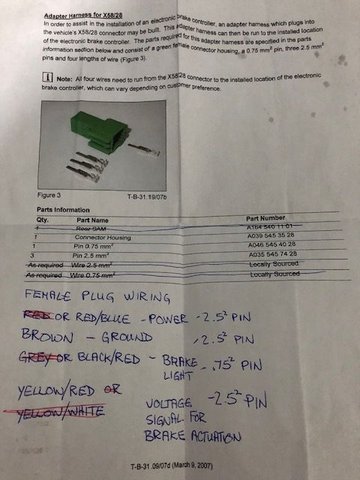

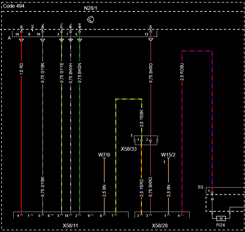

I plugged a Tecumsa brake controller into mine and no brake signal coming into the connector for some reason. Dealer no help at all, provided a “typical” wiring diagram, not specific to my 2014 GL550, below.
interested to learn of your experiences.

I have an ML not a GL but I do have the trailer package with the green connector under the carpet as you mentioned. Plugged in a Prodigy brake controller and it worked as expected with zero issues. If you have the green connector, the proper adapter, and a trailer brake controller, you should have everything at the trailer electrical connection WHEN A TRAILER IS CONNECTED. The car is smart; it won't energize the rear socket by the ball hitch until it knows there's something there. IIRC, YMMV and all that.

Yes my controller works fine when towing. Do you have the factory trailer package on your vehicle, code 550? Why do you think there is no signal, check your fuses, I seem to remember mention of blown fuses causing problems, I think that fuse block is under the second row seats. Also is your controller set up properly? Lastly you may need your rear sam unit reset by the dealer.

This is the controller I bought along with their universal pigtail and hooked everything up according to the pictured wiring codes. the little knob is my brake control.

Bob, possible to get better resolution to read what is in bottom right corner within “wire desc”?
same for this doc - would like to read what it says in 1st paragraph. Thank you!
Controller works fine on my Rv pulling trailer so that part is ok. Leaves the interface 4-wire harness between MB green connector & brake controller + fuses + possible rear SAM reset (not sure why a reset would be in order but this is MB so logic not always whatcha think).
Lastly, will find my build sheet for car & report back on option 550 factory trailer wiring pre install. Cheers

Sure, no problem. There are some posts on this site that address your problem. I just read one from 2019, lights work no brake, the problem was a blown fuse. Others have had other issues which were corrected by having the sam re-calibrated. I don't understand, you said no brake signal but your rv towing is fine. Like Rapidoxidation said it is a smart system, nothing is active until you plug into the socket on the hitch

Do a "trailer wiring" search, lots will pop up. The sam reset usually has to with the issues involved in adding a hitch. There were issues with earlier MB's and newer Trailers but that has all been resolved by MB.
