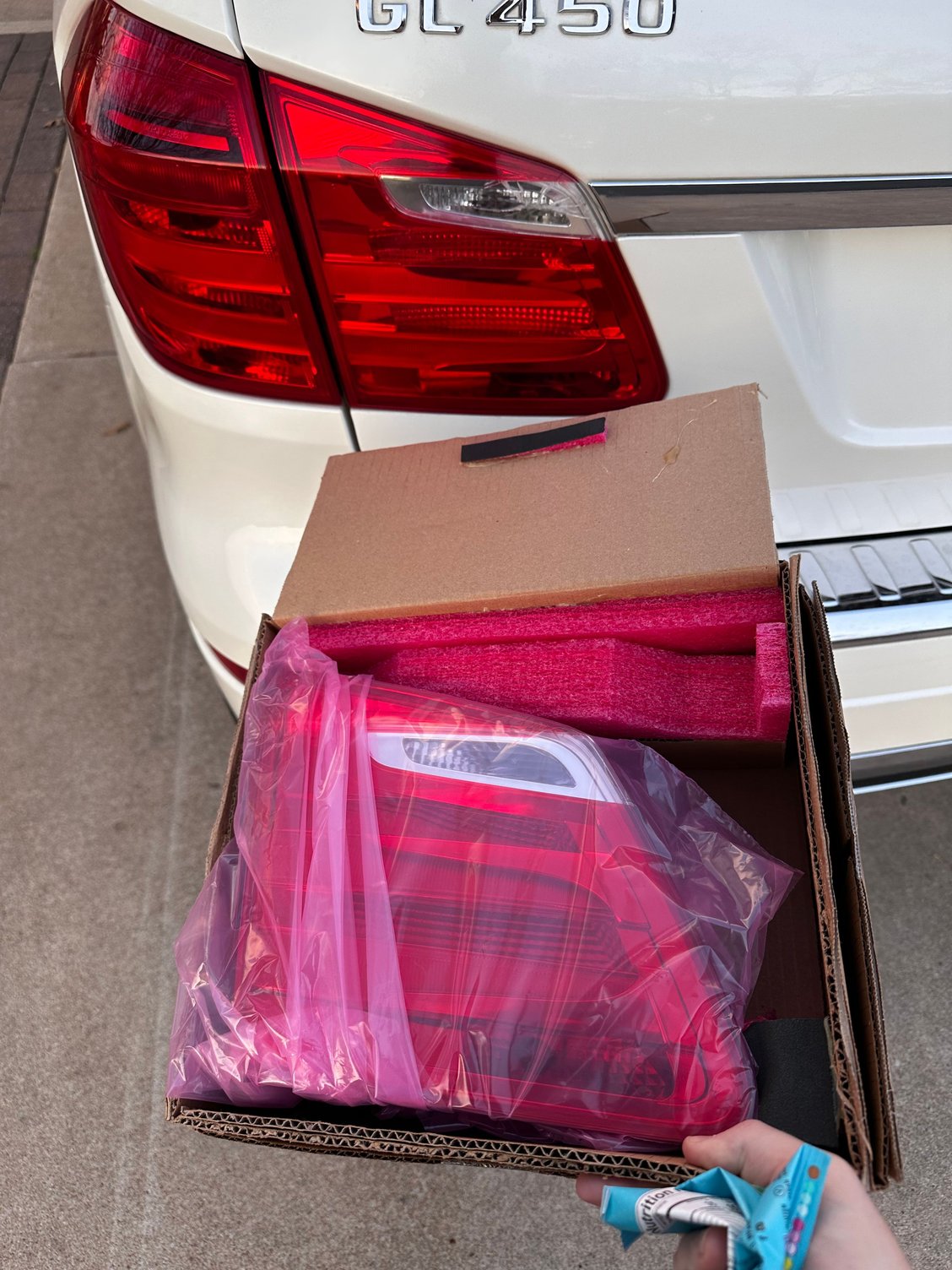

Photo attached. Any instructions on how to replace this assembly? Had trouble finding anything online for this.

Remove the rear lift gate plastic on the inside. All held on by normal plastic pop thingys and there are like 2 T20 screws by the grab handle at the bottom of I recall. Need to remove a little cover to see them. Then you will have access to the rear of the fixture and unbolt and reverse to finish.
