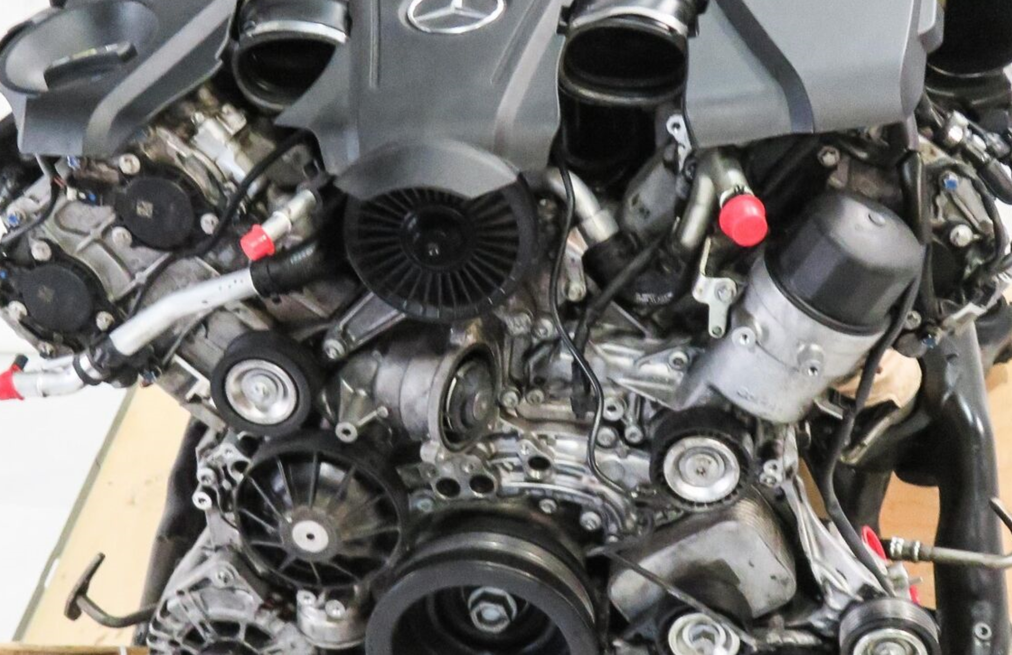

I'd like to measure oil pressure on my 14 GL550. On most engines, you'd remove the oil pressure sender and attach a gauge but on the M278 I can't find reference to oil sender unit. I haven't found oil pressure parameter in Xentry either. Does anyone know how to measure oil pressure on this engine?

There is a port on oil filter housing front

I don't see a port on the oil filter housing. Could you point to it in this picture if possible? Thanks.

The plug with hex socket to the left of the tensioner roller. Anyway what is the need for oil pressure?

Got it. I never would have guessed it. Thanks a million!
