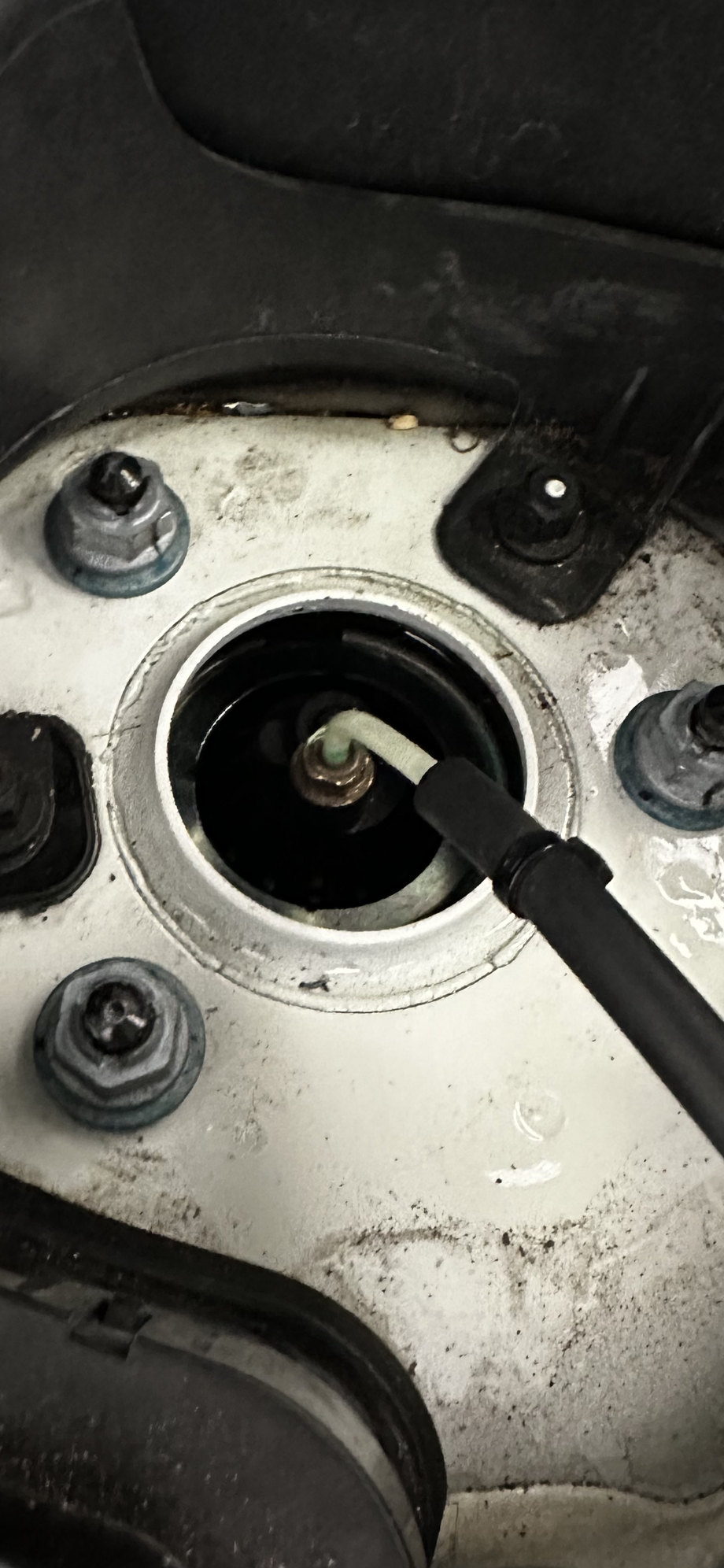

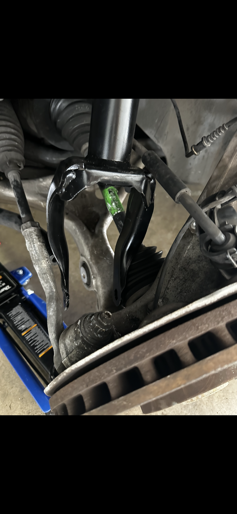

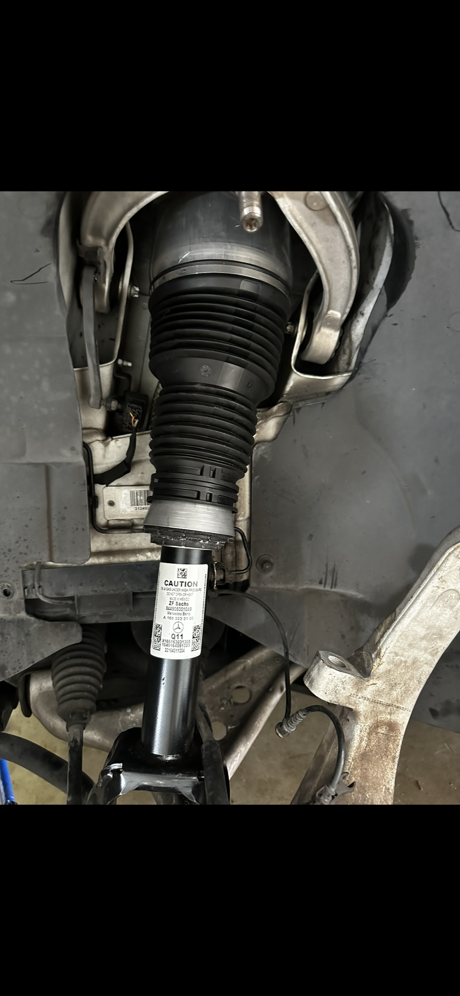

hello mercedes gl fam! I'm changing out an air suspension for a relatives as they don't want to pay 6k to the dealer. I got the old one out but I can't seem to put the new one in the same way I got the old one out with a pry bar and a jack. Is there any way to bleed out the air?

unscrew the air line connection

I disconnected the tube, what do I do next? Still cant decompress the air and get it over that axle.

Disconnect air line and try to carefully pry aluminum cone at the base of air bag from conical rubber seal to release air without damaging it. Your strut suppose to be out of pressure, unless you want to unscrew front CV shaft from wheel
