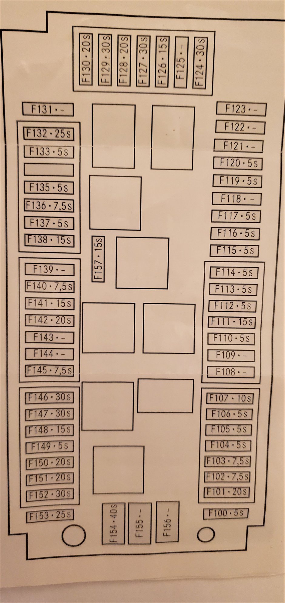

I have a 2014 and 2015 GL 450. Both vehicles run as expected, I have not had the need to replace fuses. The reason for my post is I was one of the lucky ones (2014) to have the engine go down. I want to activate my fuel pump to pump a full tank of gas out of the tank. The fuse chart for the fuse box under the second row seat clams that F132 a 25 s fuse and F112 a 5s fuse. Looking at the fuse box F132 is empty as is F112 and there is no visible second connector where the fuses are to be which means fuses were never there!? I look at the 2015 and F132 has a 20s (not 25s) and the F112 is empty. (car runs fine). The balance of the fuses that are on the chart verses the fuse list aren't even close to what the list states. Both of my lists are the same 2012-03-03 . A1660086999. How are you supposed to figure out what is going on?
Anyway, how do I power the the fuel pump to pump the gas out. How do we get an accurate fuse chart including identification of the modules? The fuse box pictured is form the 2014. Anybody want to buy the 2014?

You're looking at the map upside down. In the picture you posted the 25A and 5A fuse are in the correct positions.
