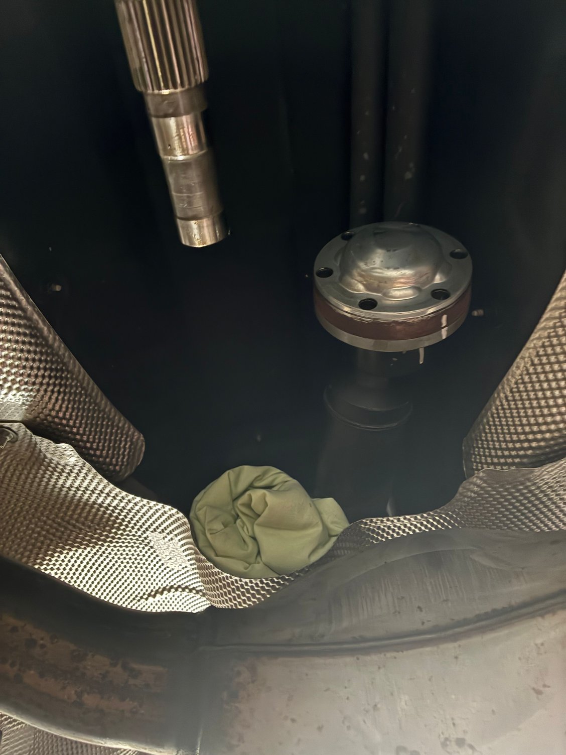

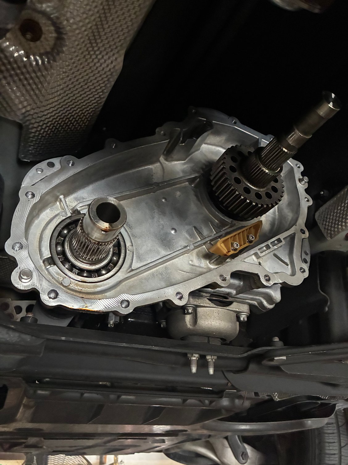

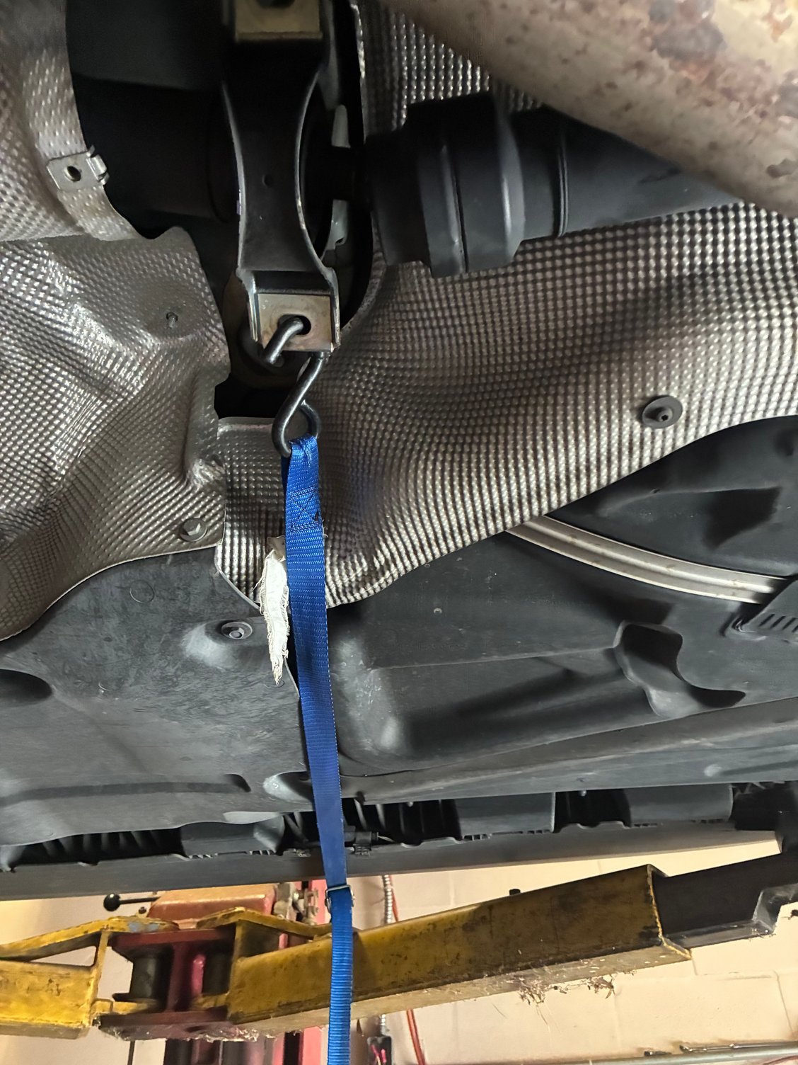

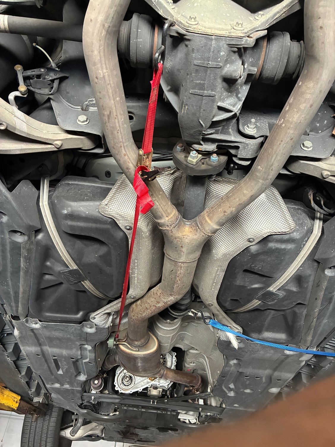

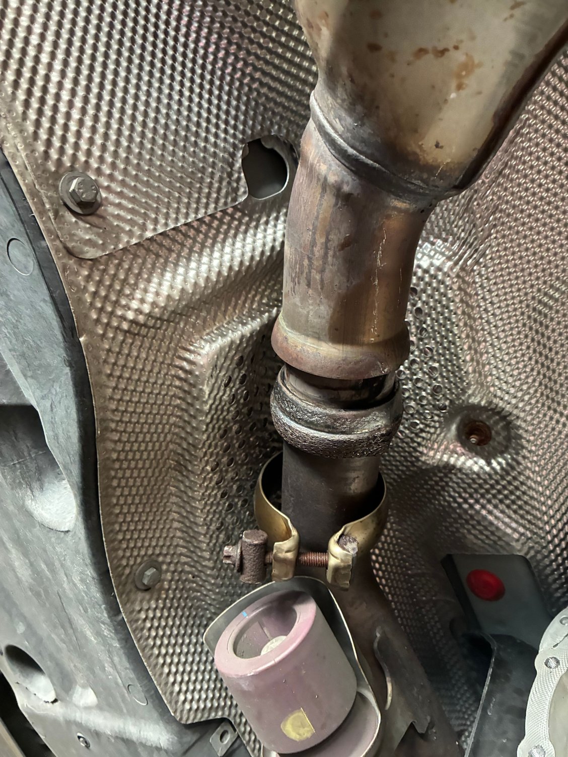

I’m replacing the chain in our transfer case. 2015 GL450 4matic. Here are some things I did to make enough space to remove and replace the cover. Somehow I removed it before making more space. No way was it going back cleanly. Now I can slide it in place with ease.
