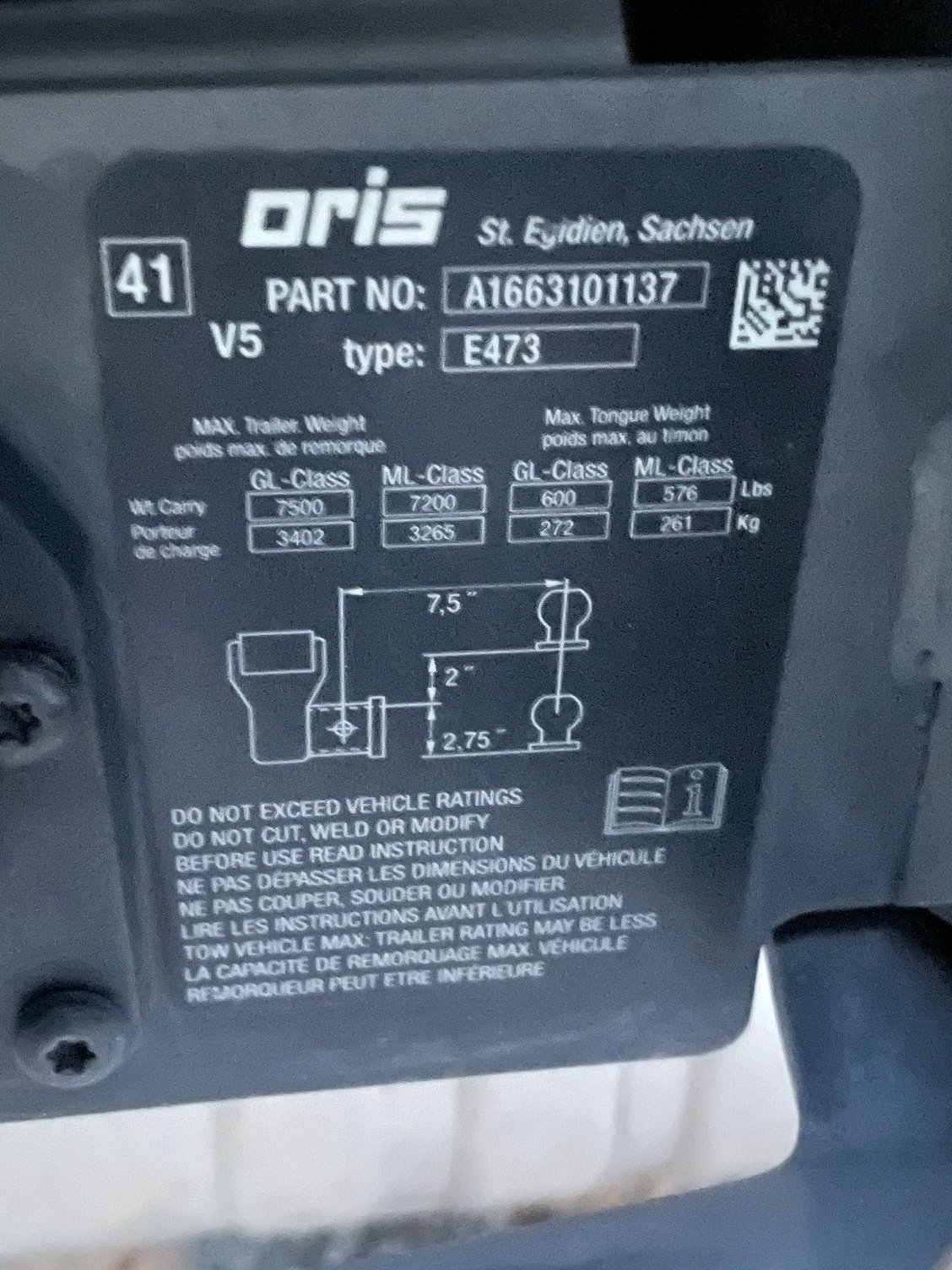

I responded to this in another thread, but I have a 2015 GL63 AMG and the plate on my hitch
says 600 lb tongue weight. The same for all GL’s. Could this be a translation error?

Thank you. Yes, I created this duplicate thread because I had forgotten that I created the other thread a while ago. I spoke to Andy at Can-Am and to Mercedes-Benz. There is physically zero difference between the GL 63 and the GL550 with respect to anything that would affect towing. The difference lies in the speed rating for the vehicle and some of the silly European laws. Set up properly, as any vehicle should be, especially with air suspension, this SUV should out-tow anything in its class, and certainly at least as much as it's GL550, GL450, GL350 siblings.

Two differences in Euro vs US and in 63 vs 550:
- 63 has a rear biased transfer case and 550 has 50/50.
- Euro uses 8% of trailer weight = tongue weight, US uses 10%.
I would ignore the differences and use 10% tongue weight as a max. The W166 platform is a top notch towing platform. Tow with confidence.

That's exactly our issue at hand. The manufacturer specs the GL63 at 309lb tongue weight vs GL550 at over 600lbs. I am questioning the validity and reasoning because I want to tow a trailer with a 450lb tongue weight. If I go by the manual, I may as well forget towing anything but a 22ft bowrider or a 19ft ultralight camper. So....boohoo for me (laughing at myself, not you) if that's the reality. However, from responses I've seen here and responses I've gotten from Can Am who's dealt with a number of AMGs, the GL63 should handle the higher tongue with a well-set-up weight distributing hitch. I.e. don't just chuck that f*cker on and drive away.
