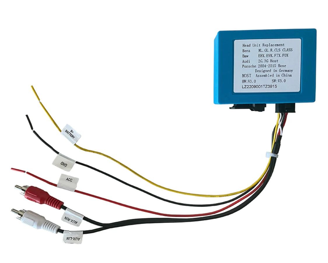

But since the Command System is not working I having to find alternate ways to get some of the functionality of the Aftermarket Screen. I have been able to get sound from the Original Speakers by using an aftermarket apm and running wires to the speakers. I am going to try out using an Optical Decoder like the picture below to get sound out using the Harman Kardon Amplifier.
Optical Decoder

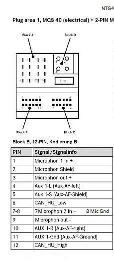

Here is the pin out digram for my Head Unit harness.
Pin out diagram.
So here it shows Microphone In, Out and Grounding pins for 2 microphones.
I am trying to make sense on how to hardwire both microphones to the single 3.5mm jack. (Even if that is possible)
Alternatively was thinking that since the After Market screen piggy backs off of the original harness and doesn't need the 3.5mm microphone if the Command Unit is working. Creating a loop from the Mic In + and Mic out - and providing ground would get the Original Microphones working with the aftermarket screen.
