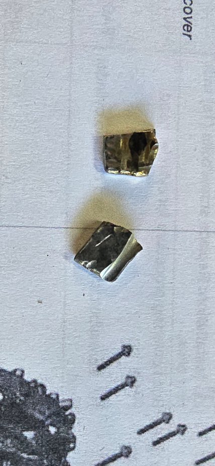

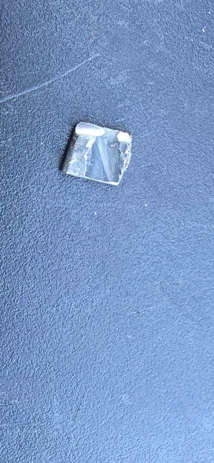

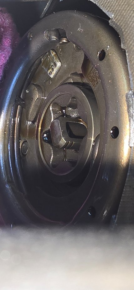

Due to a small leak, I was doing a head cover reseal on my GL63. I had proceeded to remove the driver's side timing chain cover and as I looked in, I noticed the 2 small aluminum pieces inside the cam adjuster. The timing chain cover has never been remoived and as far as I know, the solenoids have never been off either. I don't know how they got there or what part of the motor they came from. They are a bit worn and they didn't cause any issues to the motor. I feel I had got lucky as they never went into other parts of the motor to be able to cause any damage.
