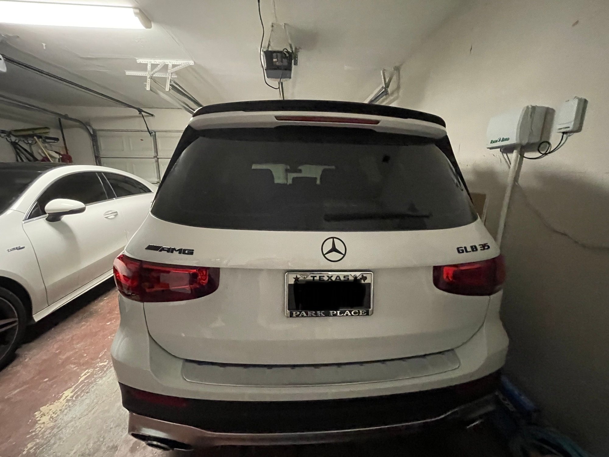

Check eBay for the emblems, I blacked out my badges on my GLB 35. Use a heat gun or hair dryer to heat up the emblems and remove them with floss. I used a plastic razor to remove the adhesive and cleaned it up with de-solv-it.

Those look cool and enhance a very stark contrast on the light colored car , good job
