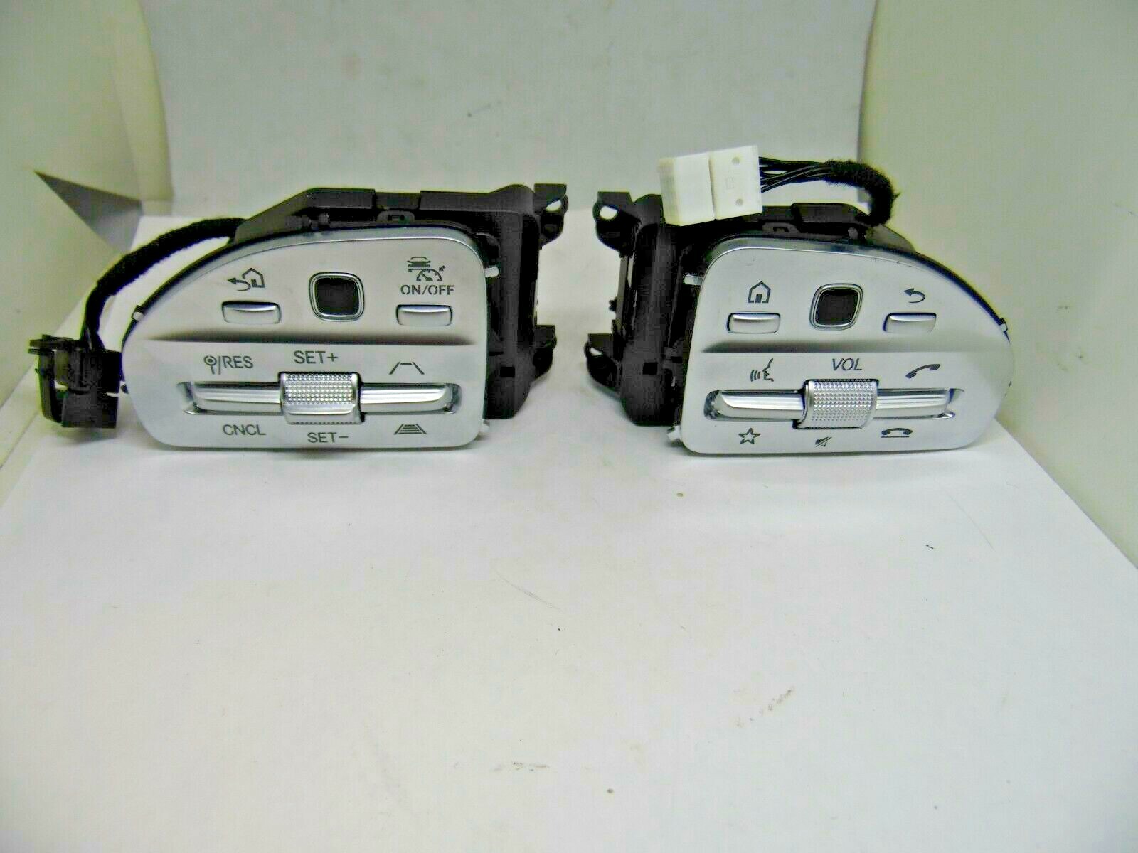

If you steering wheel's multi function switch has a button to set distance to car in front (like picture below), you have active cruise control, if not you would have to swap the switches first prior to coding.
