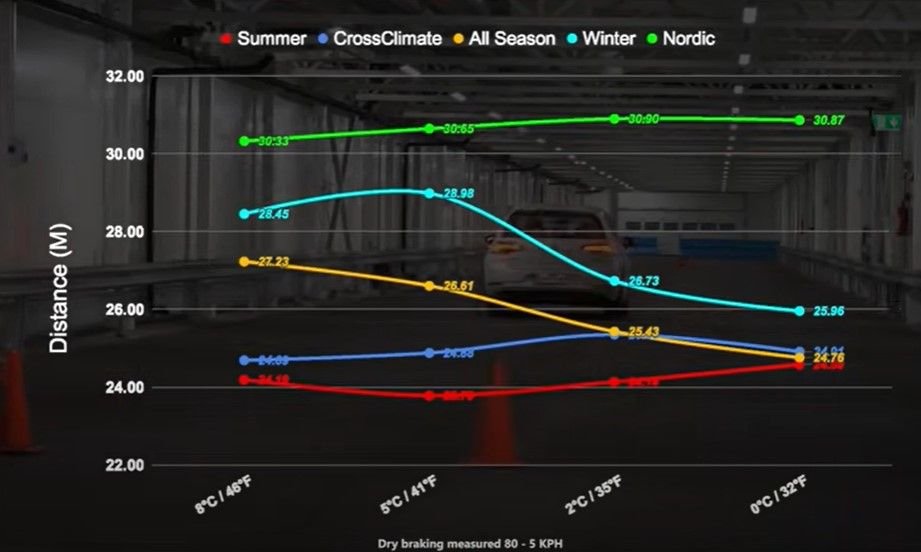

Only tire performance test vs temperature that I found is below shows good brake performance of Conti 6 summer tires on cold dry pavement, but getting worse braking distance on wet pavement under 54F. Cross Climate tire is Michelin and All Season/Winter tires are Conti:

Below is updated tyre review test from last year with CrossClimate all weather / all season tire with 3 peak mountain and snowflake (3PMSF) symbol to meet a snow traction requirement of a winter / snow tire. PS 4 A/S UHP is great for dry and wet, but CrossClimate A/S is great for snow and ice in winter. No tire is perfect, so choose your compromises... PS4 A/S slides easily on ice in comparison to Alpin 5 winters. CrossClimates are closer to Alpin 5 winter performance, but lags on wet braking compared to Alpin 5 and dry/wet compared to PS4 A/S...
Results are similar to tiretrack winter test, which is missing the winter tire:
https://www.tirerack.com/tires/tests...r.jsp?ttid=270
Tiretrack tests are done in the same track loop, so putting the stopping distances with same car gives a good comparison:
